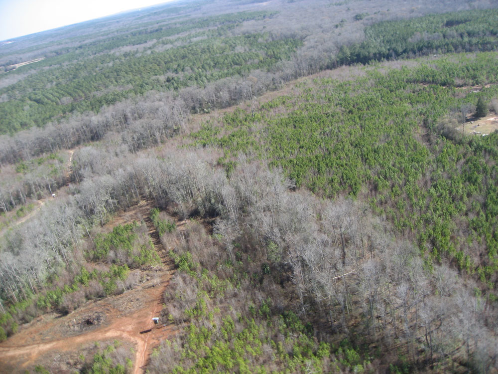

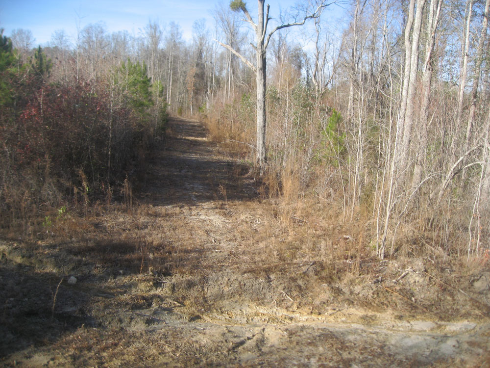

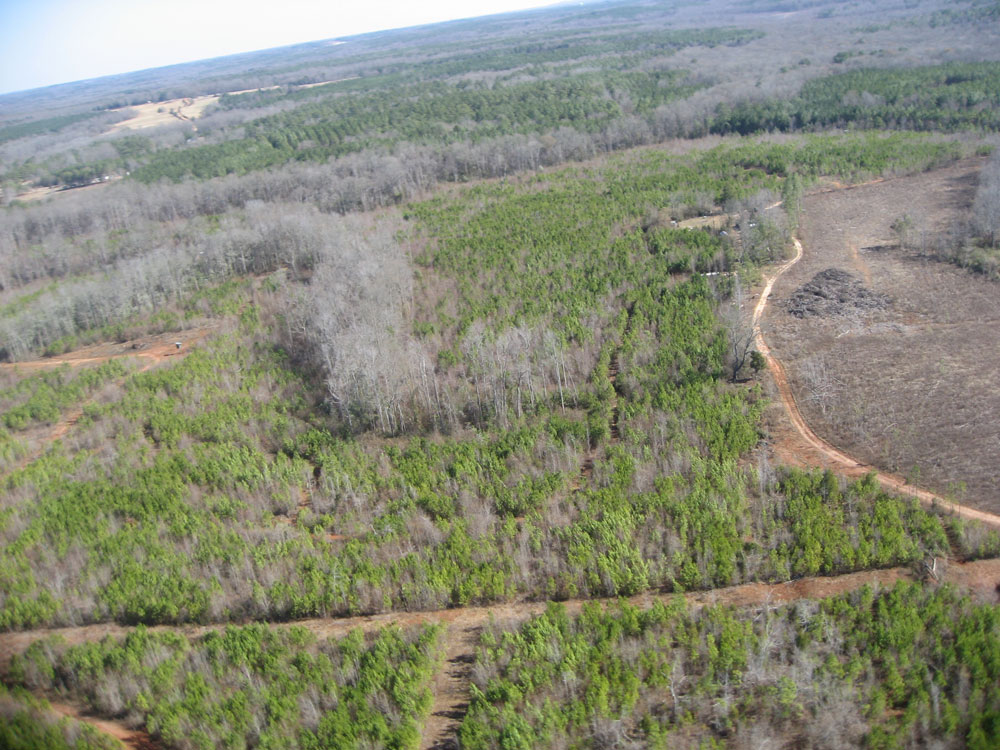

OK I finally made it back to my farm. I have a standard flow unit. No high flow sticker and the high flow button light does not stay on. Trees are Loblolly pine and the ones I want to thin out are around 2-3 inch size. I want to keep the bigger ones. I'm going to try and attach a few pictures also to give you an idea of how dense they are. I also meant to state I had around 2000 trees per acre not 3000 as I previously posted.

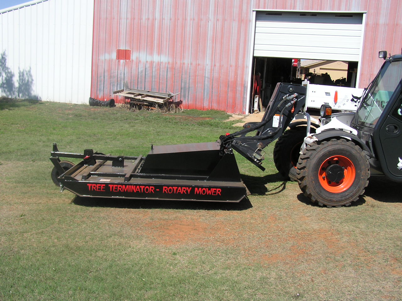

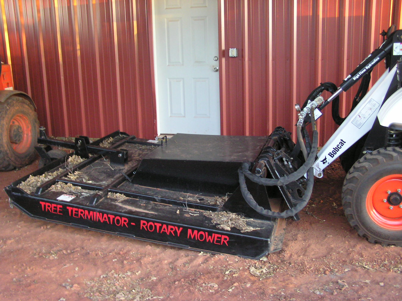

Get the thickest SSQA mounting plate and hinge it at the top to your 3 point frame, like this:
It works great out front, 7' wide, it weighs 1800 pounds, cuts up to 4" trees and is low flow.
You might have to post in the Hydraulics forum to find the right hydraulic motor.

Thanks for the suggestion Xfaxman. Nice setup you have there.
   / Anyone know of a Forestry mulcher that will fit an S250? #9
Thank you. I am lucky to be retired and have all the equipment needed to do what I need to do.
