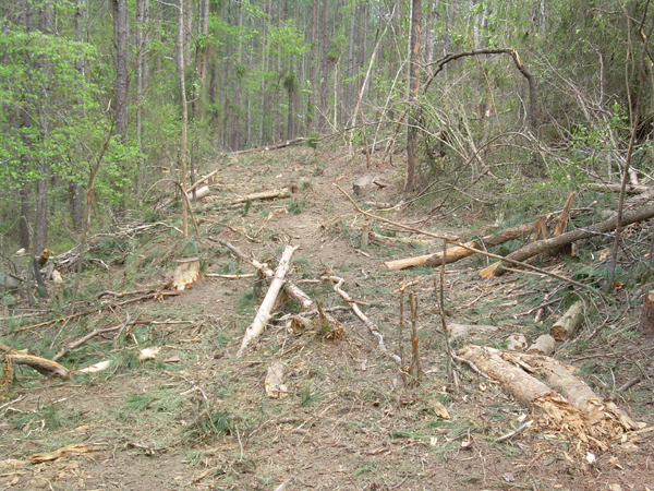

The stumps range all over the place it is pine timber land. I would like a BH but everyone has told me that the BH on a L3400 would not do me much good for stumps. I can use it to trench for water and electrical but once most of that is done the BH may be very underused. A local rental shop has a 3400 with a BH for rent at $240 a day, I think for my trenching that may be a worthwhile option.
Here are a couple of shots to give you an idea of the stumps. The photo does make those pulled up stumps look smaller than what they are. The one photo was after my grading guy finished. He did about 1.5 acres of de-stumping and grading as you can see for $1500 with his dozer, still has a bit of cleanup to do this week. It would be impossible to have him clean up all of my logging trails at that cost. The bottom photo is typical of my trails and I got about 2-3 miles worth zig zaging the 27 acres. This shot is a bit more narrow than most trails and I can sometimes walk most portions by leap frogging from one stump to another.
My thought would be to grind the large ones, cut the small ones then chop the end and drench in round up, later on possibly drill and fill with some sulfur based product to speed up the rotting. Burning would be close to impossible since there are so many along the trails. If I can get them low enough where the soil will not compact and re-expose the stump I would be happy. Grinding and filling with dirt then planting seed is my primary plan. Firebreak for the home and a natural trail for all the deer.

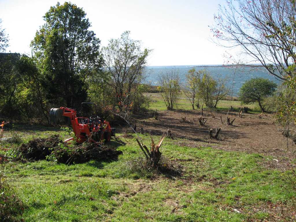

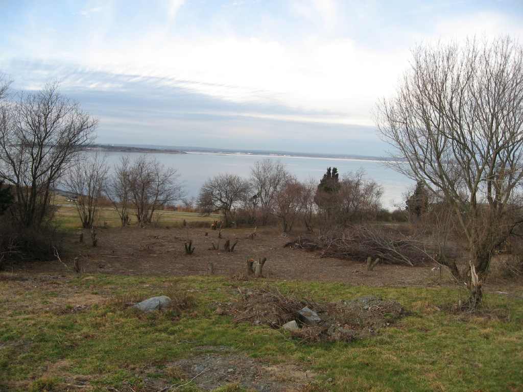

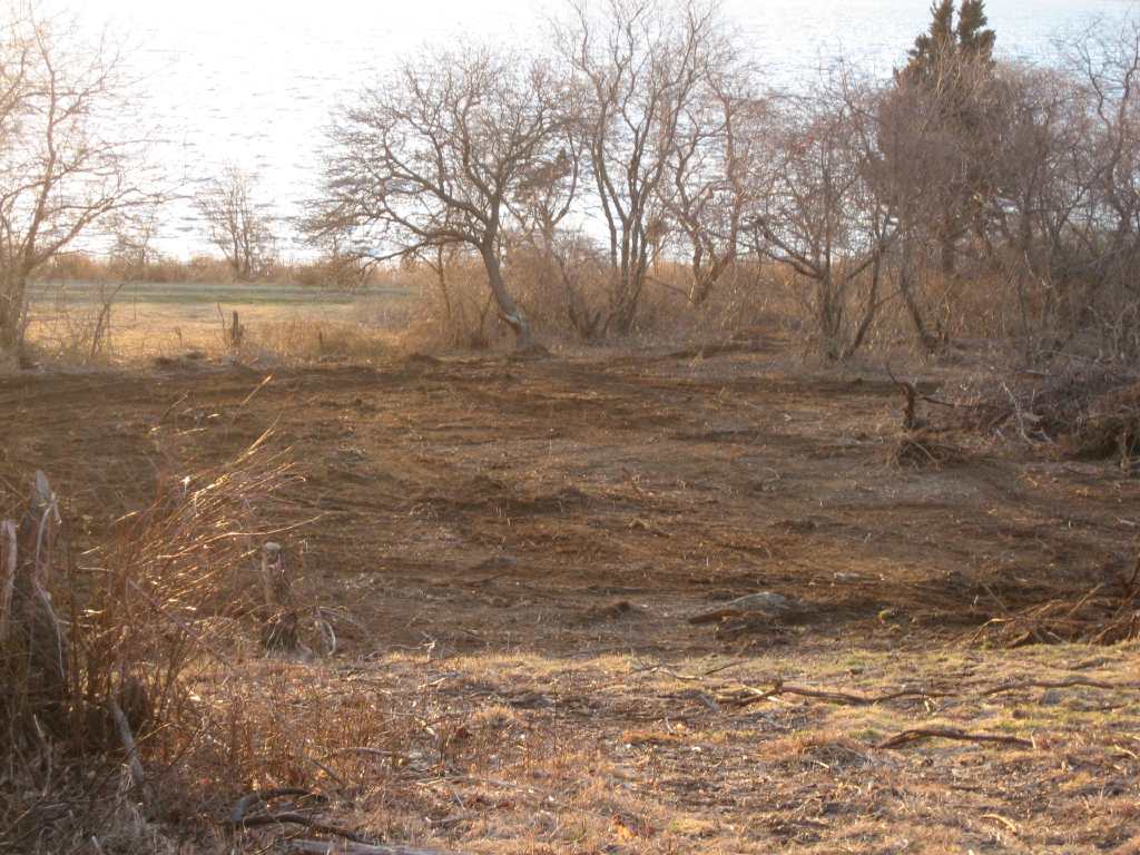

This is what a 21hp tractor and 6.5ft backhoe can pull out of the ground. These were all pulled out in a long afternoon. Soil was rather sandy which helped and the stumps did not have long tap roots but still, I think you can see that a TLB can get quite a lot done in the stump pulling arena.
