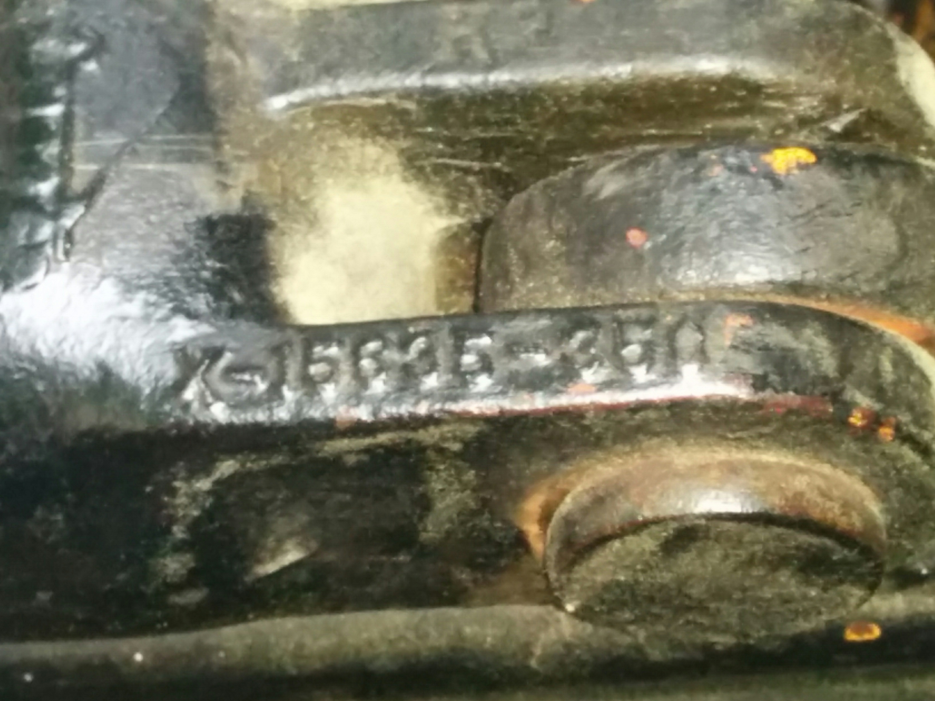

need the bottom nut IMG_20200611_151609.jpg anyone know where to find?

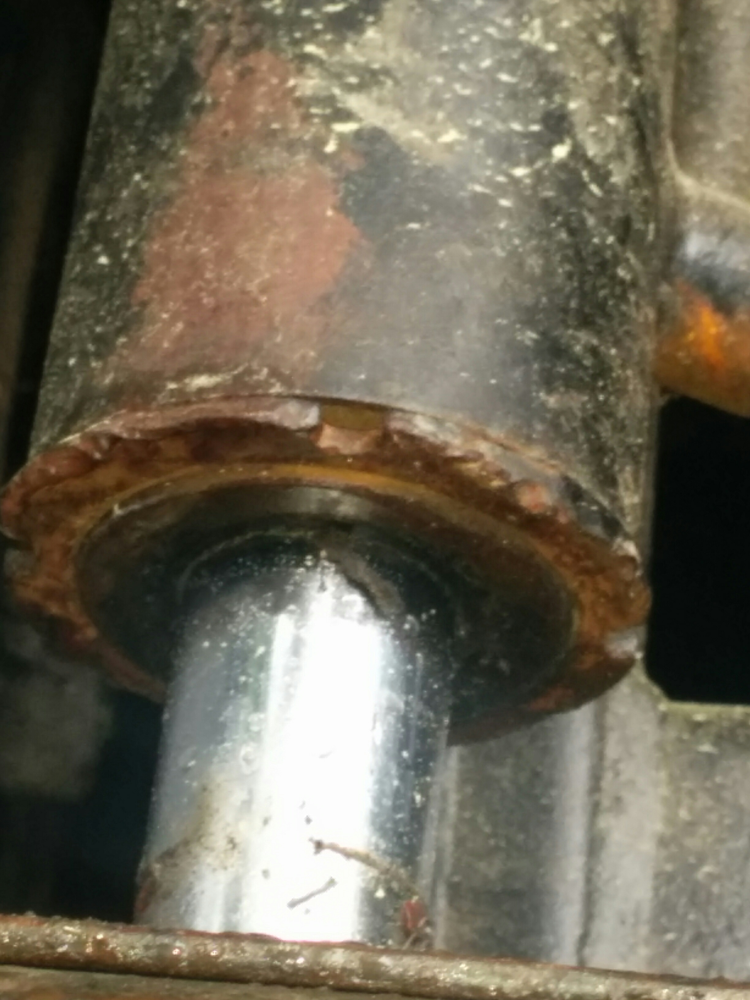

need the bottom nut View attachment 659345 anyone know where to find?
I would back it out and get a thread count , diameter and length. All dimensions.
It may be impossible to get unless its some standard part.
Massey Ferguson may have just ordered standard size cylinder to fit the need. I would look for a manufacturer's name stamped on it.
I see Edge damage but if the threads and seating and sealing surfaces are ok maybe clean that outer edge up. The spanner notches look fair.
I did a general search for hydraulic cylinder nuts. There are companies that will make you one. I'm sure not cheap.
It could be a standard part

I could be wrong but finding it as a Massey Ferguson specific part may not work. I hope I'm wrong. Did you check for a Agco part number?
You may be able to match size and stroke and get a new cylinder easier. Is it the single or two cylinder dump bucket?

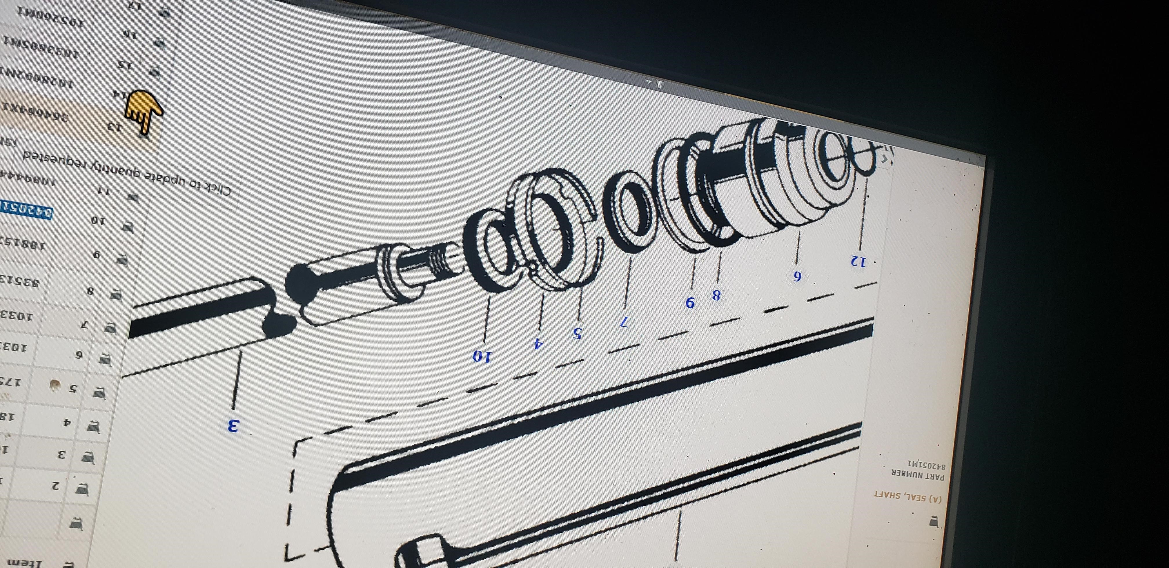

The agco parts book shows a list of many 200 loaders. Some have letters in front. The photo is the 200 without any letters.
The two part numbers are number 4 and number 10 in the photo.
To open the agco part book in the link go to[ guest user/open book].
Then type[200 loader] and you will get a list.
Welcome to AGCO Parts Books
842051M1
part number
Hits on above part number
84251m1 - Bing
1881534M1 part number
Google this one
Verify part numbers in the agco parts book

Hi thanks for the help. The dump cylinders are working fine no leaks. Just one side is missing that retaining nut, I did not notice it missing when i purchased the tractor. I will see if I can find one.
