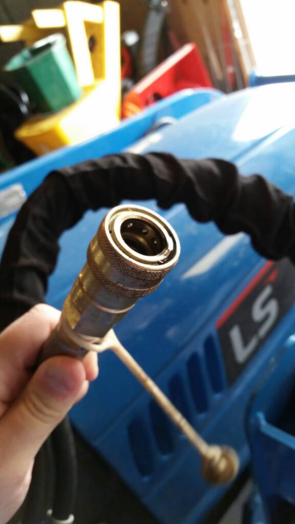

So I need a hydraulic coupler that will fit my tractor. It looks like this...

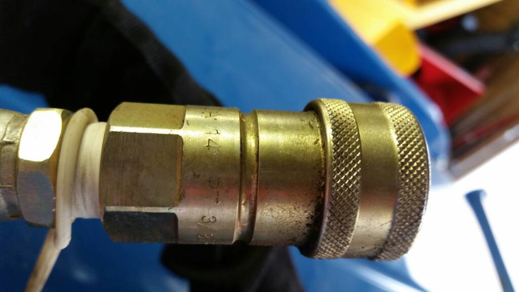

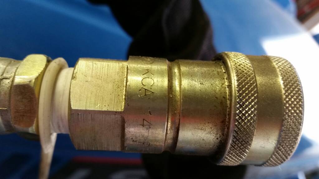

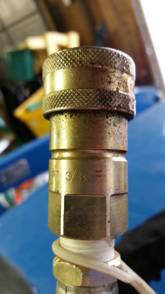

Here are some close ups of the markings.
As best as I can tell, it's a 3/8-14 PT fitting... Which is weird, because every 3/8 fitting I find is 3/8-18 NPT.
Does anyone know much about these that can help me find a replacement that really is the same?

Google turned up these folks. They look like they know their LS stuff.

They are listed in the parts manual in SimS link available through LS.
Look at the parts manual section in the previous link below to see which or all fittings you may need.
Here's the items and part numbers from those pages. 1/2" fittings are also on the page.
Section G827S01-1
25 #40233020 QUICK ASSY-COUPLER_3/8-G827 2 2009-11-16
26 #40009174 ADAPTOR-TRG827 PT1/2 - PT3/8 1 2006-11-30
27 #40233022 COUPLER-QUICK(3/8)-TRG827 3/8 INCH 1 2009-11-16
28 #40233025 CAP-COUPLER(3/8_G)-TRG827 GREEN 2 2009-11-16
