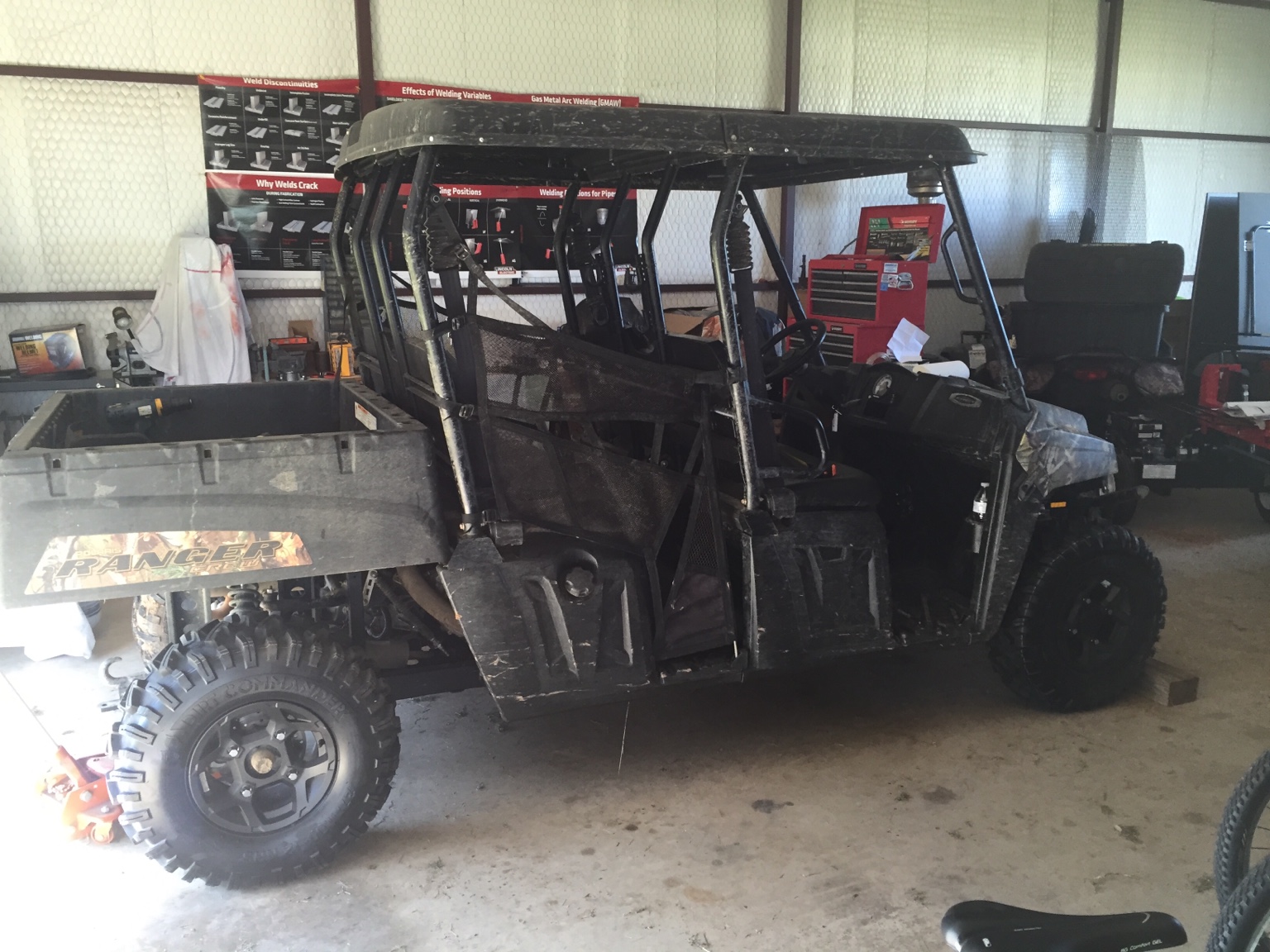

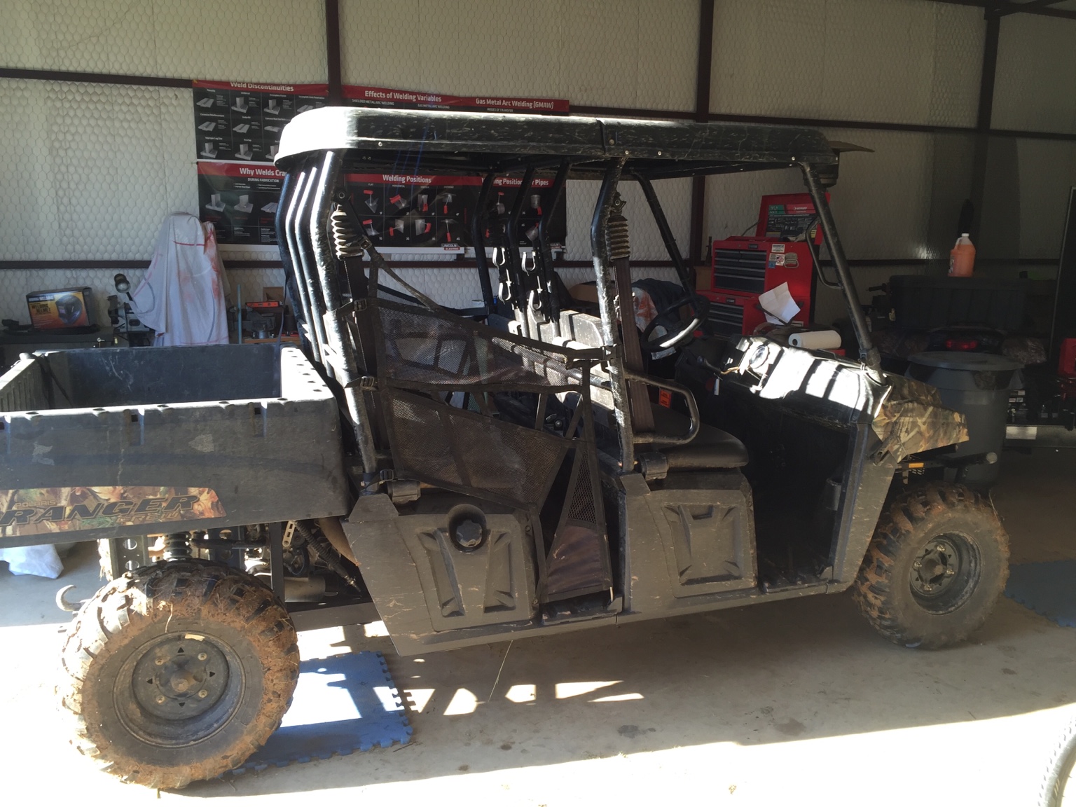

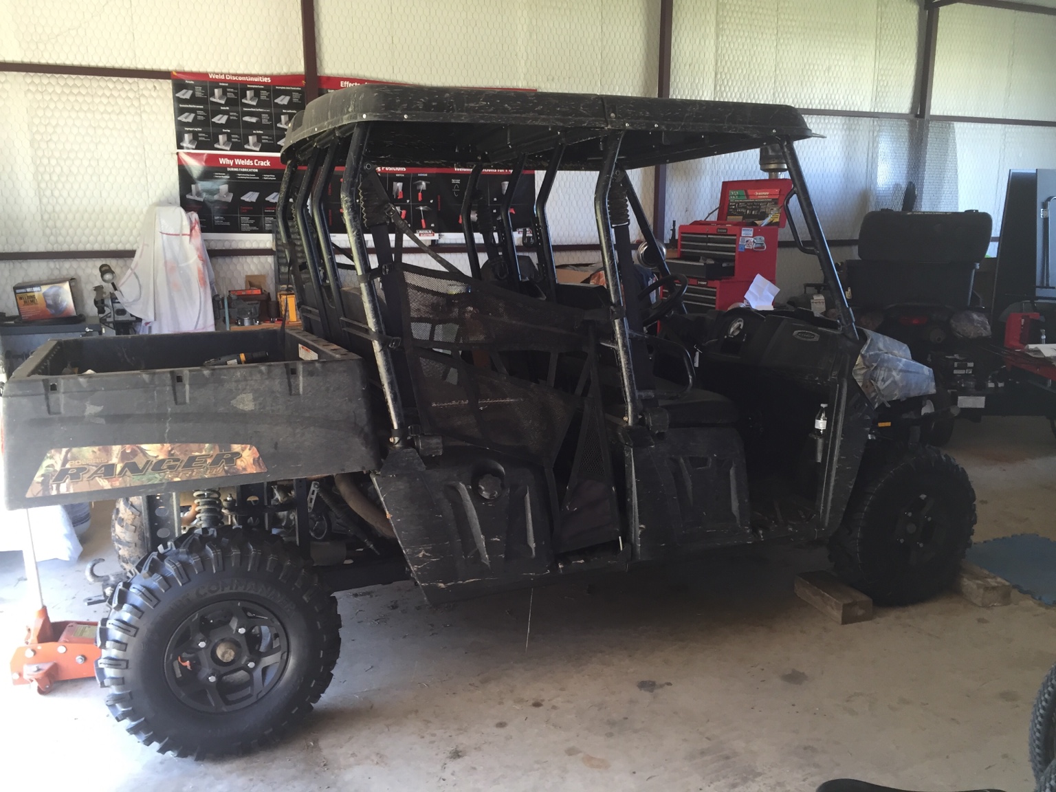

No replies so I just went with it.
Bought a simple 2" lift off eBay for about $45 and got some Polaris rzr take offs for $400 never been used, fancier wheels and 27" (vs original 25").
I shouldn't drag anymore
Stock 25"
With 27", no lift
With new tires and lift.
Still need to address the fact that original setup is hub centric with 3/8 studs. New rims are lug centric with 12mm studs and the front are too close to swaybar link so will get some 1" spacers to fix all of it this week.
Overall love the stance, added ground clearance and can't wait to get it out!

Mine is a 2013 500 crew. It's the narrow one.
Piece of cake to install. Maybe an hour..
