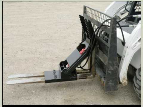

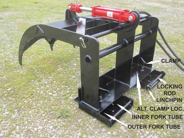

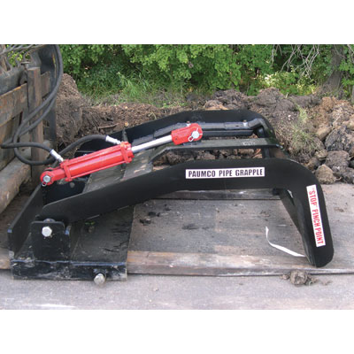

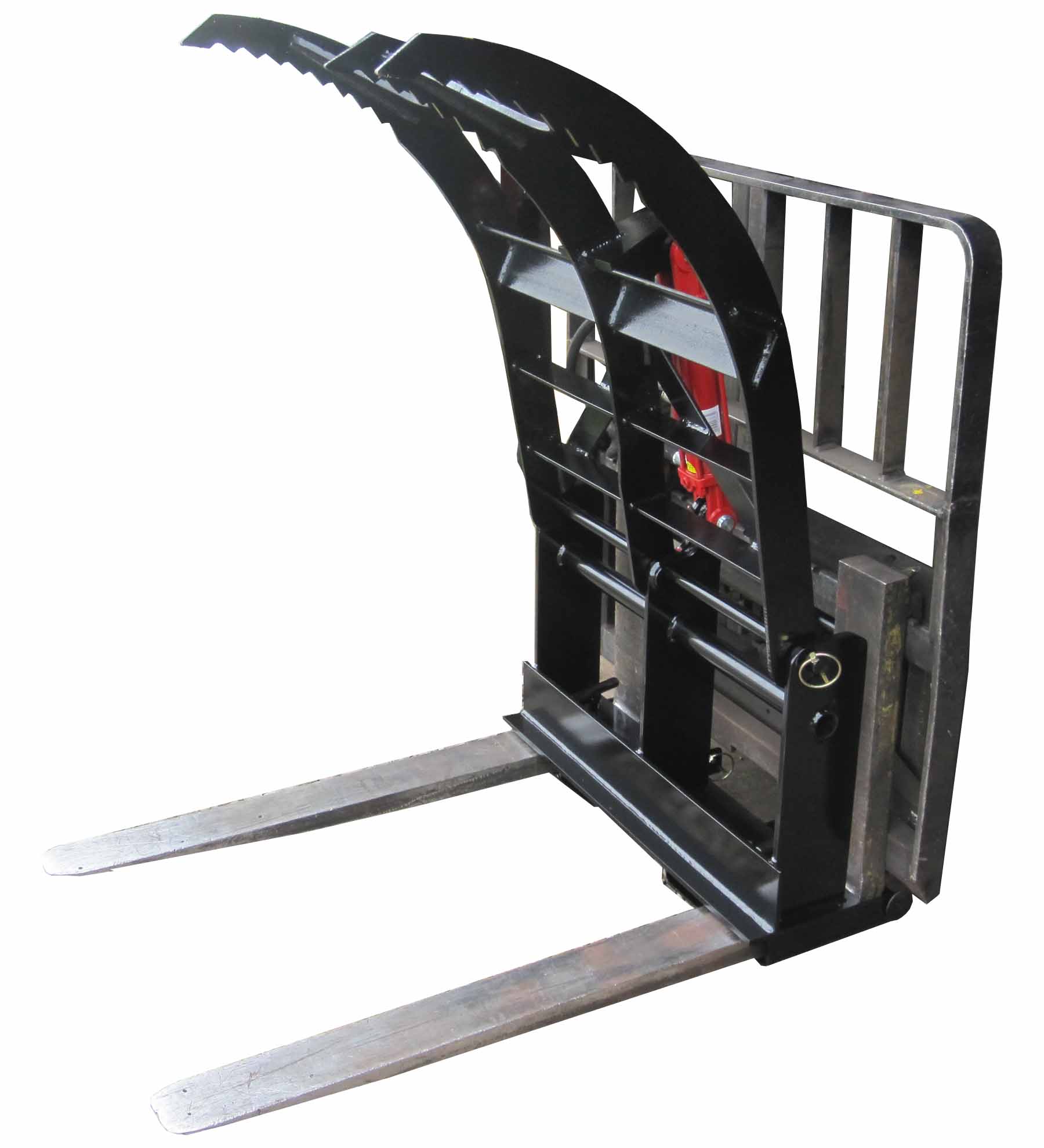

Pallet forks don't get much use and to me seems like they would work better than using the bucket. Any ideas on designs?
   / Anyone make a grapple out of power tracs fixed pallet forks? #2
It would be a simple and not too grapply, but I have seen it done with other tractors. I personally prefer more tines and I think you will to. I would rather put a grapple on a bucket.

   / Anyone make a grapple out of power tracs fixed pallet forks? #3

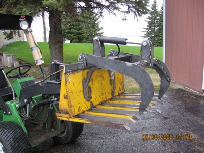

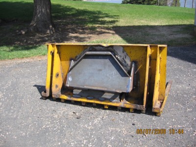

I had a local welder build a quick attach plate and the grapple. I used the hydraulic cylinder from my snow blade. I attached it to an old set of manure forks from another small tractor. The grapple on my fork is heavier than I like. Another option would be to attach it to the large bucket or the pallet forks would work for large stuff.

DHS thanks for the pics. I am thinking something semi-permanent for my pallet forks. Most of the time they just sit there so if I can utilize them for another purpose that would work for me. I like the bucket grapple idea but I use my bucket a lot for other things and I can just see the small trees and limbs just flopping around in there. DHS I hope you don't mind but I might use some of your ideas on my little project.
   / Anyone make a grapple out of power tracs fixed pallet forks? #8
I used others ideas when I had mine built. My local welder built mine for about $150. It is easily removed with a couple bolts. I have tines on mine for sifting and removing large rocks from my beach. This is the url of what you might be looking for. Looks very much like mine. I have pallet forks and the top of the quick attach plate is not very wide and will require beefing up to attach the grapple but it should work fine.
