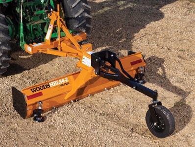

Living on a gravel drive and road ya'll understand what it's like to plow snow and try not to take half your gravel with you. My driveway and road ain't exactly flat. Sometimes I scalp and other times I'll leave 4 inches of snow. I like the setup on the landscape rakes but not sure if they make them for a straight blade.

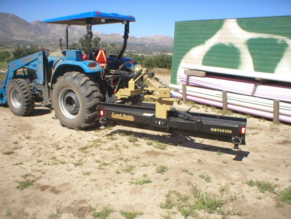

Skid shoes should help if not take care of the problem altogether. ;)

I bought mine from Leinbach some time ago. But I think EA sells them now. They're listed for $397.

Yes, gauge wheels help!!
Buy a set of gauge wheels for a landscape rake, put them on a rear blade.

Most use a single tail wheel on rear blades, but no reason you couldn’t use a double set up. You would more than likely have to fab your own mounts.

Brother - do I know exactly what GrumpyJoe is talking about. When I had my lighter(566#) rear blade - at times I could get away with plowing my mile long gravel driveway BEFORE it froze up hard and not scalp ALL the gravel into the ditches.
However - now with my new Rhino @ 1050# - easy times are not gonna happen. I either wait for things to freeze solid or reverse the rear blade and drive forward.
I've tried skid shoes on the Rhino - does not solve the problem in my situation. Maybe some type of "wheel pack" would. Reversing the rear blade is so much easier, cheaper and it DOES work.
