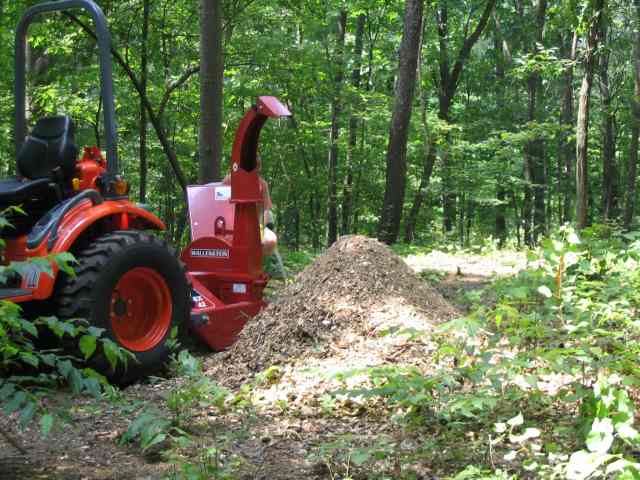

I've had the chipper for 2 years. Happy with it. Use it mostly for soft woods in the 3 to 4 inch range occasionally a 5 to 6 inch. Hardwood branches are no problem. Rotted wood birch etc. are the hardest to chip. The unit tends to grab into the log and the B3030 does not have the hp to "swallow" it. I have adjusted the chip width to deal with this. Feeding is not a problem.
Easy to sharpen. Remove one bolt and the top is hinged and swings open. Care in feeding green along with dry branches and the unit does not seem to need to be sharpened frequently. Blades can be reversed to double the time between sharpening. Not sure of the weight but not a problem on this tractor. I think I paid around 2300 or 2400 for the unit when I bought the tractor. They ship with the unit painted the standard orange, blue or green color to match the tractor. Hydraulic feed was substantially more. Dealer convienced me I didn't need it. I have about 35 to 40 hours on the chipper.

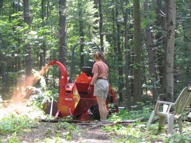

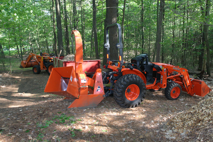

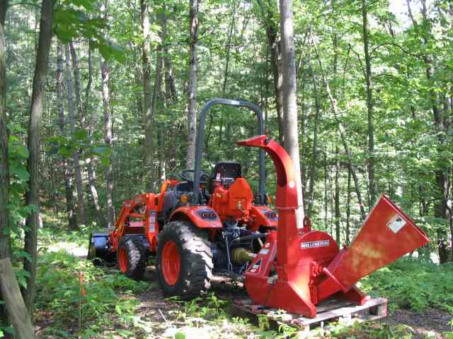

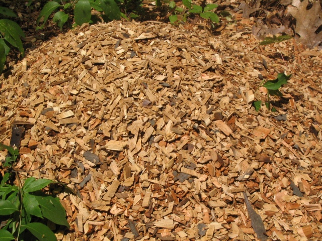

I own a Wallenstein BX42 which is the next smaller size chipper (up to 4" diameter). No hydraulics. It weighs about 400lbs and the flywheel alone is 135lbs with four reversible blades. The flywheel is one of the heavier ones I've come across in this size chipper. It has chipped everything I've thrown at it, including hickory and oak. It has no problem with green wood that is covered with leaves or pine needles or with dry, aged hardwoods.
One feature I like is the adjustable strike plate. The knives are set in a fixed position on the flywheel. To adjust the depth of cut, there is a strike plate that can be easily adjusted from the outside of the chipper.
On a few rare occasions, I have stalled out the tractor if a thick piece of wood gets wedged against the blade. When that happens, I check the depth of cut and set it a little more shallow. Bear in mind that I have a 20HP tractor. I don't know anything about the TC45D or JD4110 but I'm guessing these are in the 40+ HP range. I doubt you'll bog them down with a 6" chipper.
Before the Wallenstein, I had a 9HP DR Chipper and it is a mere toy compared to the BX42. These things are beasts! :D
Almost forgot the most important part! :eek: I paid $1,995 for the BX42. Worth every penny! As you can see, even my wife likes to use it.
