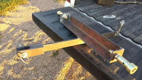

Thank for replying Greg. Hearing your use cases I have some confirmation that traction should not be a big issue especially since my soil is not terribly hard. I am going to build a subsoiler to pull some cables underground around the place and was just curious about other K2 owner experiences. I don't really have many roots but one thing I thought was to sharpen the front of the shank/bar to try and cut the roots as it goes. I see most of the 3pt commercial ones have a flat face. Anyway, thanks for the input.

Well here is what I have built so far. Will probably need to do some reinforcement braces, but close to being done. Everything except the pins and quick attach ears built from scrap material I had lying around. Hope to finish under $30.

Looks good Marty. You shouldn't have any problems with pulling it. Make sure you've gotten a good bead/reinforcements on the side attached to the ripper bar; the way it's designed it'll be straining against the weld and might want to pop loose. But, probably won't. Greg

Got a little more welding done and hooked it up tonight for a test run since we got some rain lately. Sunk down to about 12 inches right away and pulled with ease leaving only a minimal amount of damage. Looking good so far. With do some more welding and give it a better test run soon.
