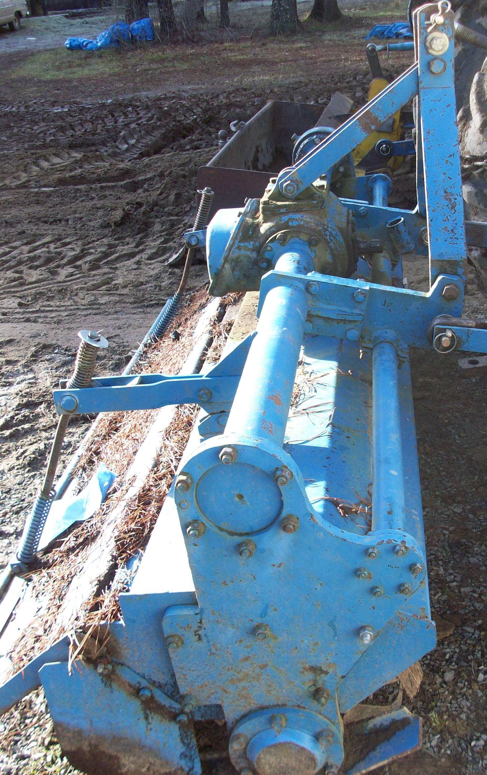

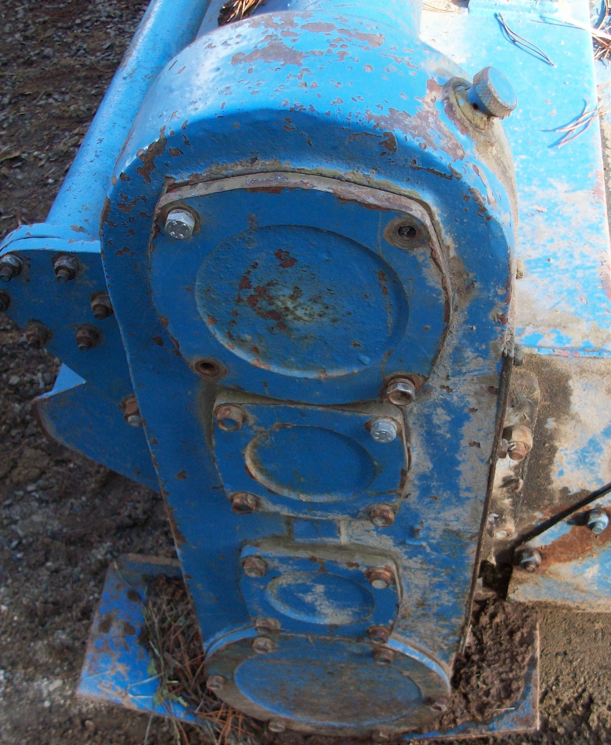

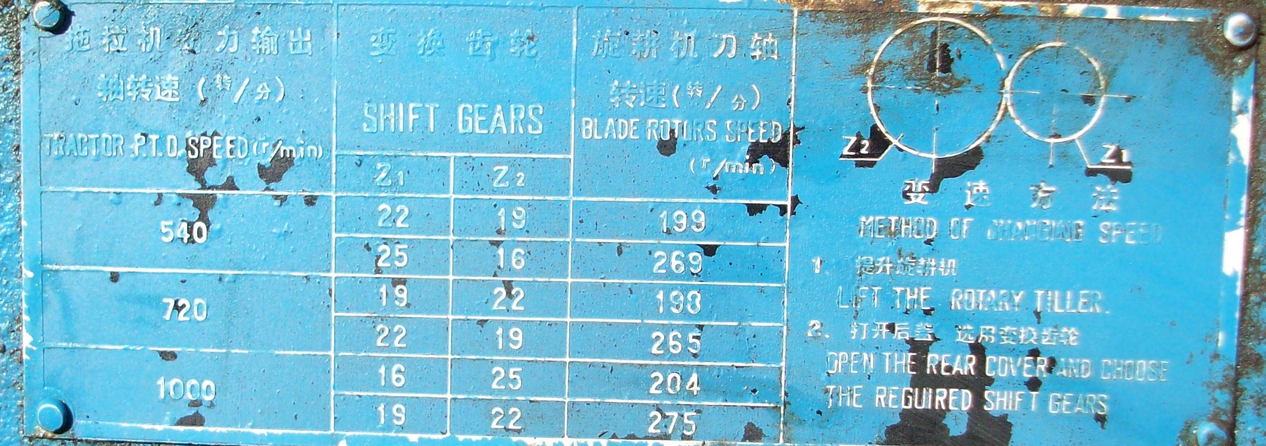

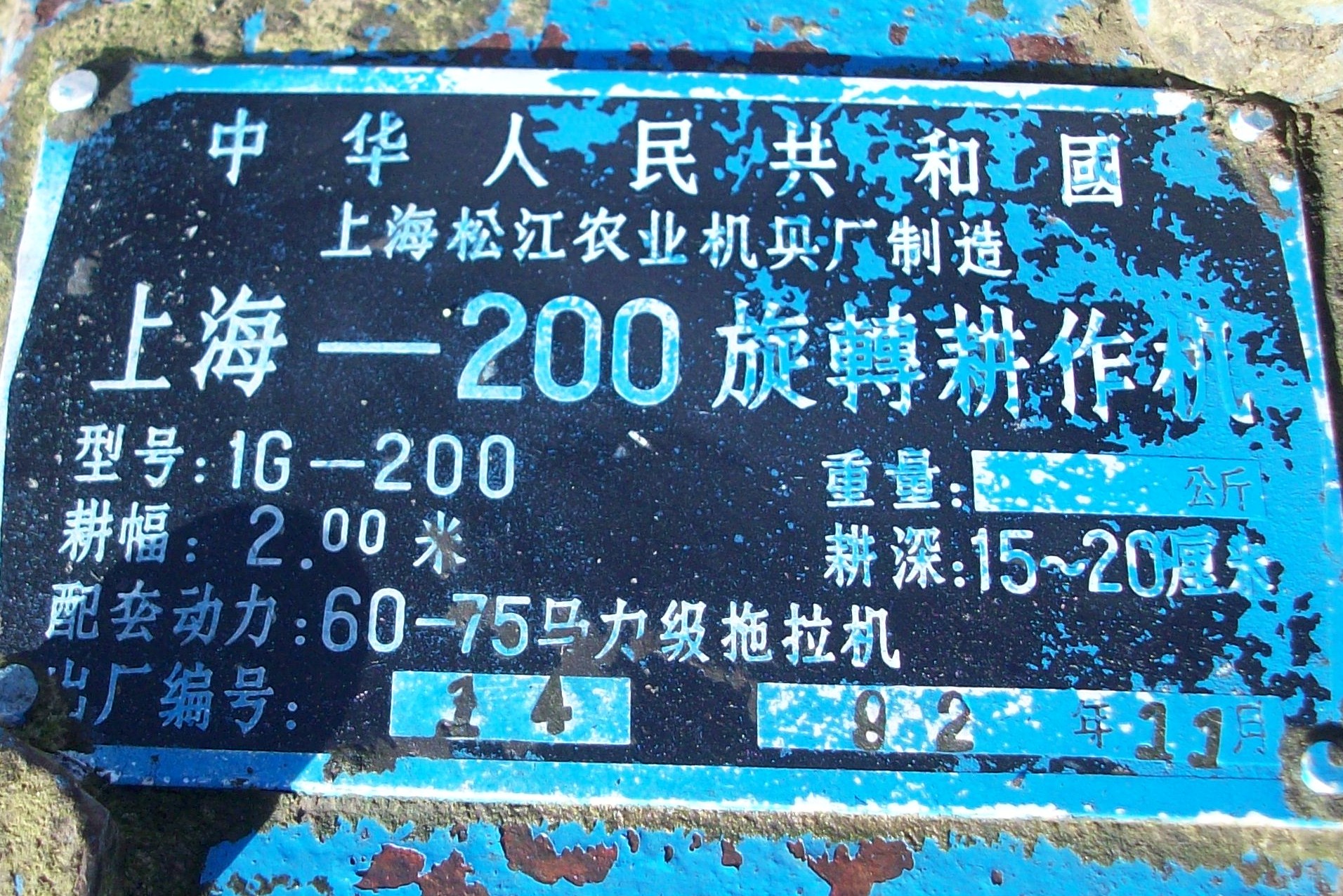

This tiller was purchased new in 1993 at the same time the tractor, a Rhino international 554 was purchased, the invoice makes no mention of brand or model. here are some pictures rhino-tiller 005.jpgrhino-tiller 002.JPGrhino-tiller 003.JPGrhino-tiller 001.JPG the tiller is 85" wide and is heavier than my 1100 pound Gannon box blade, it can be set up to run in one of two speeds by reversing the 2 gears under the central cover. The damage consists of missing teeth on the two spider gears that turn the transmission of power 90 degrees- going into the long driveshaft that runs to the outer gear case. I assumed that it was a Servis/Rhino tiller but can't find anything on their website that remotely resembles this??? It appears to be of chinese origin (data plate) and the tractor is definitely Chinese, Any thoughts, opinions? thanks in advance
