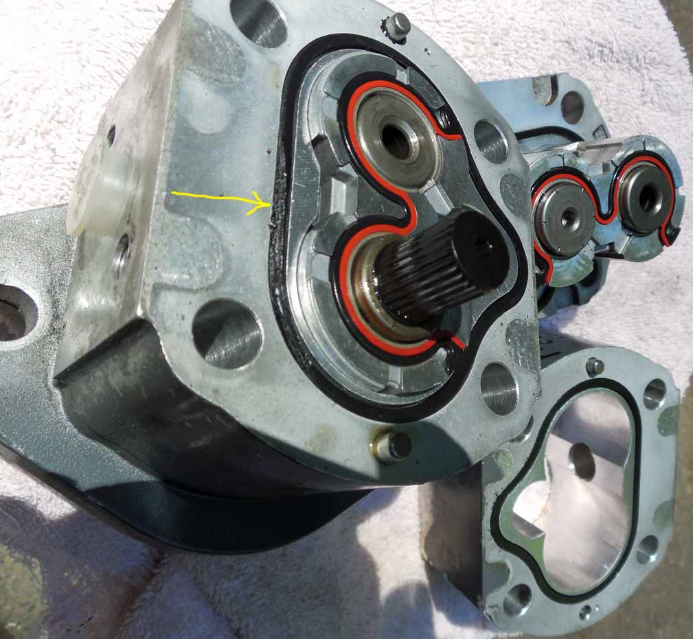

I was helping out the owner of one of the 2 CK30s I bought back in in 05. Seems he
had another pump failure...the 2nd one!
The first one was maybe 5 y ago, and the pump was replaced back then. It seems
that Kioti replaced the original Casappa, made in Italy, with a Joyang, made in Korea.
Well, that one is now leaking and needs new seals. Ordering seals from a Kioti
dealer recently resulted in new seals that might fit the original Casappa, but
certainly NOT the Joyang. I am trying to contact Joyang now.
Anyone put new seals in their pumps?

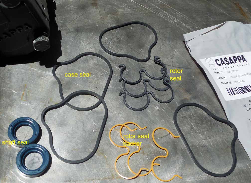

The outer seal needs to be of an exact length and profile to fit into its groove.
The seals shaped like the number 3, black and orange work together and have
critical fitment.
It is unlikely that seals from anyone but the original maker would work.
It is problematic if Kioti uses a different pump now, and does not sell seals for
it.

Well, the seal kit sold by Kioti fits the original Casappa pump. I have had no luck
reaching Joyang about the replacement pump. I have still not verified that the
Joyang pump is what Kioti sells now for this application. The part number of the
original is superceded.
It IS possible that the company that replaced the pump 5 y ago did not get the Joyang
from Kioti.
