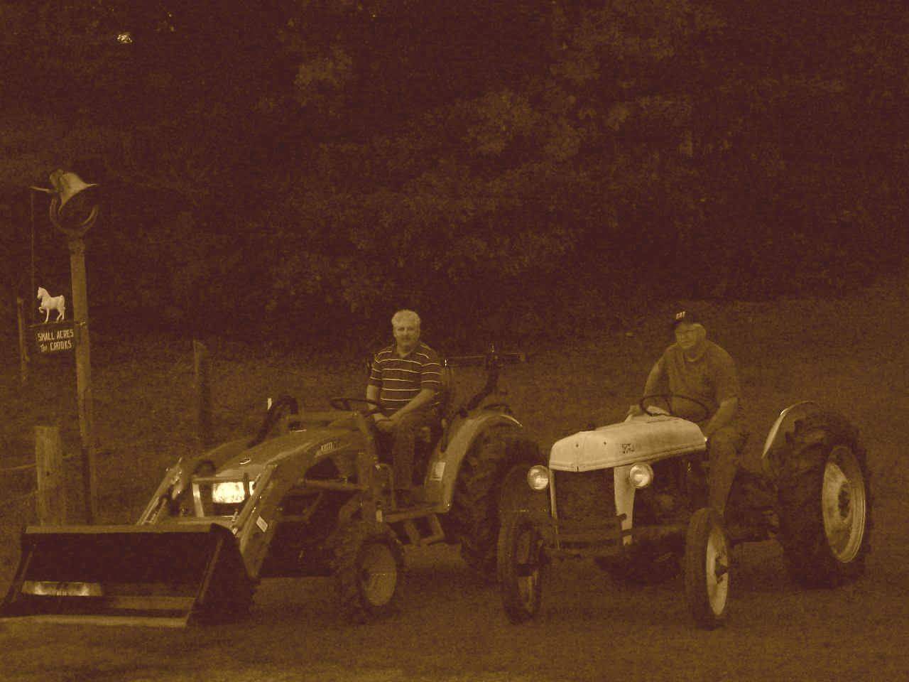

Dad & I went with the Ag tires on our CK35 and I wouldn't go back & trade for the industrial tires for anything.
tripleup05 said:
edit: I should also add the tractor will rarely be on the lawn, so Ag tires chewing up the grass are of little concern.
For ground pressure - if you're doing ground engaging work the higher PSI footprint of the Ag tires will give you better pulling force & the more aggressive tread will give more bite - both come at the expense of digging up the turf. On softer ground the wider contact area of the Industrial will spread the weight better and do less damage to the turf but if it comes down to pulling power they will lose grip & spin before an Ag tire will.
Given you're not worried about the turf - Ag wins
For side stability / track width (I am assuming the following is still true with the CK3510 series as the older CK35) the Ag tires are the only ones that come on adjustable rims. There are a couple different mounting positions you can use to make the wheel spacing narrower / wider. We told our dealer to set it to max width when he assembled the tractor. That along with loaded tires and we haven't had any issues anywhere with stability - and we're in the foothills of the Blue Ridge, not much to call flat around here.
I will tell you that coming from an 8N to the Kioti that until you get used to it that it will *feel* less stable on side slopes. This has to do with the geometry of the operator position. The seat on the Kioti sits much higher over the center line of the axle than on the 8N so when tipped sideways you are moving farther laterally in the seat than you were on the 8N. The tractor isn't actually going anywhere but it feels really strange and makes you happy to be wearing that seatbelt till you get used to it.
I'll try to remember to dig thru my photos when I get home tonight as I have one shot of the CK35 & the 8N setting side by side right after we got it - that might help you see a little better.

Thanks for all the info about your experience, and yea, I'd definitely like to see that picture with the 8N.
Thanks to everyone else for the input as well. I believe I will be picking it up tomorrow!

Totally forgot by the time I got home. I was able to pull this one off Facebook but not sure it will be of much help.
