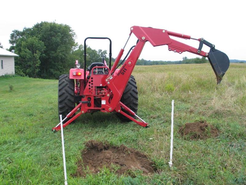

In my concerns for safety on my hills and slopes, I'm wondering if I should have my dealer spread out my tires on my tractor before it's delivered and how much? According to Mahindra, all four tires can be spread pretty easily... the manual supposedly explains how it's done and how far they can be spread. I'm wondering how much more safety this would add? I'm already having my front and rear tires filled with water/antifreeze which is supposed to lower the center of gravity.
Has anyone spread their tires out on a 6500 4WD?

This is what I was referring to in your new tractor operator post in the safetey forum. I would highly recommend setting your tires out. I think mine are in the second to farthest out position. Only drawback is if you need to do tight space loader work. Also, make sure your attachments always clear your tire width. Now that I think about it I saw that you are planning on getting an 84" box blade? I'd recommend the 8 footer. Thats what I got and it works great with the 6500.
Also if your tires are loaded it is much easier for your dealer to do this than you. They are super heavy loaded.

I attached a recent pic that shows the spacing. Most larger tractors have tires that extend past the fenders. I think it looks better than being so squared off and tipsy with them tucked under.

No... it doesn't look funny or unnatural. Do they reverse the wheels or do they use some sort of spacing?

they can flip the wheels and mount on the outsides instead of the inside. If you look at the rims you can pretty much figure out all the ways to extend them. No spacers required.
