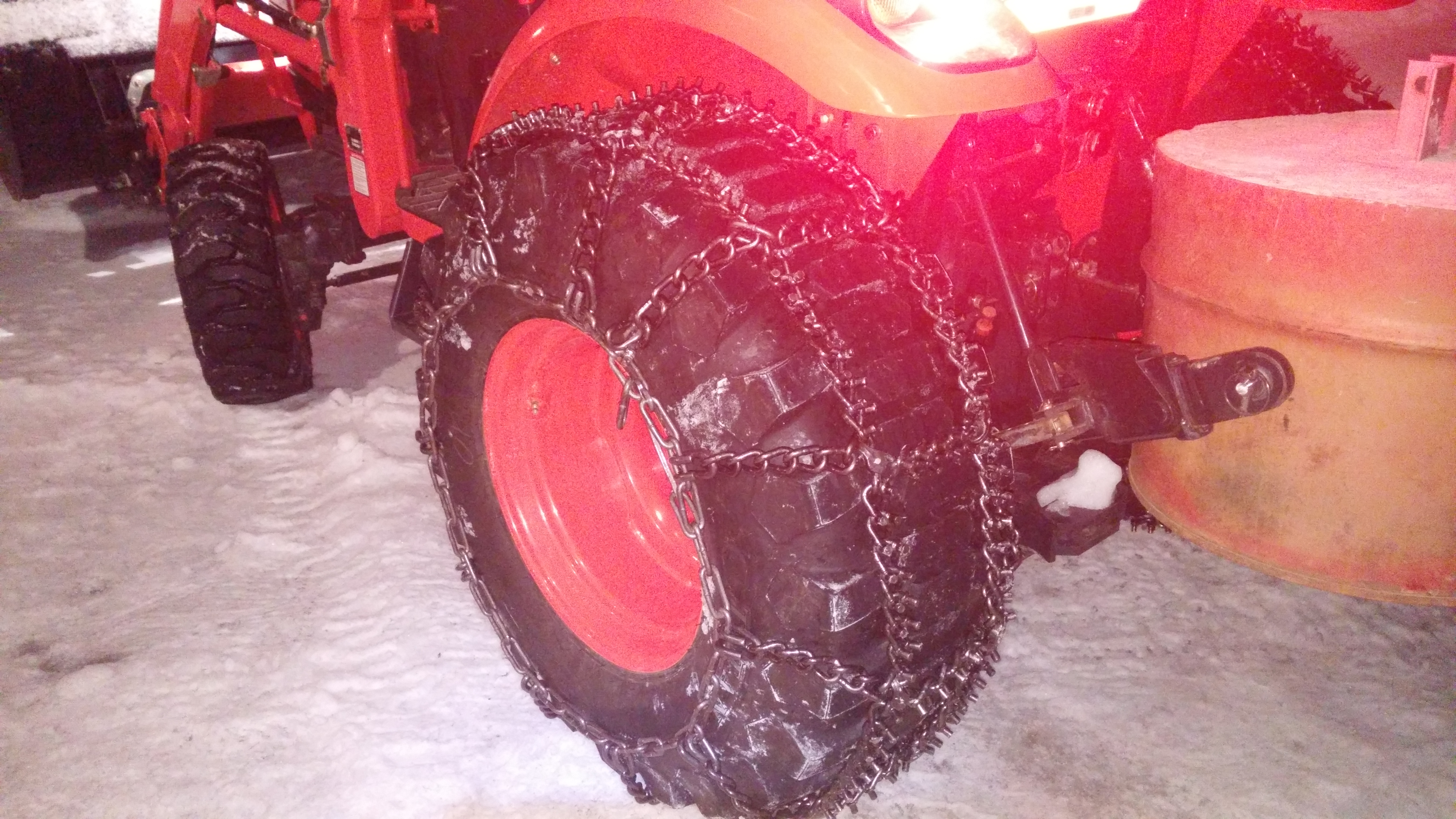

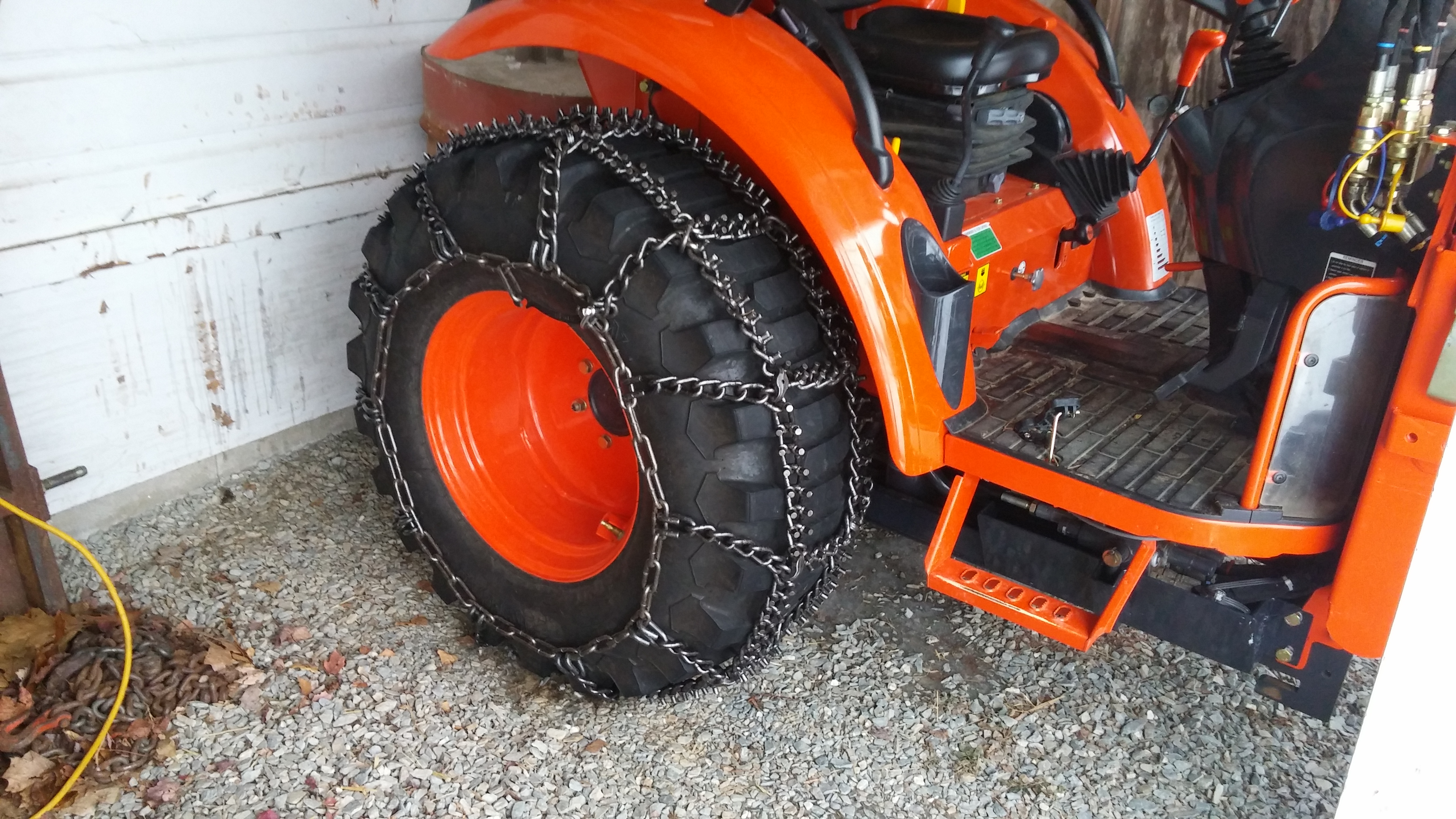

Just get some of these chains. Use them all winter and when I am logging in the summer and never get stuck. Are your tires loaded it can make a huge difference.
