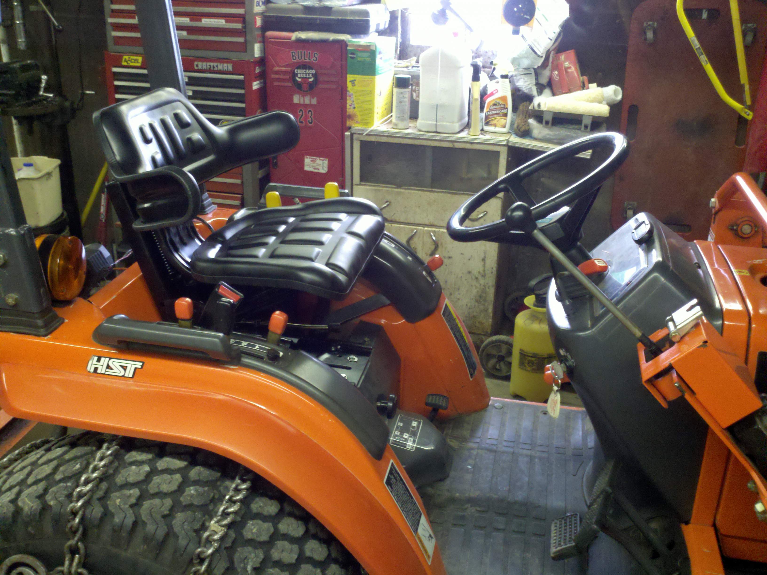

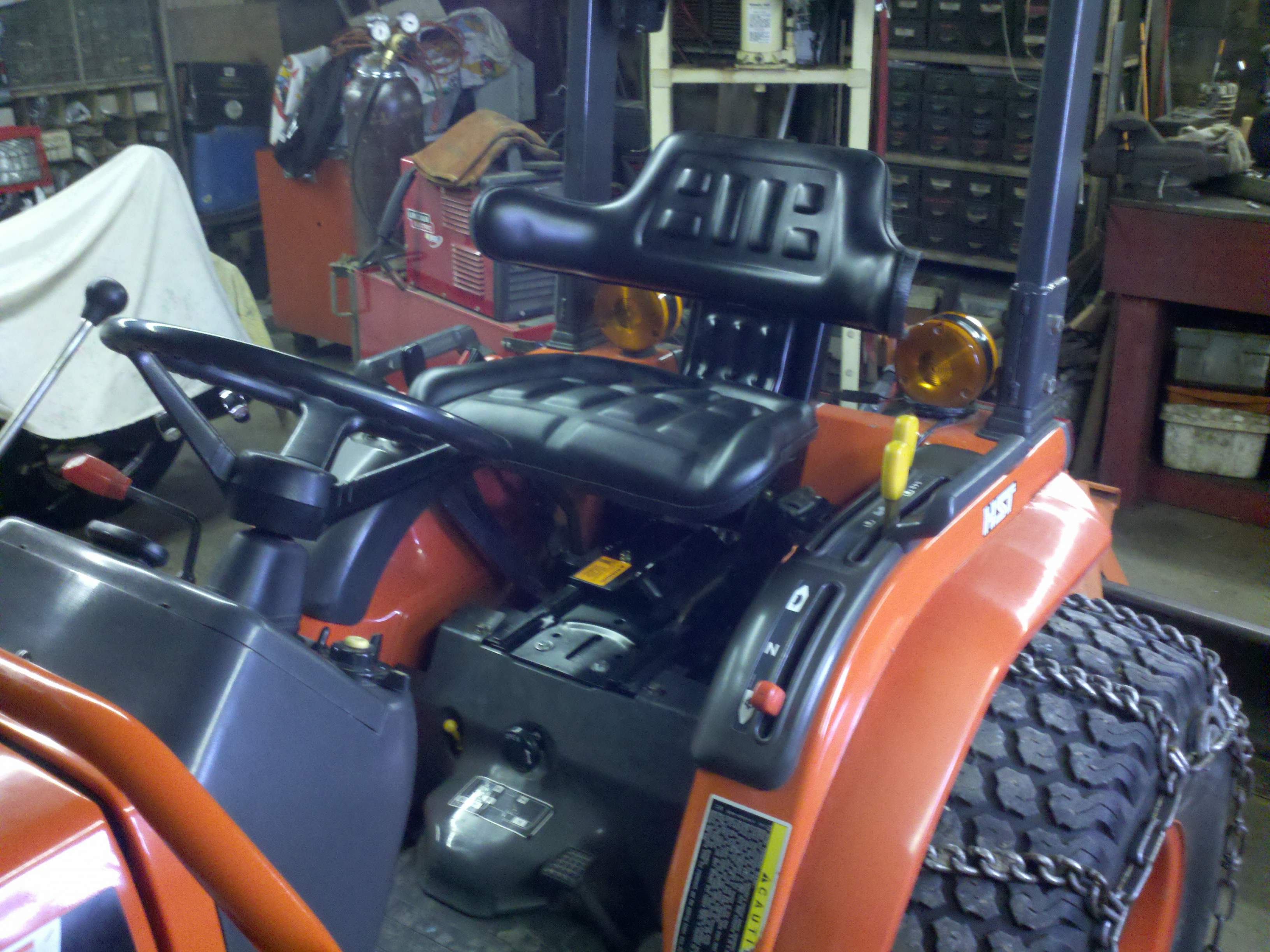

I added this suspension seat fromTractor Supply Co. ($100) to my B2400. I had to make a couple small brackets, but fabrication was fairly minimal. Sorry, I don't have any pictures of brackets. The only downside, I have to move my toolbox which was previously located under stock seat and haven't got around to that yet!! It did make a huge difference for me as I had injured my back and was having trouble even mowing our yard due to pain.
