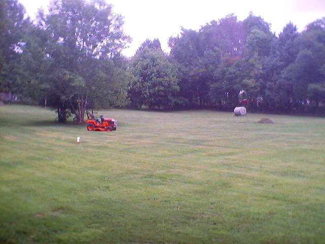

I've got one of those compost tumblers just sitting out in the field waiting for someone to come take it off my hands. I've had it about 10 yrs and after the 1st season I lost interest in it and never used it again. It just didn't work as advertised for me. I'd make sure I had the correct mixture of greens & browns and even tried compost starter, even emailed the manufacturer to make sure I was doing everything correctly. I got perhaps 3 loads of compost out of it in the same amount of time I should have got 20!
It was good in showing me the way to easily make compost though. Since it wasn't makeing any compost, my pile of clippings grew so much that I just started useing my FEL to turn it. I even added my leaves ro it. By early spring I had nice fluffy dark brown to black compost piled up next to the tumbler which was still trying to make a small load of it /forums/images/graemlins/shocked.gif /forums/images/graemlins/grin.gif
Now adays I just make a large pile of everything my BX23 & Cyclone rakes picks up and turn it weekly with the FEL and I always have compost come spring.
I'll make a good price for anyone interested in picking up that compost tumbler /forums/images/graemlins/wink.gif /forums/images/graemlins/grin.gif
In the pic you can see the compost tumbler just to the right in the BX23 just behind a working compost pile /forums/images/graemlins/grin.gif

Volfandt, I had the exact same tumbler as yours. I also have the exact same feeling about it as you do. It was more work for little compost. I thought about putting a timer and electric motor to do the cranking but started using the tiller on my garden tractor to turn the pile, that worked good.
