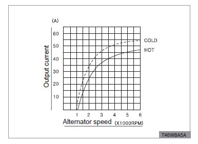

   / Anyone use a Power Inverter on your tractor? #10
Also keep in mind, the ratings for alternators are "best case". In other words, Wide open throttle, AND a cold temperature. As the ambient temp rises and the alternator heats up from load, they don't put out the full rating. What I am saying is alternator ratings are more like a paper rating not necessarily a real world what to expect rating. Here is the 55 amp rated alternator for my Kioti.
Excellent point from a design standpoint, k0ua!
