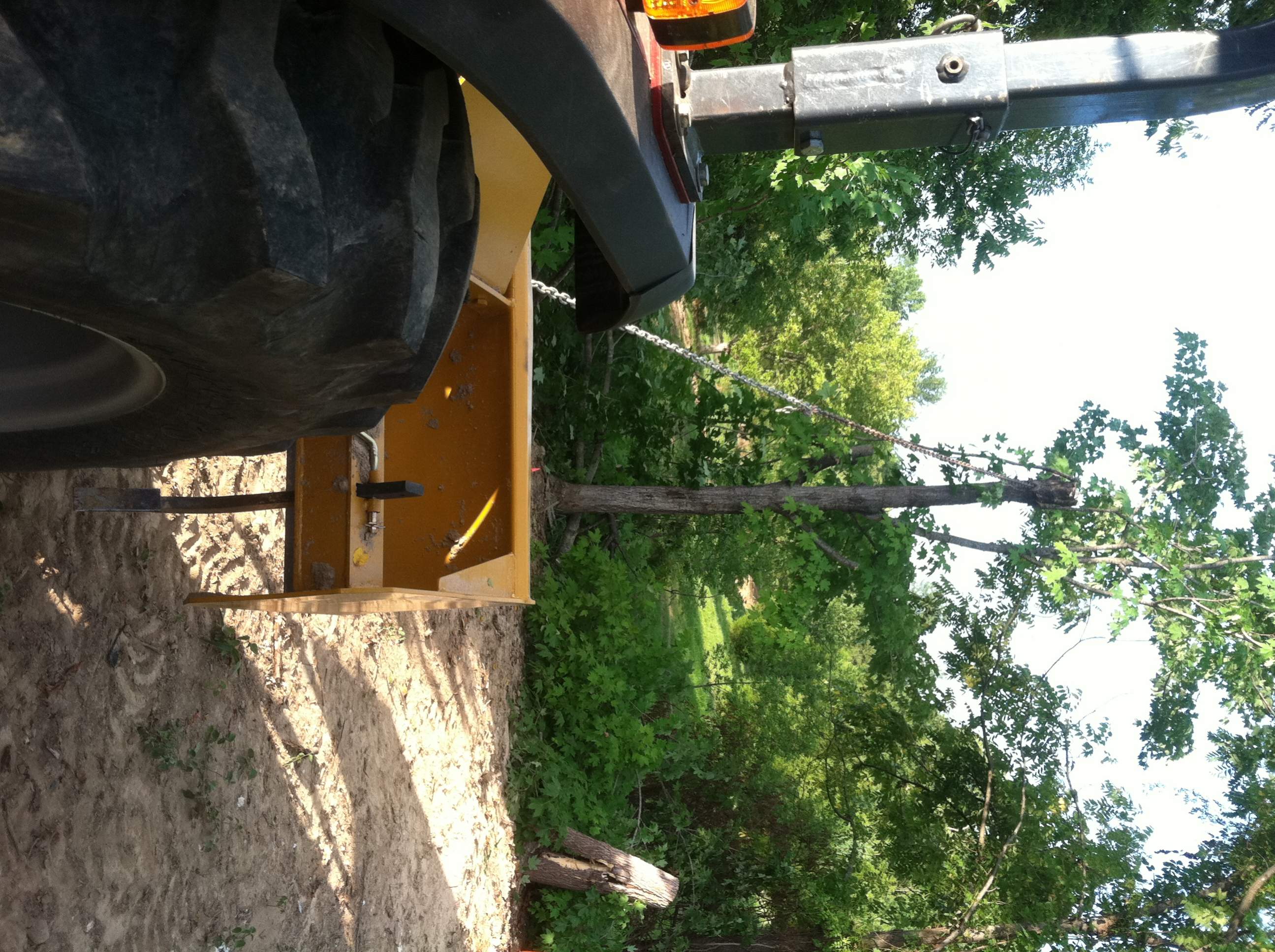

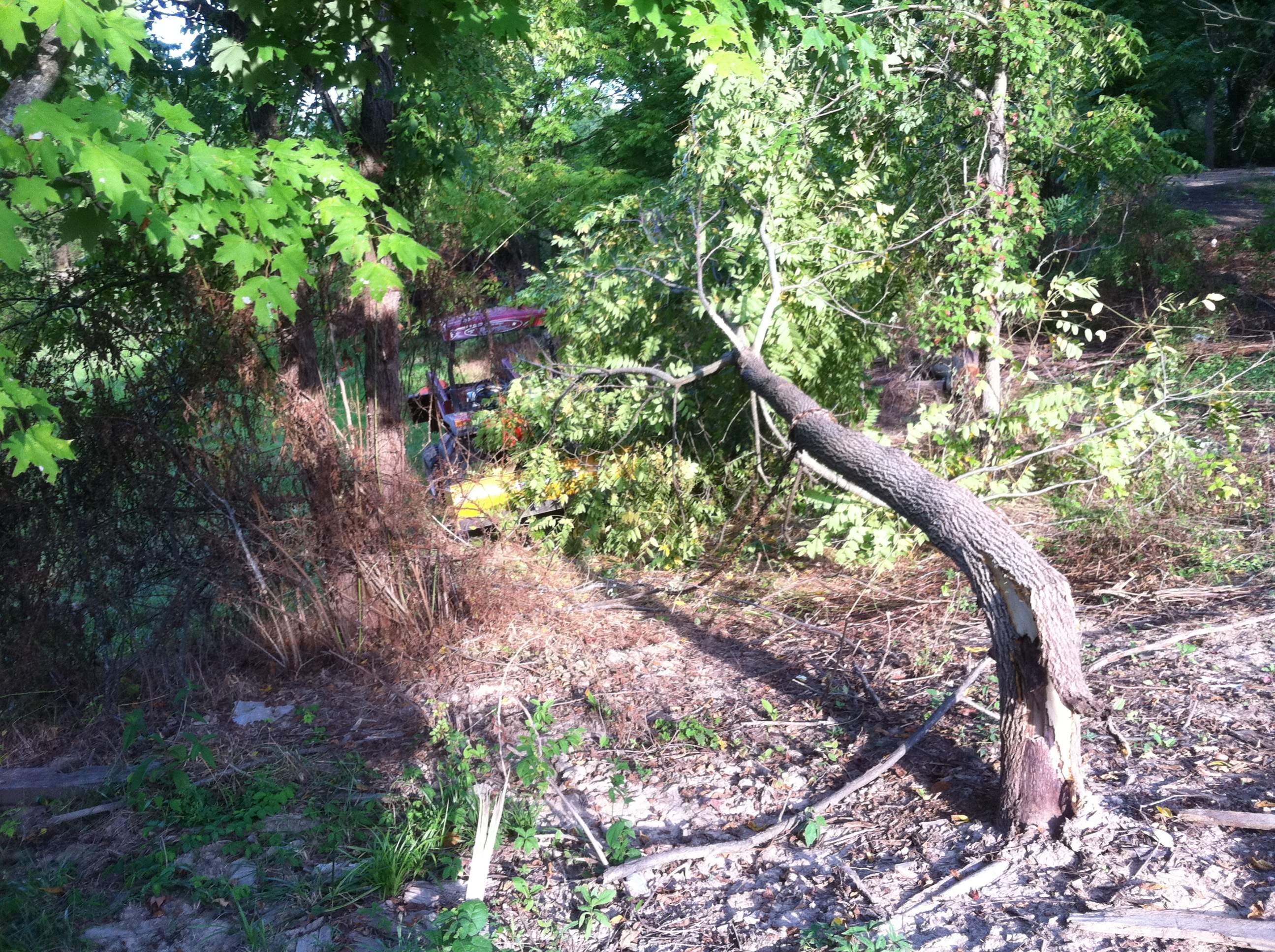

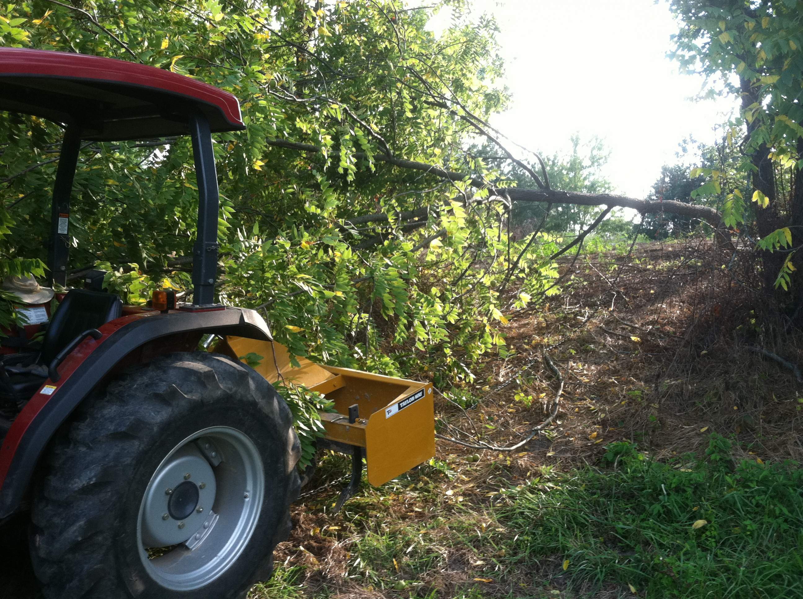

Hey, thanks so much for the responses. The good news is that the tree are still standing. I will Try to pull them over after cutting the lateral roots with a ripper.
If that fails I'll rent something. I'll have pictures by the week end!
Well that did not work out to well. The first tree broke above the ground and the second tree, a maple, would not give. Back to the drawing board.:mad:

Well, it looks like you didn't wait the required 2 days after a good rain. You cannot pull trees of that size rooted in dry ground. They either break off, or you run out of weight/traction to pull them.. by waiting until the top of the ground dries out some, you maximize traction, but the roots are still in mushy ground. On a 10 incher, make sure your chain is long enough the tree wont fall on you, hook up about 5 or 6 foot high, make sure no one else is going to be hit by the broken chain, only you. for extra safety you can put an old carpet draped over the middle of the chain or something to catch wind if the chain breaks. Then pull slowly and steady with increasing pressure, as the far side of the roots come up, you can go backwards (release pressure) if you need to to "work" the roots a little, it actually helps some. Keep pulling until it is out.I have never tried the ripper idea, but sounds like it would work well.

So this has to do more with technique/timing than equipment. I would imagine that the equipment used to tackle any task may have some some slight technique/timing enhancements applied while in use. Trying to do something with a small machine that usually is done with a larger one is what we ALL try to do here. A little more time perhaps but a lot more Satisfaction! Nice of you to share your experiences!

I just could not wait!
Actually I am in a rush. It has been very dry for about 6 weeks now. Im trying to prpare that area for a new garage.
