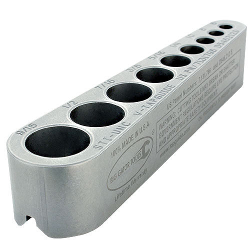

The only problem is that tapping the hole exactly straight without a guide isn't working as well as I would like. Has anyone used something like the Big Gator Tap guide? It looks like it's small enough to fit under the chuck allowing me not to have to unclamp the aluminum. If it's more of a gimmick and I would be better off with one of the self alignment tapping guides that would require me to at least swivel the drill press table out for access?

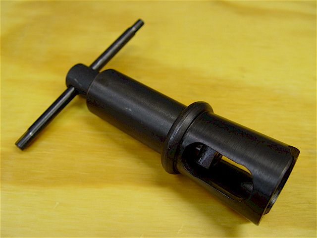

   / Anyone use a tapping guide?
The Brown&Sharp tap guide looks interesting. How strong is the spring on the centering pin?

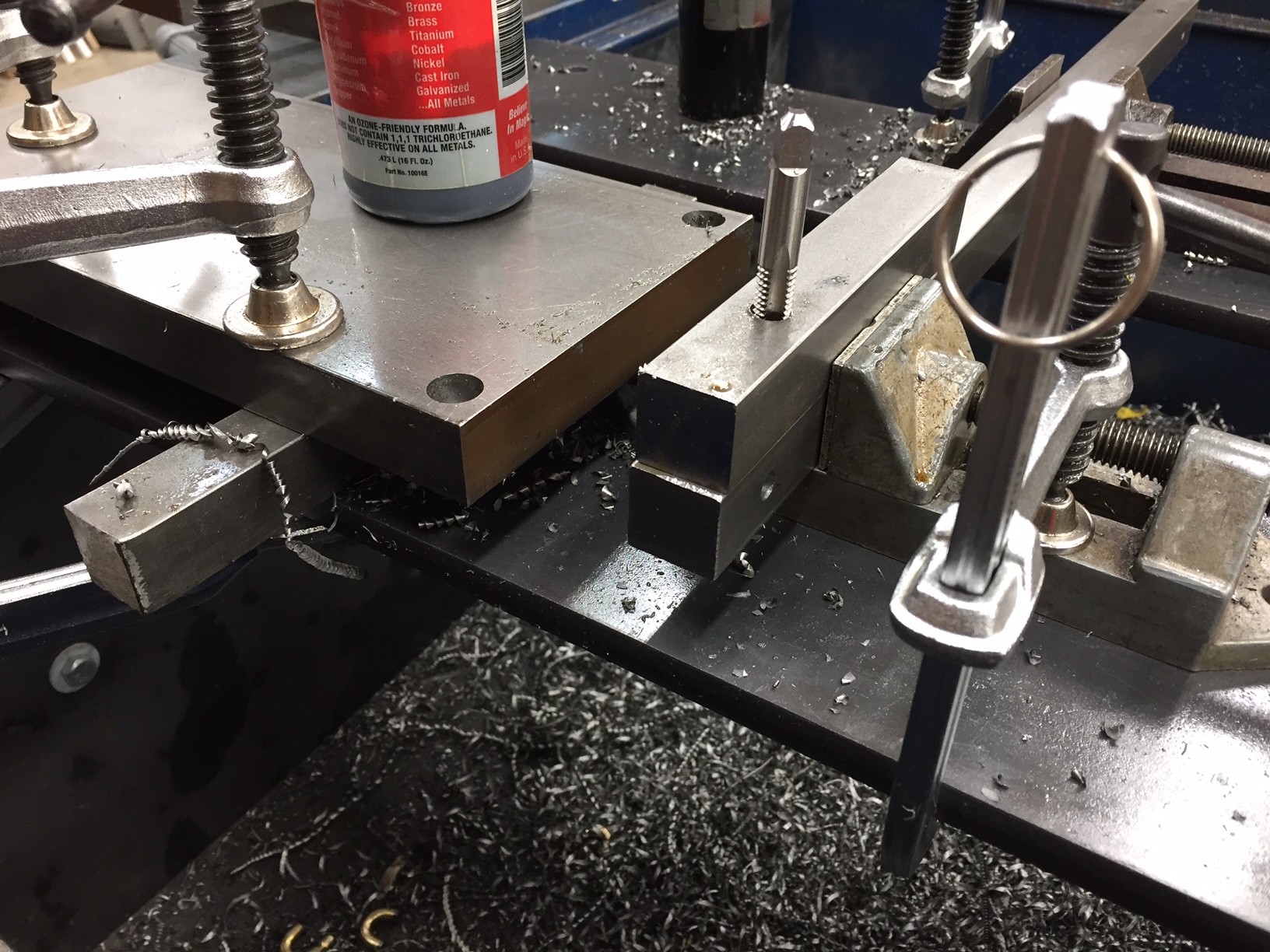

If doing more than one or two holes I make a guide, if possible out of the same material you are tapping. In the guide, drill a hole a bit larger than the tap. In this case a 25/64 hole for a 3/8 tap. Clamp both together in the vise. Works perfect.
