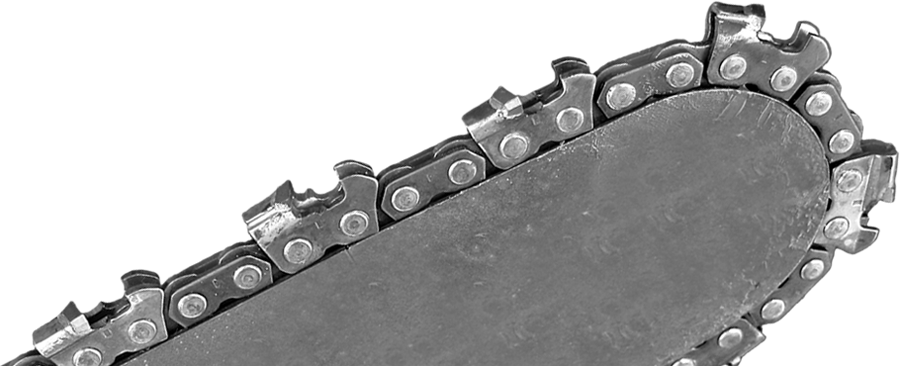

I have been running full chisel saw chain but am thinking of trying semi chisel. I understand that it is a bit slower but is more forgiving of dirty and frozen wood. Doesn't dull as fast.
Anyone have experience and thoughts?

Your expectation are basically in line with how it performs. Most smaller saws at least in the USA come from the dealer with semi-chisel, and the really small saws have chamfer-chisel which kind of looks like a cross between the two chains. Dirty wood or having a high risk of hitting the dirt, semi is a better option.

I have some that I use for extra dirty wood, like cutting stumps flush. No matter how much I dig around the stump and brush off the dirt there is still some. But for cutting normal wood I prefer faster cutting full chisel, even if it goes dull faster. I am pretty good about keeping it out of the dirt.

The answer is in the different shape of the cutters. The semi is a question mark shape which doesn't have any sharp points so the damage is spread over a larger area before significant lose of cutting ability.. Full chisel comes to a square point which is the secret to its cutting speed, but if that point gets damaged it will loose speed and cutting ability even if the rest of the cutter is sharp.
And I find just a small blunting of a few of those tooth points takes a lot of filing to bring them back. And then all the rest have to be filed to keep them the same length.

1. I run semi for a couple of years now. For me speed is not important, and i did not notice any difference, besides you gain time on cutting, you waste it on sharpening.
2. The length of teeth has no difference in cutting ability IMO. When i sharpen (by file) i run the file as needed for a particular tooth. if one got hit by a rock and needs 7-8 passes, it gets it, if the next one needs only 2-3, it will never get the fourth. If a chain is OK and one tooth is badly damaged or on the end of its life, i just remove it. I just check the rake height. Never noticed any difference. Unless you are a logger who cuts wood for a living, you will not either. Saw also does not have a caliper to check how long the tooth is.

Over the years I’ve kinda changed my mind in the subject and prefer semi chisel now unless I’m just trying to go nuts on a fast cut. I got some hopped up saws. The durability for me far out weighs the slightly longer cutting time.

Time for a carbide tipped full or semi chisel loop. They are expensive but will last and last. What firefighters use when cutting through shingles on a burning house. On my saws I run either 325 or 404 full chisel but then I do breathe on my saws as well. Takes some grunt for full chisel, especially with the large ones I use. Only my top handle arborist saw has a small chain and it's full chisel as well.
I threw my files away (in the drawer if anyone wants them I have a bunch). I grind all my chains now and I also grind chains for all the local arborists around here. I have 2 chain grinders, one is just for grinding chains and the other is set up for cutting depth gages and they both run CBN wheels so they never need dressed. The CBN wheels come with balanced aluminum rims and while not cheap, I've literally ground close to 500 loops so far and not a sign of wear either. I also grind commercial chipper knives.
Like I said, if you have a dirt issue, get yourself a carbide tipped chain. They do have to be sharpened with a diamond wheel however.
