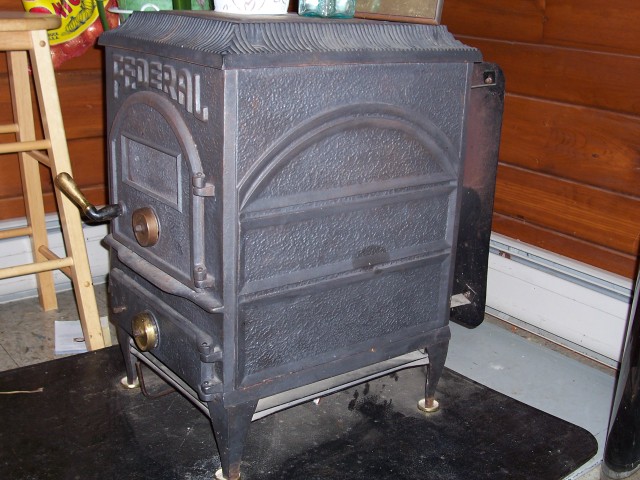

We have a coal stove in the kitchen. It was there when we moved in last year. I'd like to get rid of it but, Nancy won't let me. If she would, and you lived closer, it would be in your barn tomorrow.
