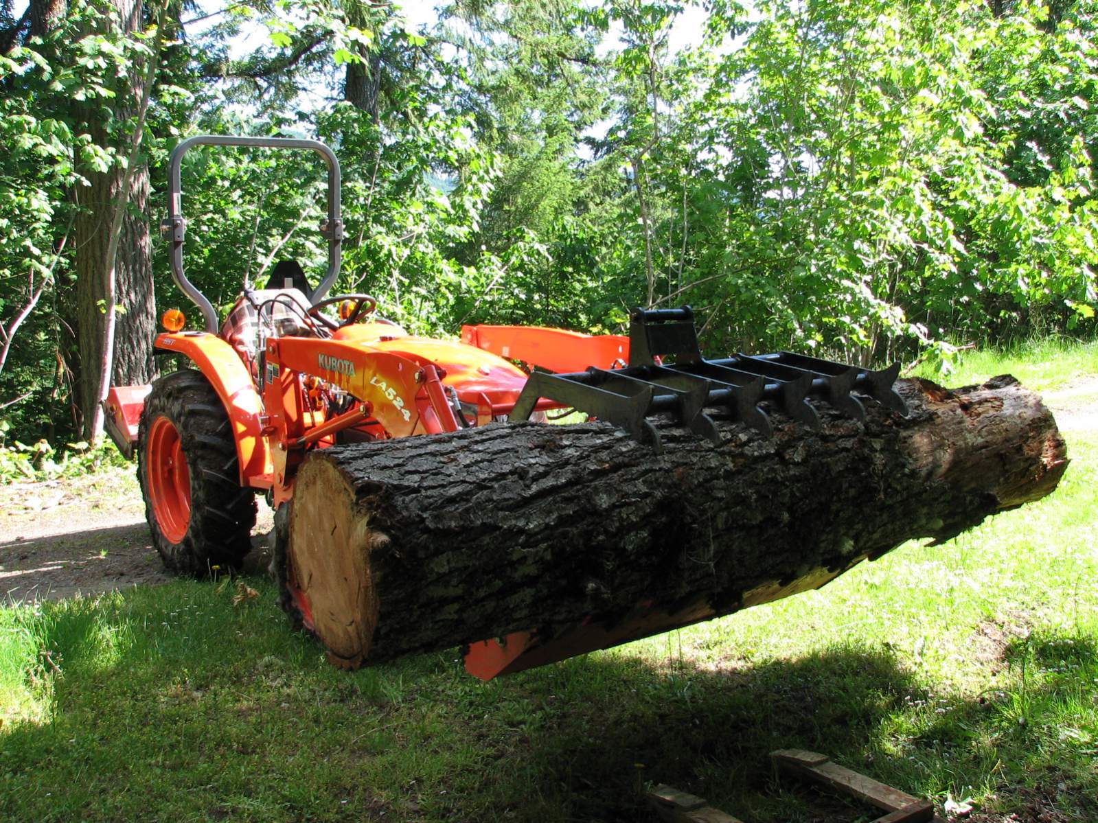

This is about a 24 inch log so you can see what I have here. This works well on my L3200. IMG_4836.jpg
