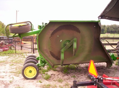

That 'disc' is a stump jumper. The fact that yours doesn't have one means that it is likely intended for light / medium duty use in already cleared land that just needs mowing.
My jd1517 batwing is in the same boat ( medium duty ). Has solid and rubber debri guards.. rubber on front.. solid on back.. etc.

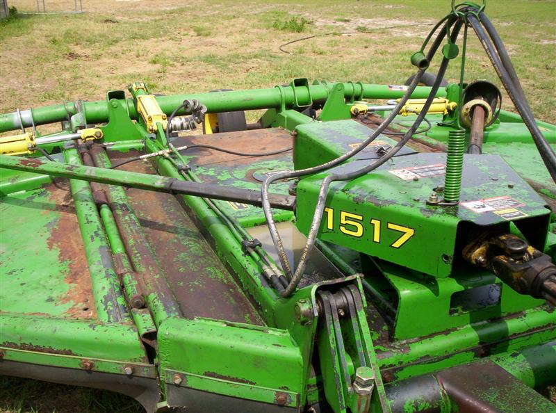

Also.. don't assume 100% that the wings fold just because they are folded. If it has sat.. the shafts can seize.. I had to pb oil and hammer-tap mine for a couple days while putting it under mild tension with a ratchet strap to get it to pop loose. After that I polished it with a scotchbrite pad, regreased, and slid back together.

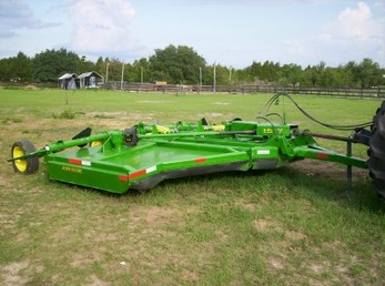

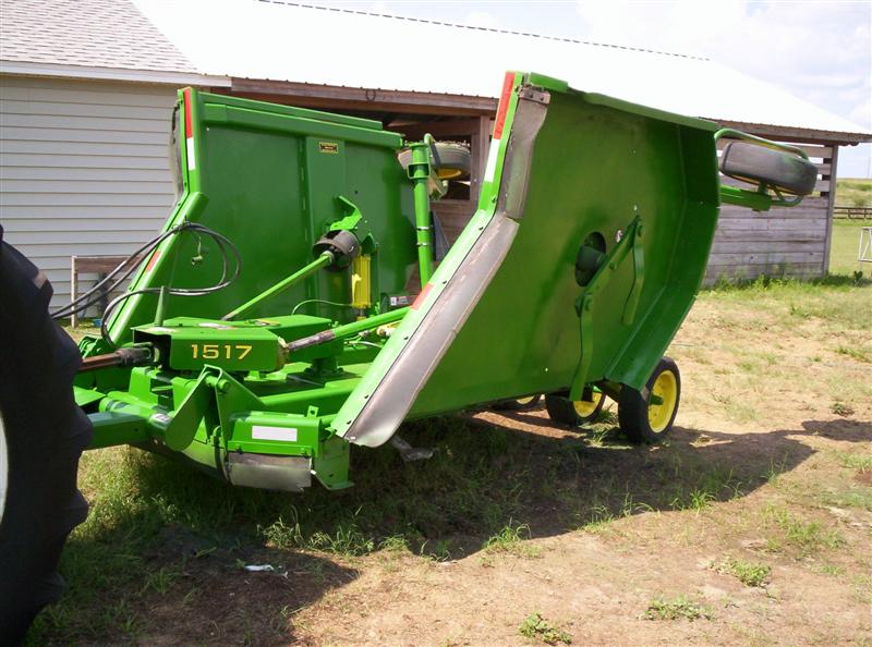

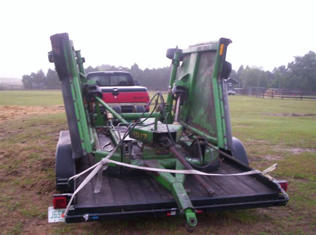

Here are some pics of mine.. it had surface rust.. some missing paint... patine/rusty bottom (surface) but no wear marks from blades hitting deck.. rough tires that DO hold air.. etc. Took me about 6 weeks to clean it, reweld a few pieces, repalce a few parts.. repack the wheel bearings, and get it washed ( many times ) degreased 9 many times ) and then primed and painted.
One of the pics shows the underside with the blade carrier and the ring the grass clippings catch at wher ethe blade spins. That may be similar to how your blade carrier looks ( no stump jumper ).
I paid 2000$ for mine. Coulda bought another just like it with different tires for 1500$ .. needed more work. another one came up for sale for 2500 a few weeks later. now thee ones I see are in better contition and in the 3500-4000$ range.. etc. ( mines doin' just fine for the 2g's i put in it.. )
