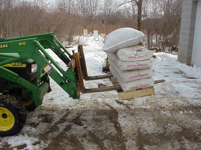

I don't have Deere's forks, but I made my own. They can lift quite a bit. What I have learned: The first set was built out of 42"x4" forks from a fork lift (very heavy, my setup weighed 300#) was able to lift 600 to 700 with only a back blade for counter weight.
See picture in below post.
42" in front of the loader is a LONG way. Lesson learned! Need smaller forks and less weight.

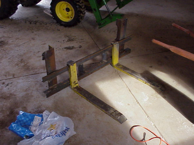

I found a set of forks in a scrap yard off a hand truck fork lift, like the ones shown in this link:
http://www.wescomfg.com/lift-prod.html
$10 and 5 minutes later, they went home with me. They are 27" long, 3" wide and much, much lighter. I am really happy with this set!!
This is really the way to go. I think these forks are the perfect size for the 4100/410. They are big enough for most tasks. The forks themselves had a 1000# capacity on the hand truck, so strength wise, they are well matched to the capacity of the loader. The fork attachment that deere sells, IIRC, weighs near 500#, and the carriage itself is rated for, I think, 3000#. So you buying a lot of weight for capacity you cannot use with a 4100, I won't even mention the price. The only down side, is that I have not made a backstop/carriage as nice as the deere ones.
But to answer your question, they are worth having!!! Not sure if they are worth buying Deeres brand. I use them for firewood (made a pallet with sides, fill it up at the pile and drop it off next to the house), landscaping stuff, moving logs, will try ripping out stumps in the spring (never thought of trying it), moving stuff!! It's just like anything else. Once you have it, you find many things to do with it, and you'll wonder how you lived without it. And if your not handy making stuff yourself, I would guess you could buy the pieces and have someone put them together for you for about $250 or so.
I can provide better pictures and details if anyone wants to undertake this project. Its really a simple build if you have the base skills. I welded it, but it could be done with bolting too. Feel free to email me for details!

   / Are Forks for 410 Loader Useful #5
First set I made.

   / Are Forks for 410 Loader Useful #6
Second set, I am really happy with the size, weight and capacity of this setup.

I also have a set of custom forks. I like what Cdash has done, It is simple and strong. I believe the 410 has an 800# load rating at the tilt point. The farther you move away from this the less weight you can carry. I opted for the custom forks (I will try to post a picture later). One thing I do know and have seen posted by others is the angle of the forks is not parallel to the ground when the forks are on the ground. (the end of the forks point into the ground) One day I will modify my setup to take this into account. Once you see my settup you will notice 4 hold in the center of the mounting base. The fork setup was only half of what I was looking for the second half is a boom for setting trusses on our new barn. (again I will try to post a picture.) The boom was made of two 10' square tubes that slide into one another. Any way they would reach up to 18 feet + the lift of the loader. With the combination of the fork and one boom section (forks turned upside down) we lifted the 4x8' sheet of partical board up to the roof (13" side walls) It got the sheets just high enough to grab and pull up. Good luck
