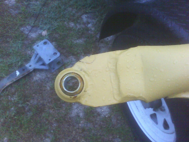

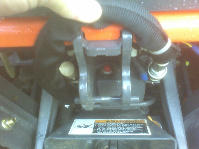

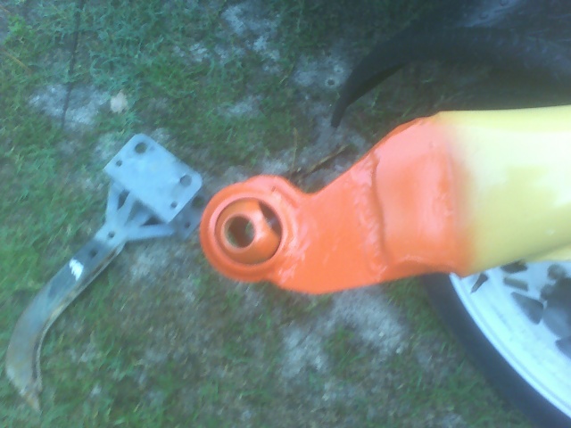

The end of a top link is no bigger than the socket holding the swivel ball. In Speeco/FarmForce's PHD they welded the ball to attach to the top link point in about a 4" plate, measured vertically, so it is much larger vertically than a top link, this plate is welded in the end of the pipe that forms the boom. I guess they assumed all tractors have plenty of clearance around the top link ears- the Kubota BX24 does not have much above the pin holes- they have a plate there, presumably to keep one from raising the top link too far and damaging the bodywork right above it...works fine with a top link, but with the more massive end of the PHD boom it is a problem.
I'll get some pics after it is light out...
   / Are most attachments a kit?
Ok here are the pics-
1st is the PHD boom as it comes
2nd is the modified end
3rd is the top link attachment point on the Kub with the bar that is in the way, see the nice dent I put in it before I realized there was an interference issue?
4th is the PHD on the tractor, it now raises far enough to work!
Sorry didn't have any yellow paint so touch up was Kubota Orange and the pics are poor because they are cell phone pics, didn't bother to go in and get the good camera.:D
You can also see my homemade ripper tooth on the ground in the first two pics...

Pics look great....
Yeah, I would have to chalk that up to the manufacturer building the top-link end to generic specs rather than thinking about any particular make or model tractor it might be used on. It would fit just fine on any old Ford or MF. But, your modification there looks mighty fine.
