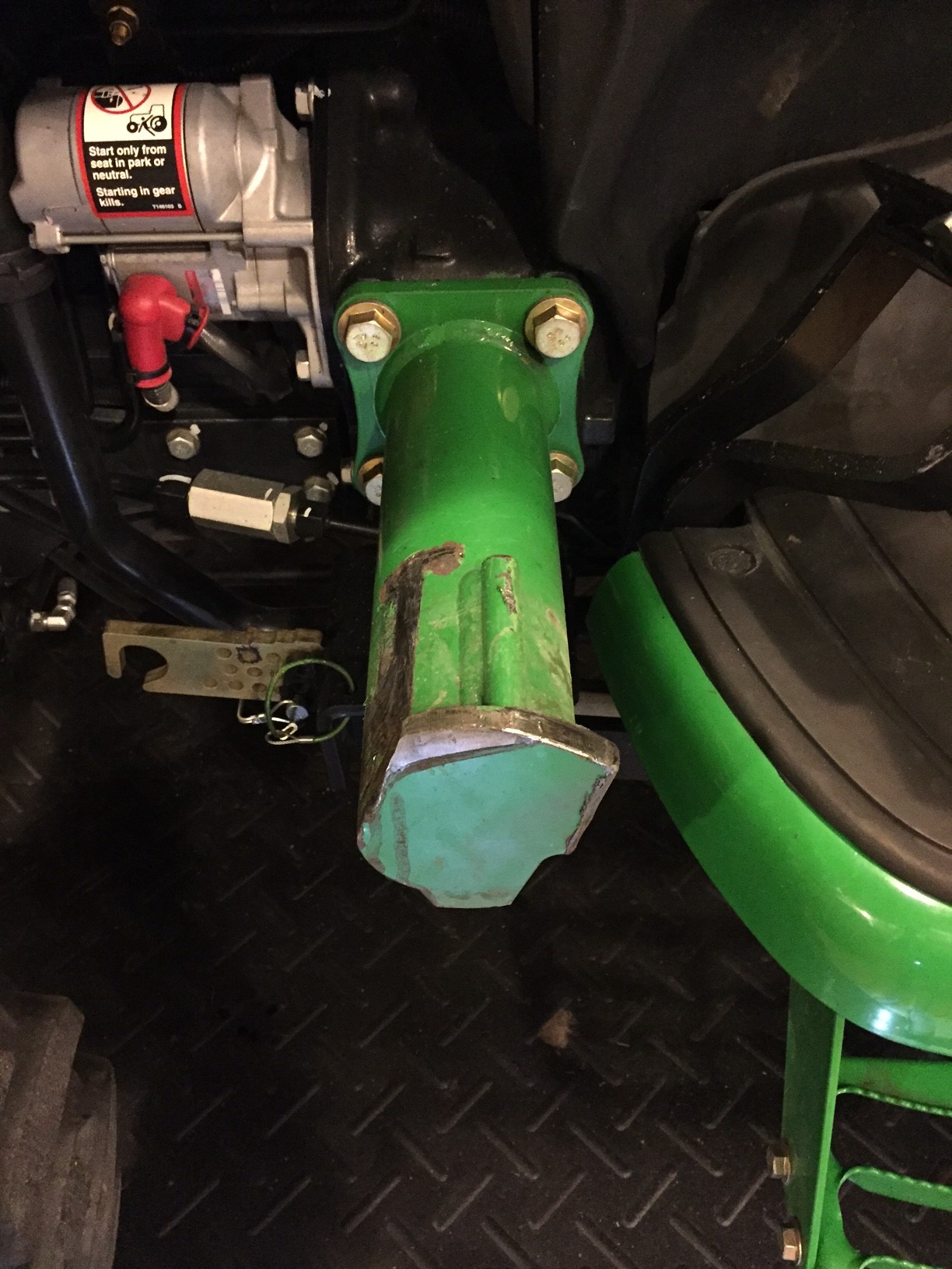

I was digging up a small stump last night and my loader arm popped off. It's never happened to me before... I have about 500 hours on my Deere 3320 and the loader was installed by the dealer. I did some checking online and it appears that the loader mounts are commonly installed on the wrong sides. Here are a couple pictures of mine. I think that might be my problem as well. Can anyone confirm this for me or take a couple pictures of their mounts? I'd really appreciate it! Thank you!
Right Side (if sitting on seat)
Left Side (if sitting on seat)

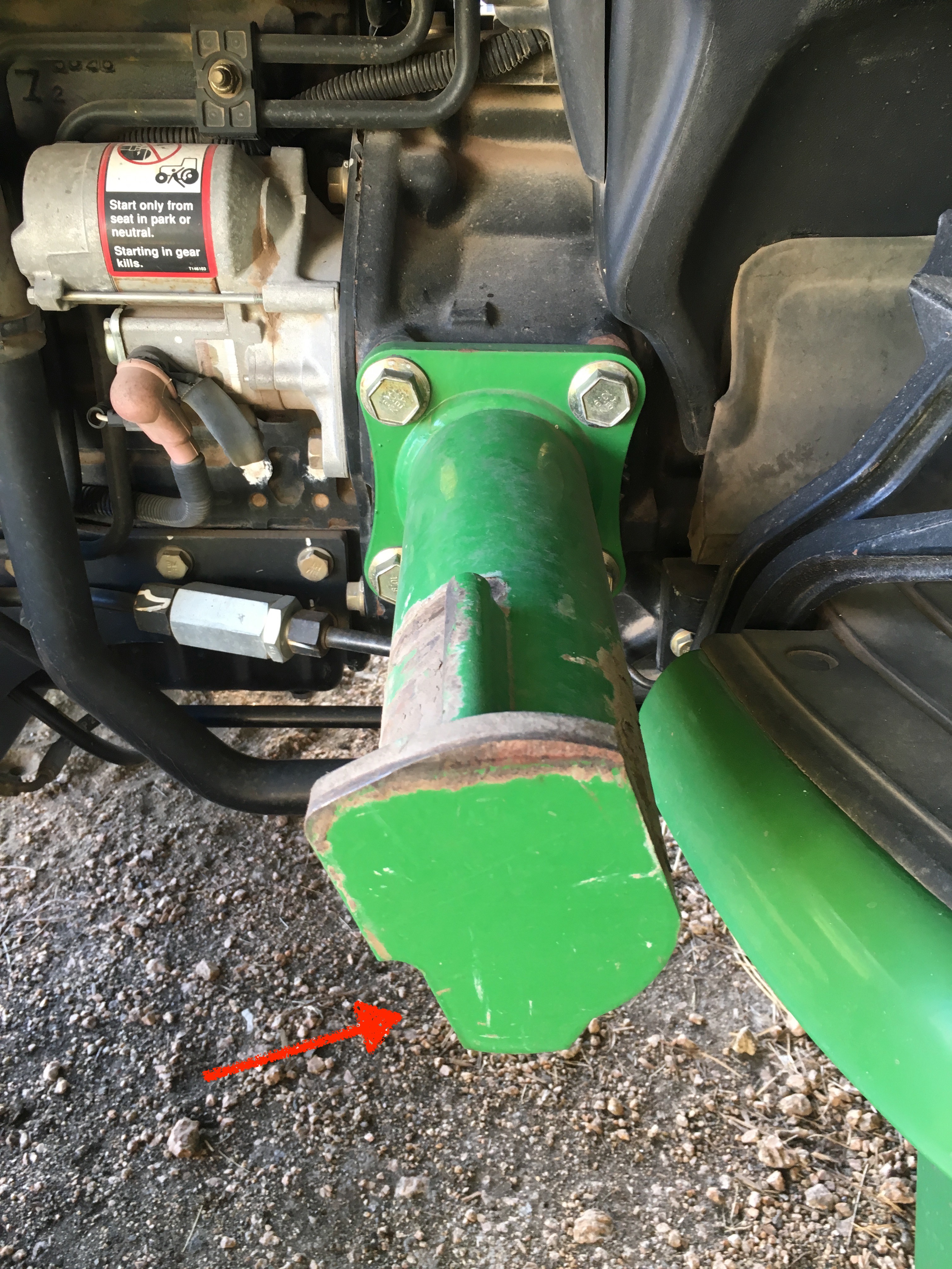

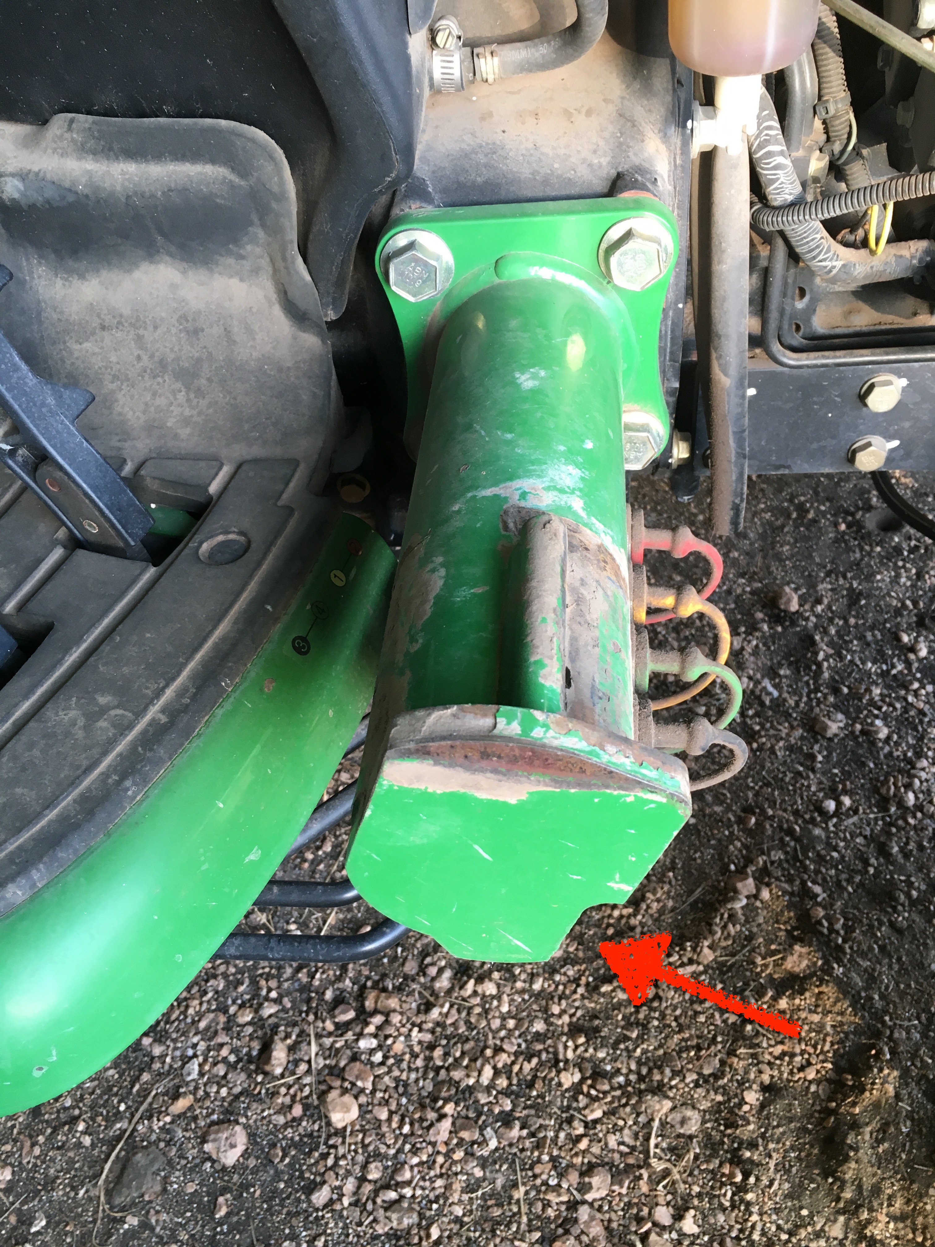

I think that your arms are installed incorrectly. Here are pics of my 3520. Notice the red arrow pointing to the curved notch on the arms - the notch is on the side of the flange facing toward the front of the tractor. Your notch is on the side facing the rear of the tractor.

Yep yours are backwards, the notches noted by Spindifferent should be facing forwards.
   / Are my 300cx loader mounts on backwards??
Thanks guys, you saved me a trip to the dealer. I now have about 600 hours on my tractor and it's crazy it hasn't happened before, although it always seemed like the loader arms sat on the mounts loosely. Guess I just got lucky...
