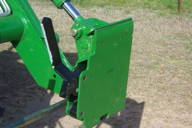

I always thought QA meant that the front end loader was a Quick Attatch ... in other words easy to remove the entire loader from the tractor ... I thought SSQA (Skid Steer Quick Attatch) refered to the bucket and the attatchments to go on in place of the bucket.
The easiest way to determine if your bucket is SSQA is to look see if you have two levers and spring loaded pins ... pull up the levers and back away from the bucket... if so its SSQA.
Here is a picture of one side of a SSQA

QA means quick attach but could be of any design manufacture wishes to use. SSQA is 'skid steer quick attach, the skid loader has adopted an industry standard so all skid loaders can hook up to any brand of attachment. From what I have seen in TBN over the past year Kubota uses the SSQA, there are some brands of tractor loaders that do not or did not use the SSQA system. I have seen some John Deere that use a different top hook design but Blueriver's pic looks like SSQA. JD may have both options now?? I also saw someone in here with a Bush Hog loader that had a unique QA but most companies today have gone the to SSQA.
To answer your inital question, Kubota uses the SSQA system.
