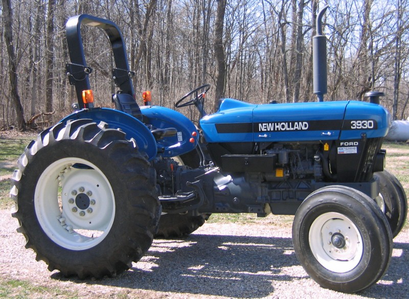

Well Who, I did it. Bought the 3930. Thought I would post a picture. Tell me what ya think?

that is a nice looking tractor you wont never find another one like it
   / Are the NH3430, and NH3930 exhaust manifold the same? #10
Wow she is a beauty I have a Ford 3930 4WD with FEL
