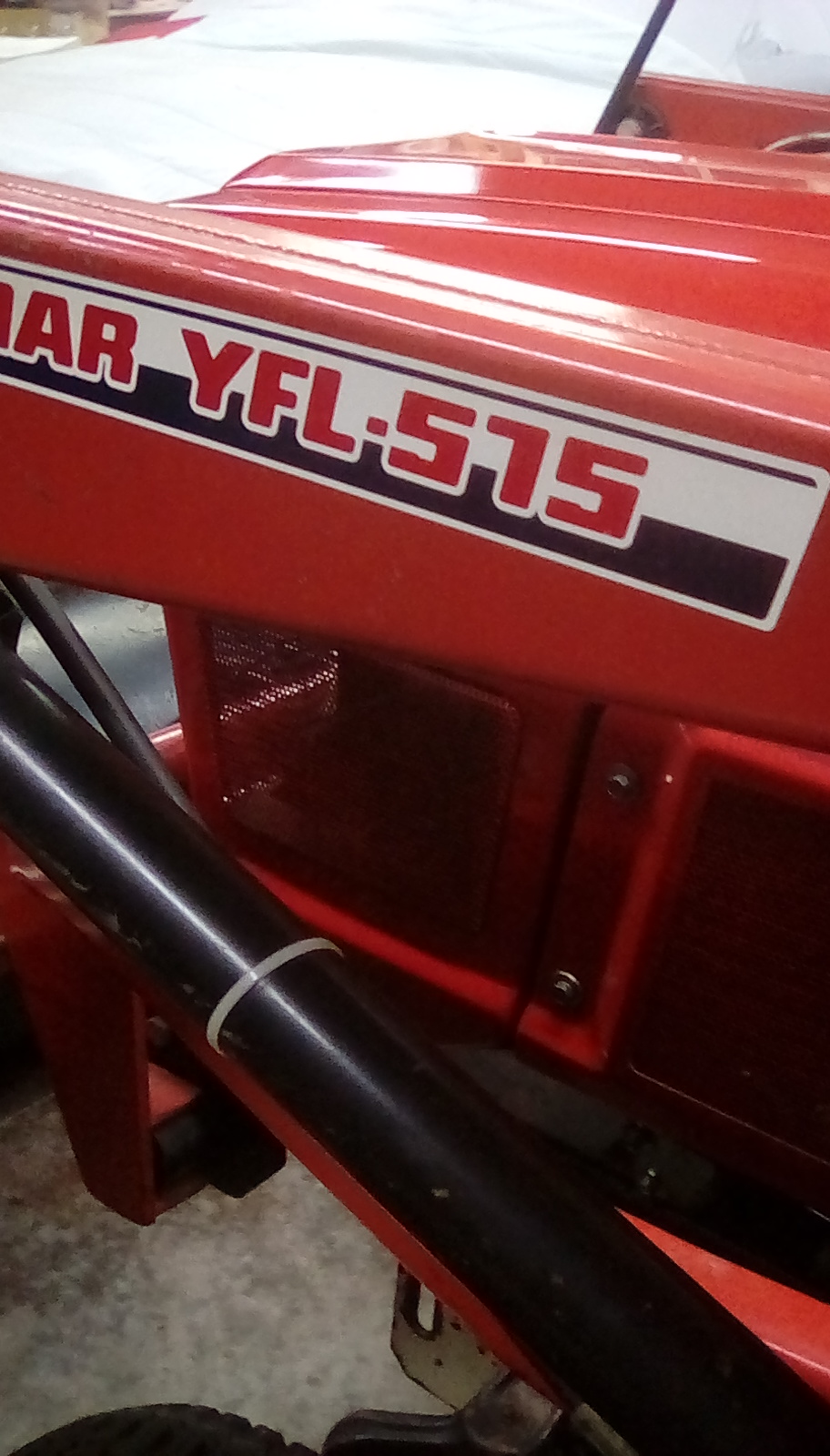

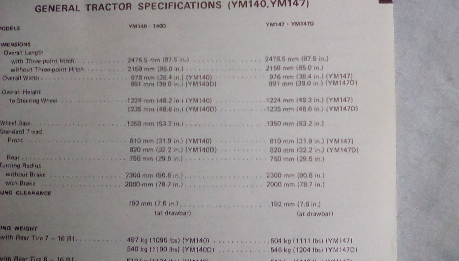

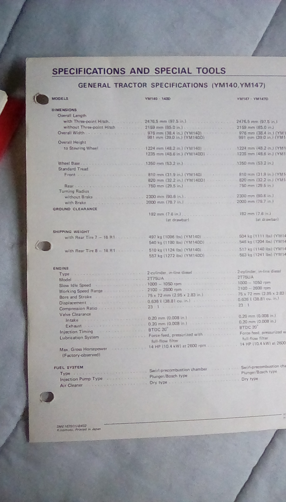

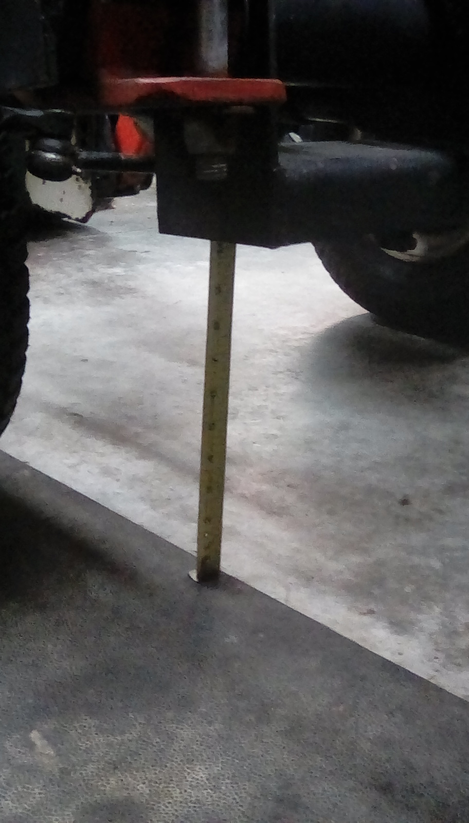

Hey scotty. My 147D and the 167D aren't too much different in spec. I run a Woods belly mount with the loader on with no issue. Could be different with yours.

   / Are the YM155 and YM165 identical? #4
I just seen you have a Ym165 not a ym167. May be completely different.

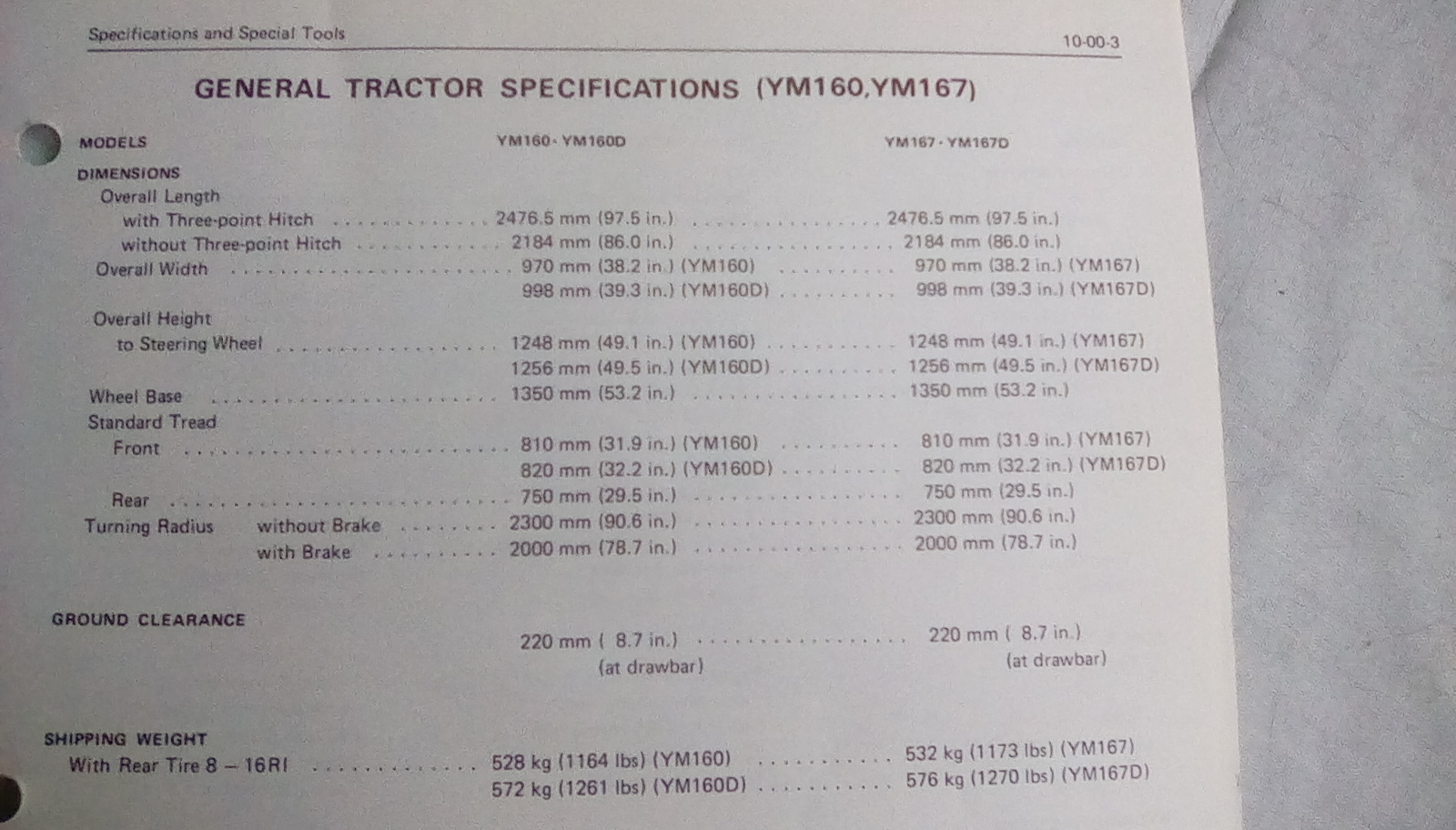

I don't know either. That sheet you posted on the YM160 & YM167 is the very first time I've ever seen those two tractors listed. Thanks for that, because I didn't even know that a 160 or 167 existed. Certainly I've never seen either one. When I get home in a couple of weeks I'll take a look at our 165 and also at our old literature library & see how close the 160/167 comes to our YM165.
Reason I asked specifically about the YM155 versus the YM165 is partly because my old dealer said the only difference was the paint and maybe the injector geometry.... And partly because if I can use YM155 parts to rebuild the YM165 it will be a lot easier. There were a lot of the old green YM155s sold.
