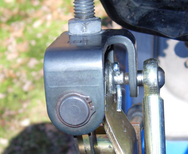

Got the pin in the mail yesterday and put it in this morning. This is the way it looks now. The (tiny) clearance between the pin and the bolt holding the ball joint is enough to allow full movement of the loader lever without contact. I'm thinking that any condensation that freezes between the two ends might cause problems, but other than that, I can't see why it won't work. I had put a lock washer under the ball joint to give a little more clearance but the joint didn't look particularly happy with that little adjustment and it works without it with this pin in place, so I am hoping this will at least get me through the winter (when I use the loader a lot more) and I can take a look at it on the first warm sunny day of spring to see if there's a lot of wear on anything.

After I couldn't get a nut/bolt combo to work, this is my last best attempt. If this fails, I'll remove the part and take it to a machine shop and see if they can remove the old head of the original pin and either weld one like this into it or attach it somehow. By my measurement, even with that old head removed, there isn't enough clearance to get a 3/4 inch bolt or pin through from the inside - apparently it must be inserted before they weld the part together on the bottom.. that's my guess anyway.

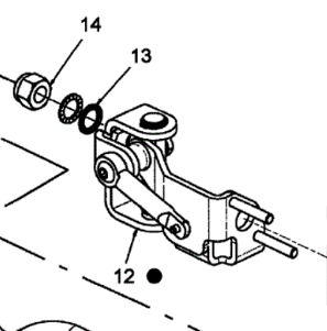

The picture next to it is the CNH picture of the shuttle from the parts list - this is the part that runs $300-$350..
