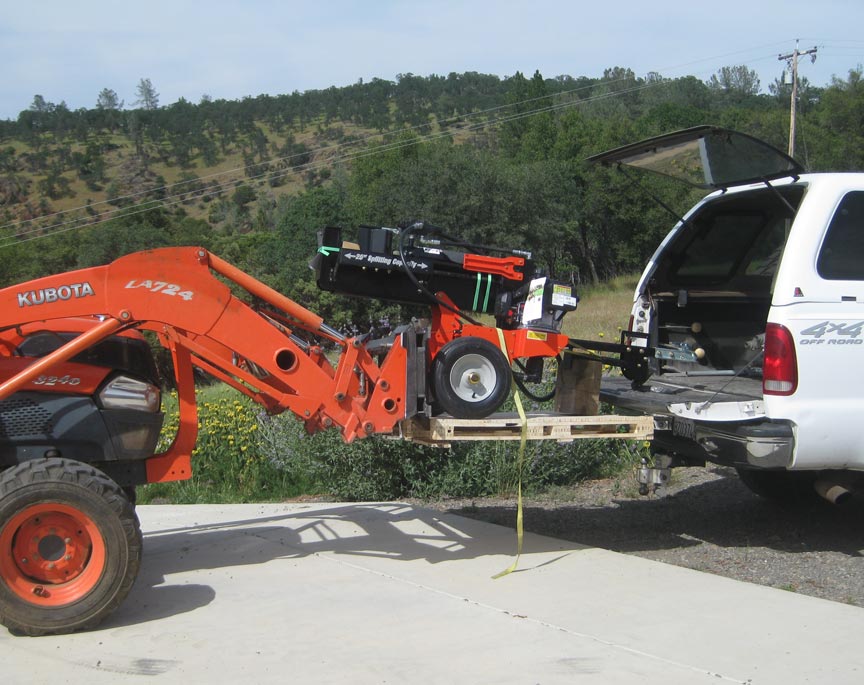

At home I put an old pallet on the forks of my tractor and ran that up to the tailgate to roll the splitter off. Strapped it down for the ride to the garage, where I started in on the assembly. The instructions that came from Ariens were complete and pretty easy to follow. First thing was to dig around in my parts bins for a 1/2x13 nut to replace the missing one, then properly secure the tow arm to the frame of the splitter.

That was all I could do at that point, all of which took maybe an hour. So I rolled the splitter out of the garage using the conviently placed handle on the tow arm and parked it where I could back up the little Kubota to it. The hitch was a little stiff dropping onto the ball, but latched down easily. The ground between the garage and box trailer is pretty steep and uneven, and I was a little worried that the splitter might tip over on some of the side hill parts, but didn't have any problems at all. As would be expected with a short "trailer" like the splitter, it responds quickly to even small steering inputs, so I had to pay extra attention when backing it up the ramp into the trailer. At 300+ pounds, I didn't even try to push it up the ramp by hand. But up the ramp it went, and it unlocked and unhitched easily. The swing down leg on the tow arm is a great feature, too, as it unlocks from either up or down by just sliding it out of a slot against light spring tension. That's an easy, one handed operation, and the tongue weight is light enough that I could easily support the splitter while doing so.
