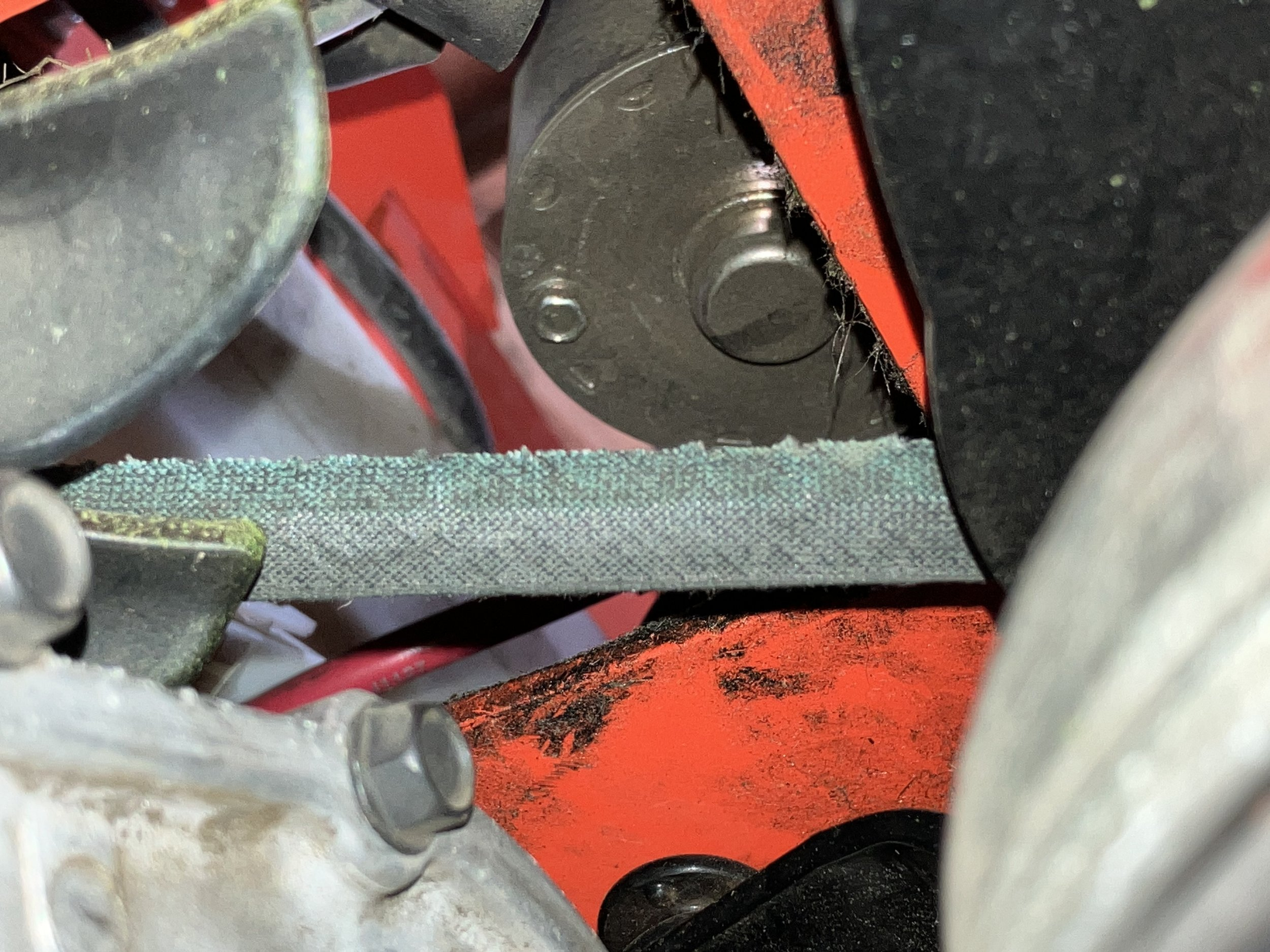

I had the issue with bent cooling fan fins. Then I figured that a had an idler pulley out of alignment with the other pulleys. It’s been better since I shimmed it but my drive belt is still getting damaged quicker than it should. I put a new Kevlar belt on at the end of last season. After 15 hours or so the belt already has slices in the belts outer layer. Doesn’t make any sense. You can’t see from this angle but on the opposite side the Kevlar sheath has been sliced and is separating from the belt in multiple places.

I think there is a warranty update for this problem.
