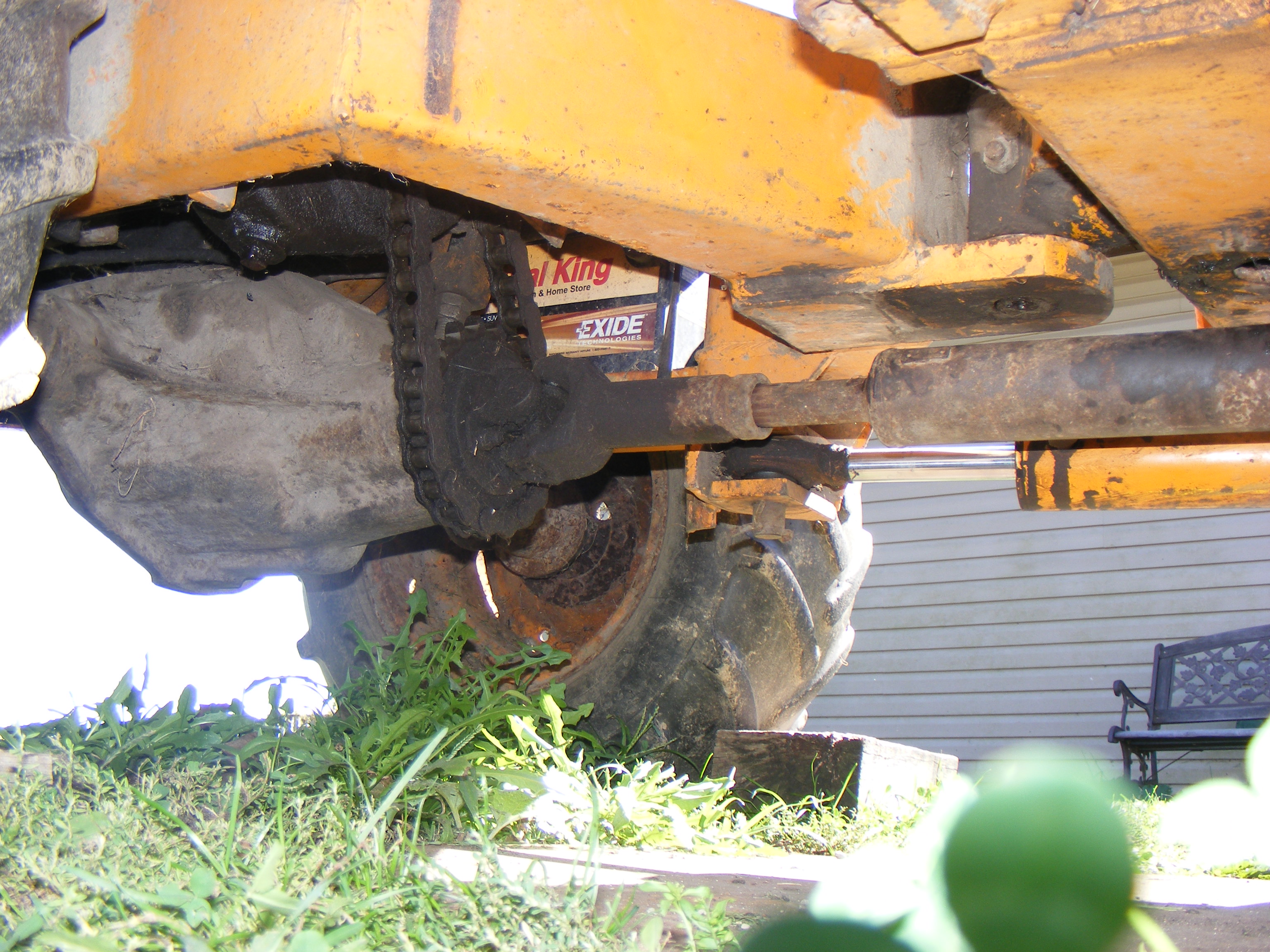

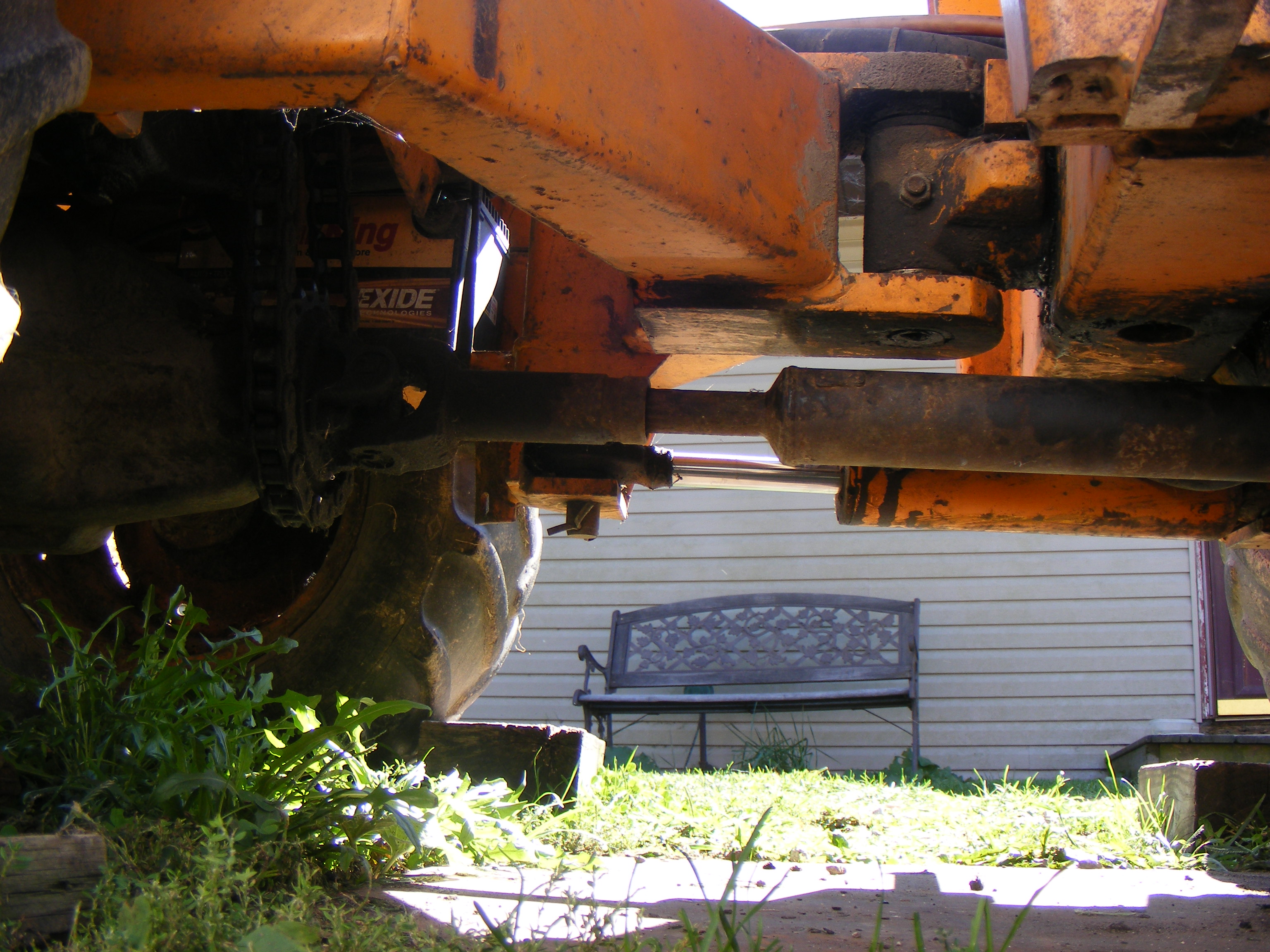

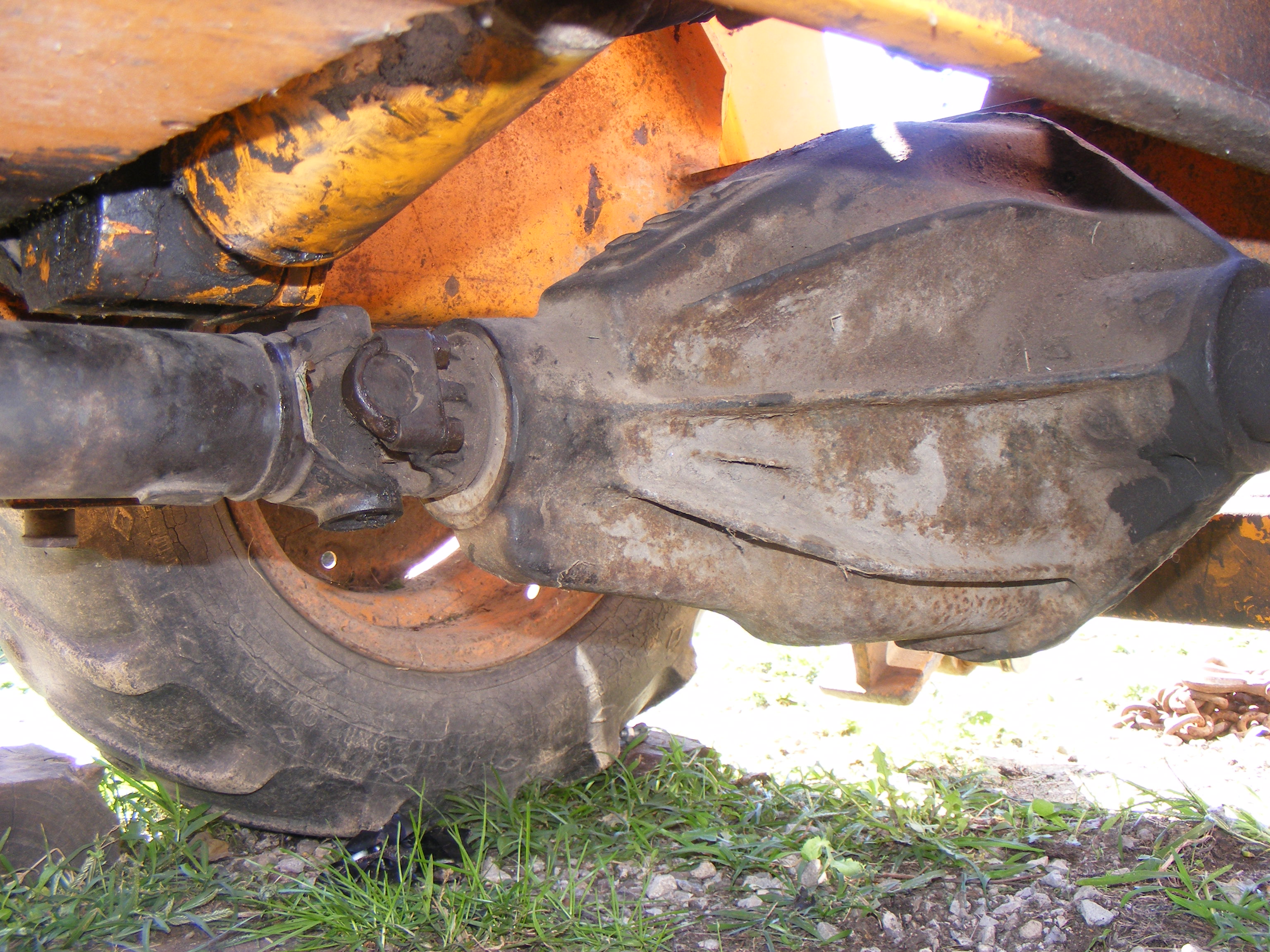

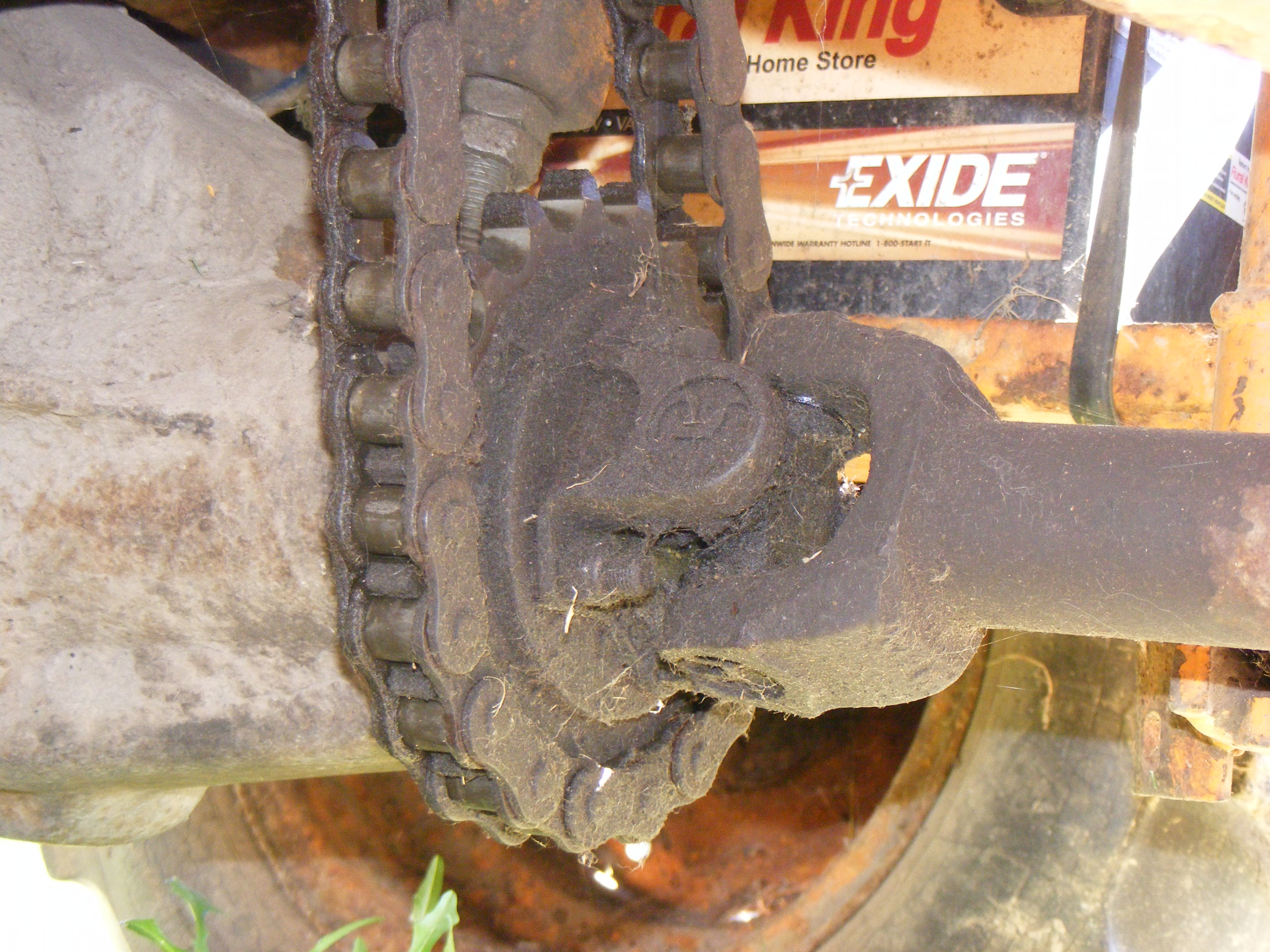

Some pictures of how case faced two jeep axles at each other then used drive shaft with a sprocket . There is a hydraulic motor with a sprocket driving the chain to the driveshaft.I would not think a mower would have to be this heavy . DSCF1133 (2).JPGDSCF1134 (1).JPGDSCF1135 (1).JPGDSCF1136 (1).JPG
