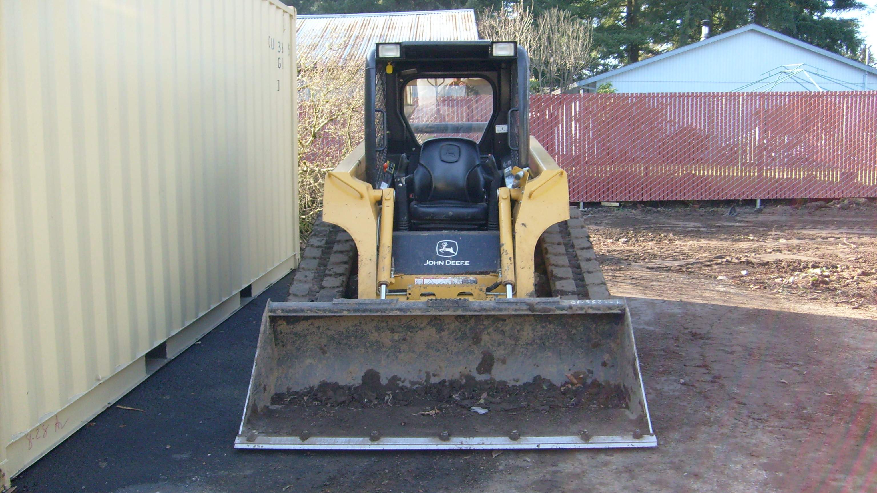

From my experience, track skidsteers are terrable on slick surfaces. A few months ago, I took my dads new JohnDeere track skidsteer (CT322) out to push the snow out of the driveway. I found that the tracks only slide on packed snow and get minimal traction on icey conditions. The compact tractor works great for snow removal. Maybe look on craigslist for cheap tractors with loaders. A wheel loader might be the ticket. Oh, the new bobcat is an all wheel steer A300 with the ability to turn the tires when on grass and reduce tire wear on pavement. The A300 can be equipped with turf (grass friendly tires) or industreal R4 (construction tires). Do great in snow when equipped with steel tracks or tire chains.
