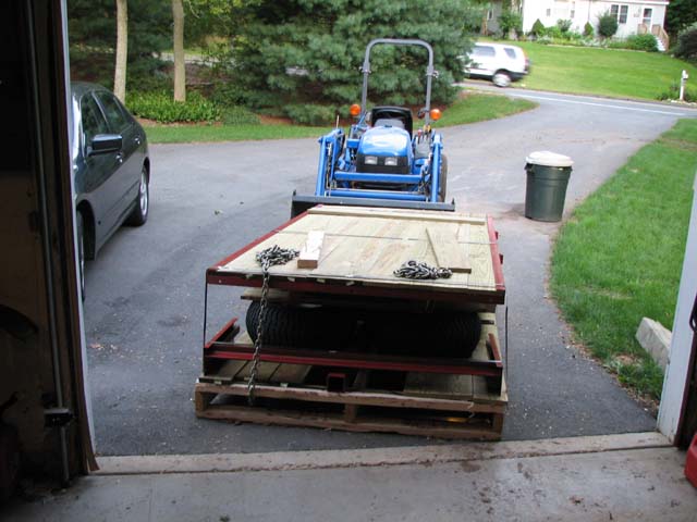

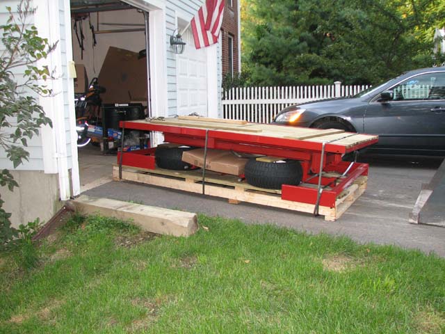

Step 0 get lucky & semi shows up with lift gate - still a chore to get it off as the crate interfered with his pallet jack. I had to lift up one end with the tractor as he lowered the other on the gate.
As shipped

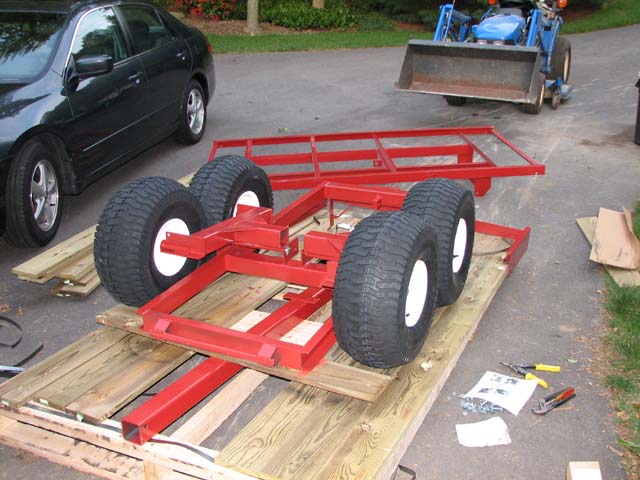

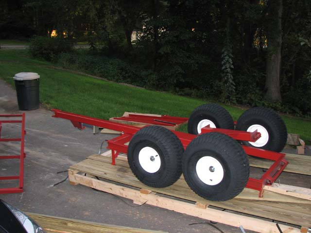

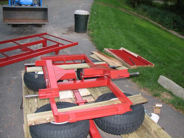

Step 1 - attach axles using 8" pins
Step 2 - attach wheels (cotter pins)
Step 3 - bolt on tounge
pic 1 instructions
pic 2 axel
pic 3 wheels
pic 4 tounge

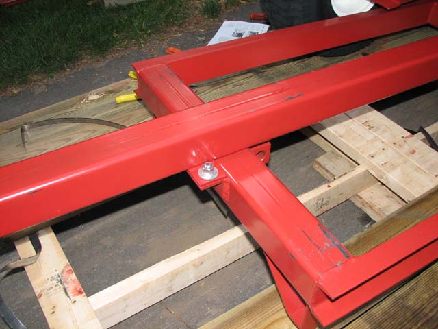

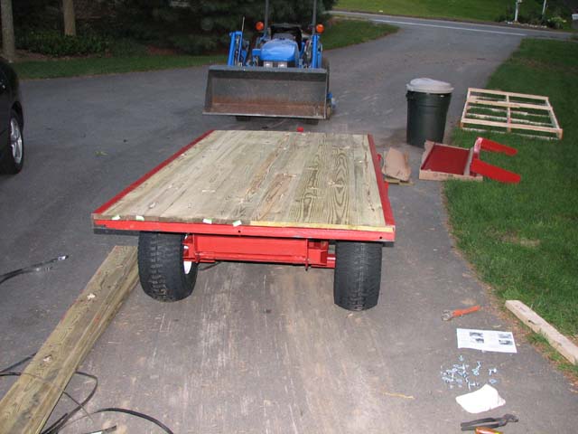

   / Assembling the Country MFG 2 ton dump trailer

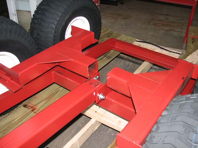

Step 4 - flip it over and pin on deck
Step 5 - add floor
Step 6 - bolt on front & back
Step 7 - Slip in wood sides & sheet metal front & back panels
pic 1 tounge details
pic 2 axle details
pic 3 right side up
pic 4 deck
pic 5 complete

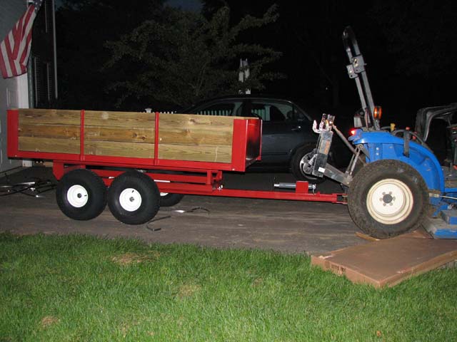

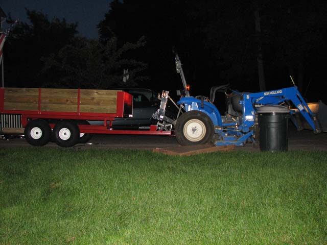

grease axles & attach to tractor.
My cylinder & hoses are still in transit - Surpluss center didn't ship them out for 48 hours:( If I had them on hand, I would have installed prior to the floor.
The whole job took less than an hour & only required a screwdriver, pliers & 2 adjustable wrenches. I suspect that it is simpler than the wagon model. I did add a couple washers here and there for the pivots.
