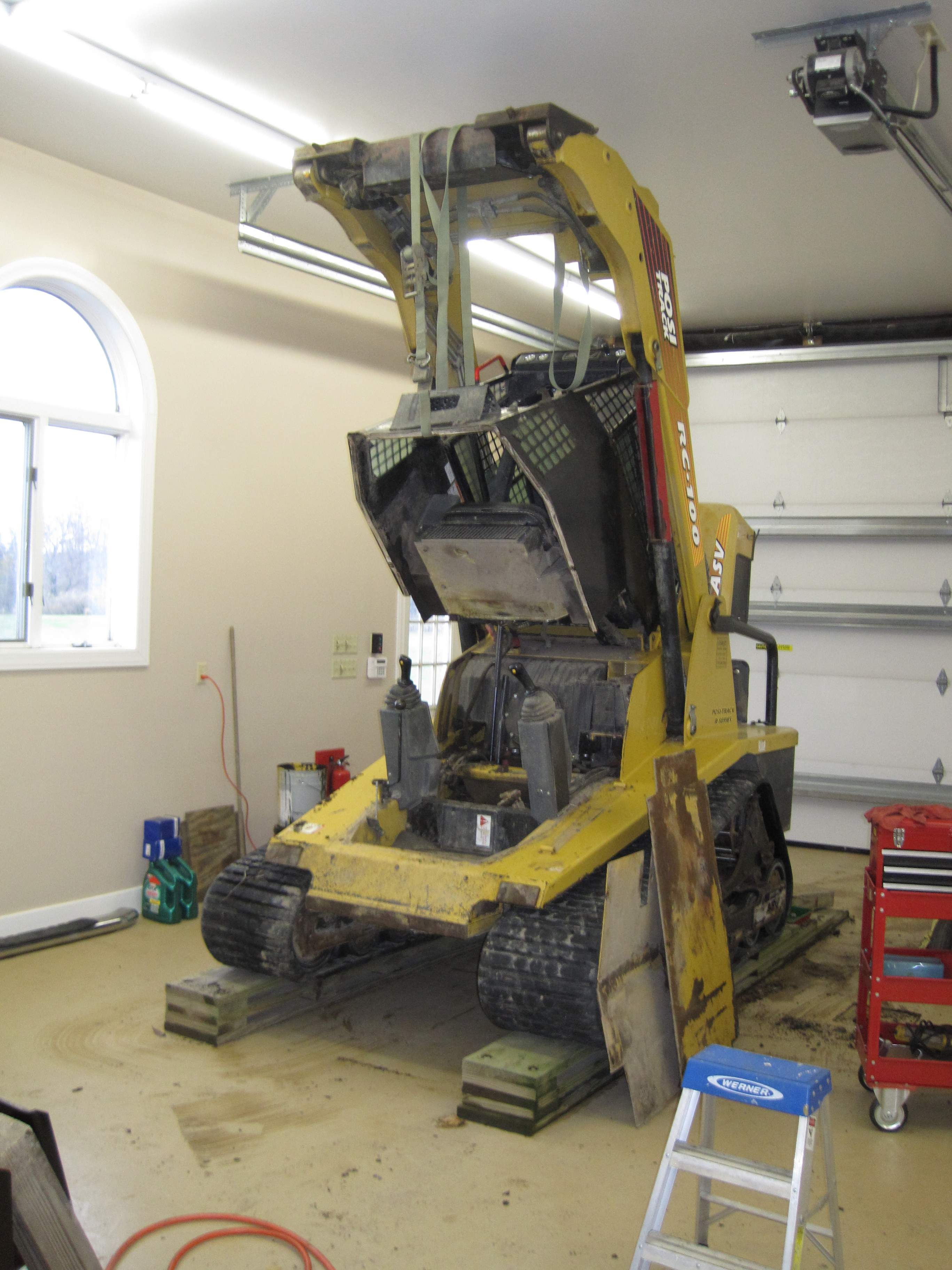

It's a good powerful machine, but UC overhaul is expensive. I budget $11/hour to my "track fund". A 2005 machine will have it's share of hidden problems. ASV was not owned by Terex back then. Engine work is especially difficult, there's almost no room around the motor. This is a great forum for diagnosing problems, a lot of ASV experience hangs out here.
If problems start, get the arms up in the air quick. The cab can't be lifted when the arms are down. Battery and servos are under the seat/cab. A big problem is a large electrical connector under the cab to the frame. Bad connections and water damage can cause havoc everywhere. 2005 had recalls for broken axles. 3/4 bolts hold the axles and can vibrate loose.
The rear engine mount bolts are tapped into the engine oil pan. If one comes out, you'll lose the engine oil in a hurry and the "replace engine" light will come on.
The machine only has idiot lights, no instrumentation.
