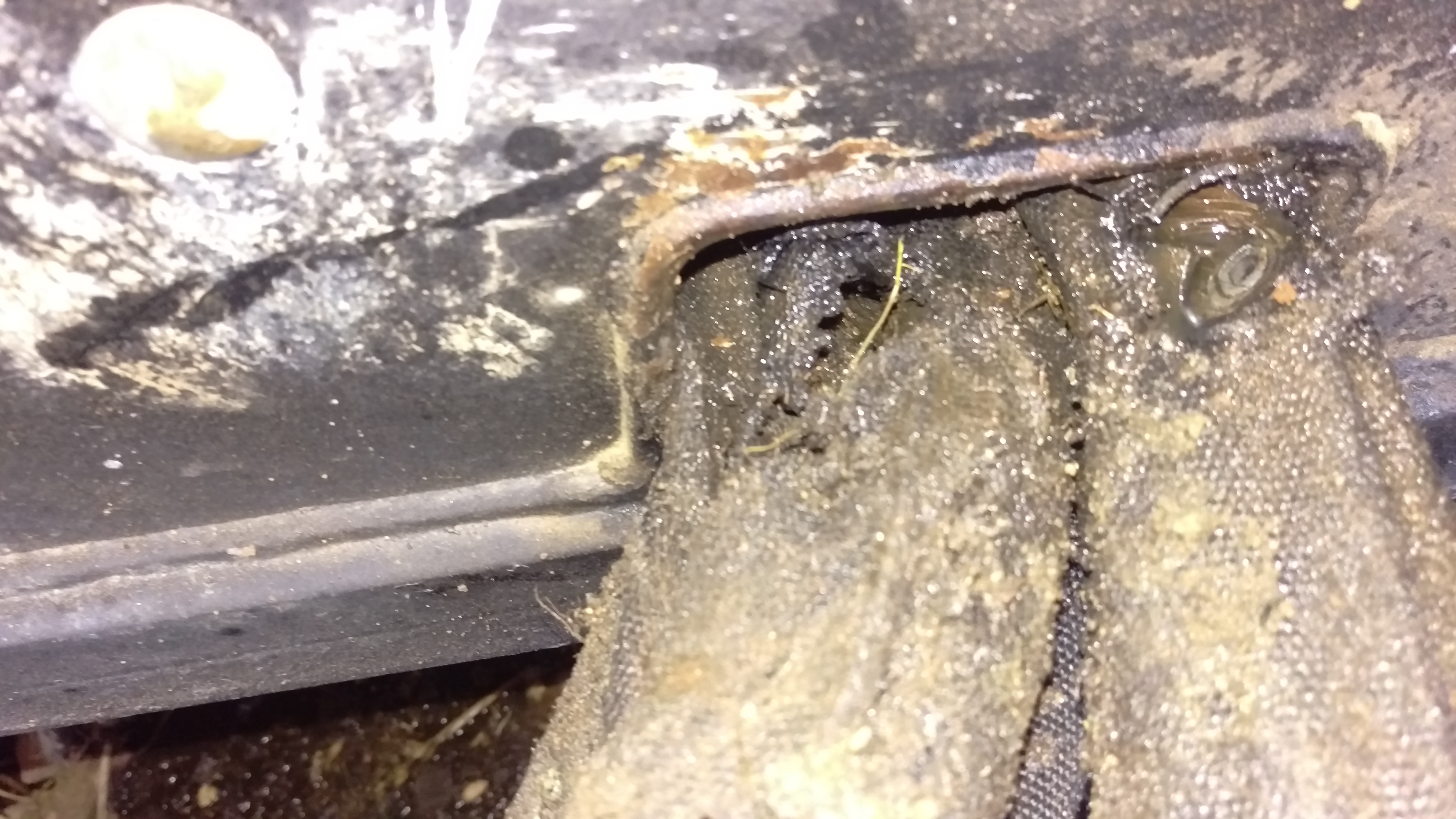

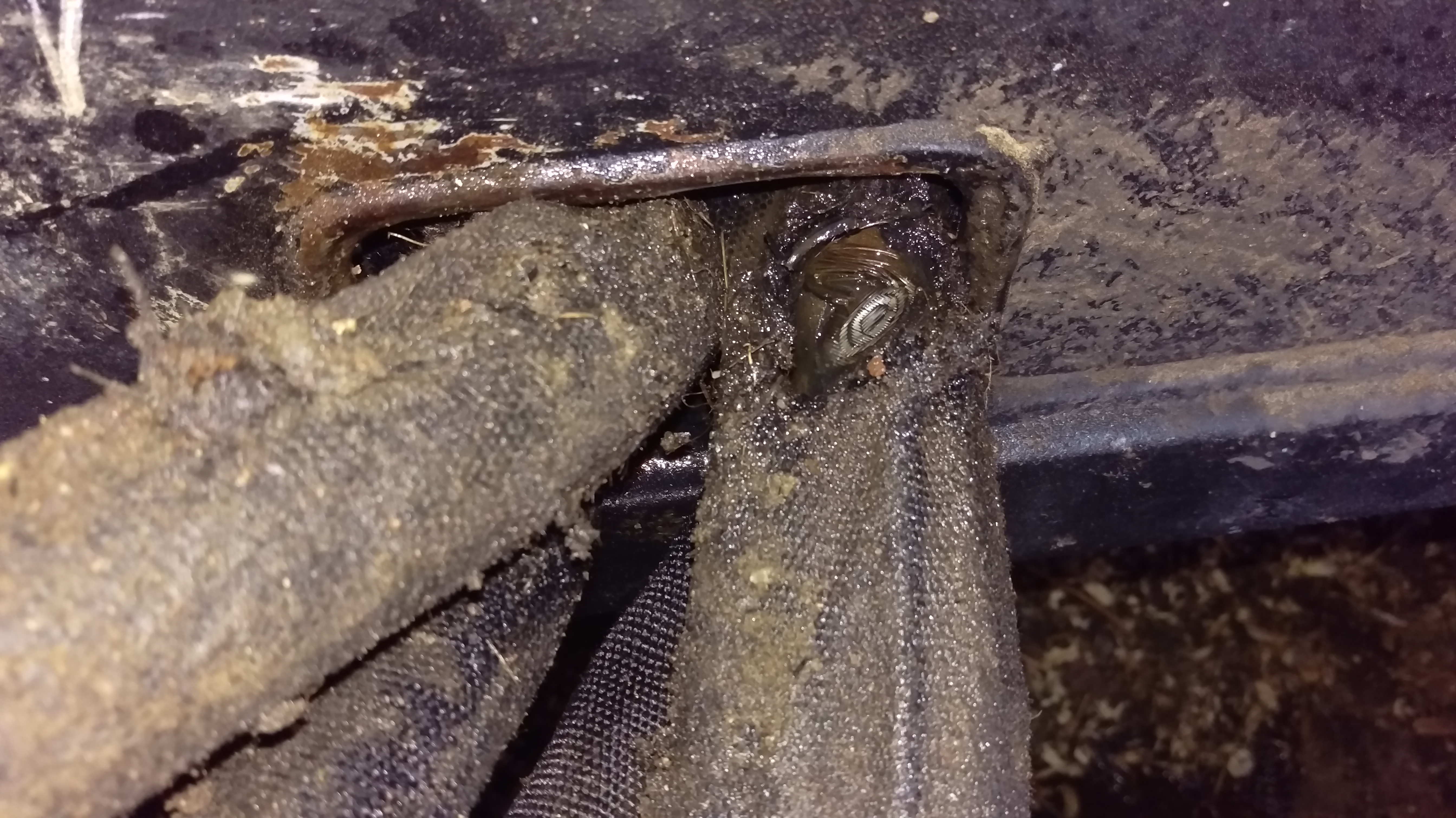

Take a look at the hydraulic hose lines where they come out of frame (the lines for your drive motors). I didn't realize mine had been chafing, and eventual wore holes thru the hoses. The hoses aren't cheap, I replaced the two drive hoses and "brake" hoses for about $600.

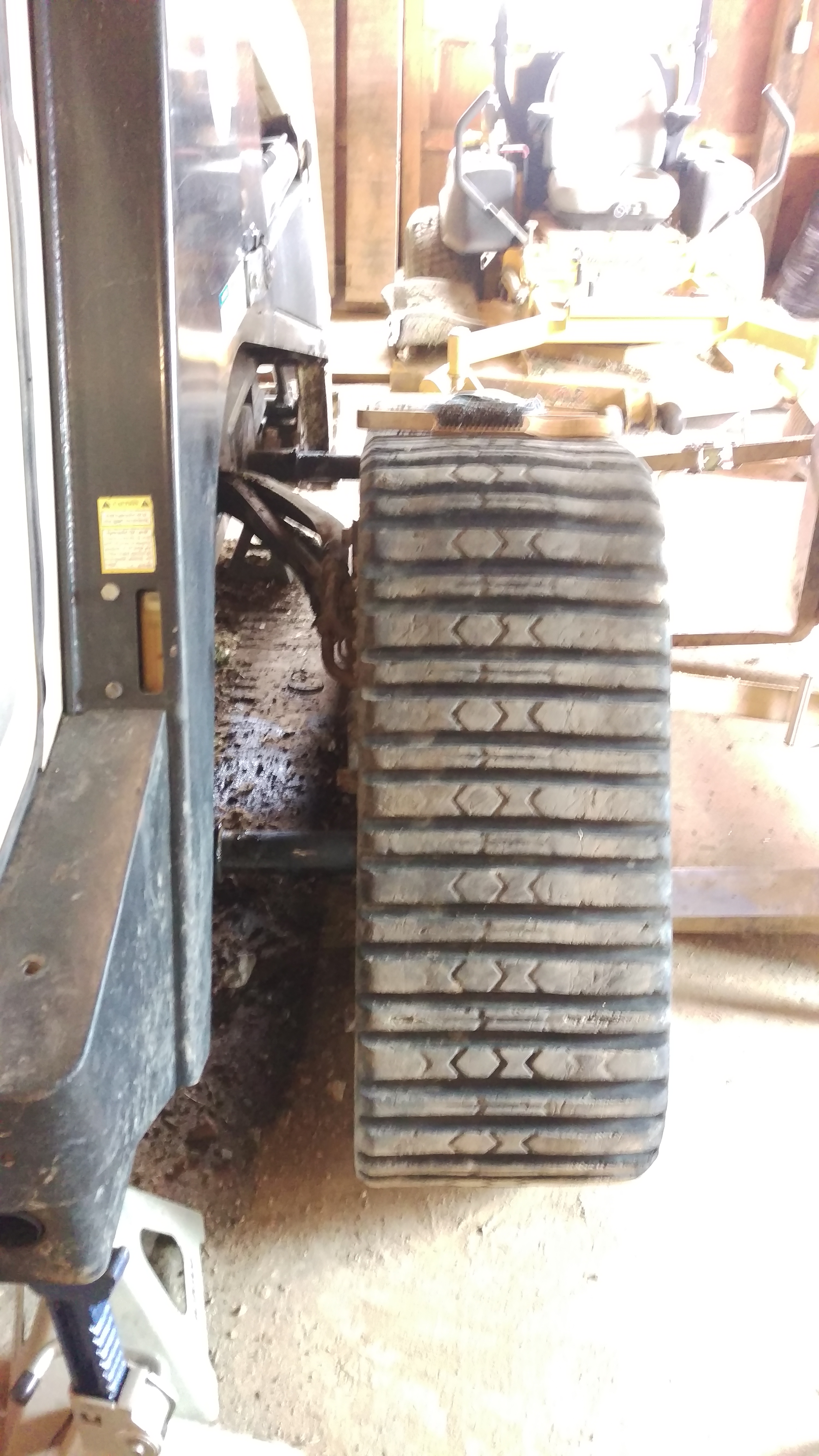

Well, haven't "protected" them yet ... The machine has a bit over 2000 hrs now so I suppose I can take a little time (before the wear occurs).
Here's a pic of the wear
   / ASV RC100 questions

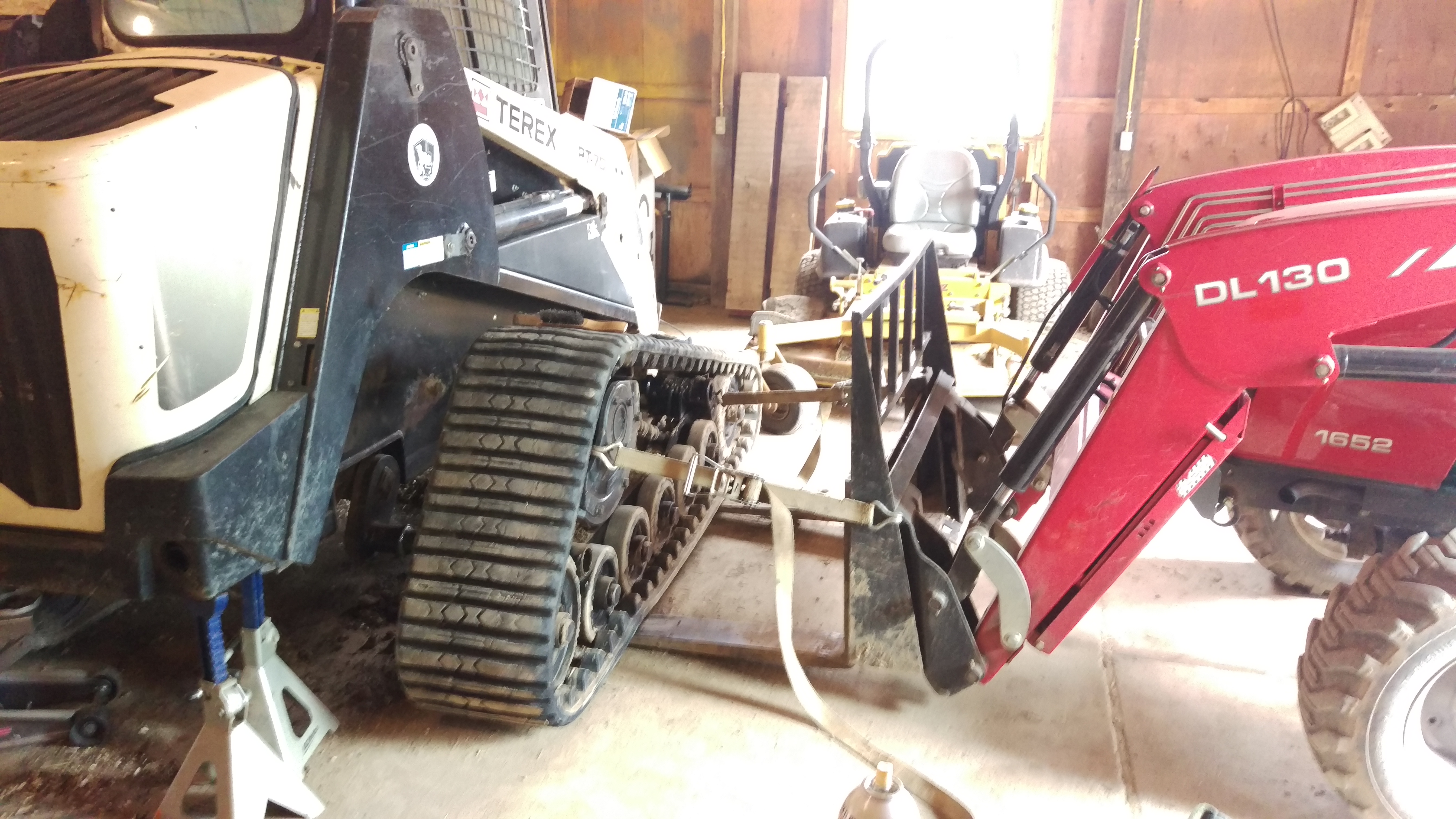

Good thinking, taking the whole track assembly off to change the hoses... being new to this style undercarriage, that would never have been my first instinct!
   / ASV RC100 questions #6
You won't be able to access the fittings without removing it.... luckily it's fairly easy.
Gotcha. My first inclination would have been to retract the tensioner and swing the drive table out. taking out 4 bolts and sliding it away from the machine seems a lot more efficient; I'm definitely adding that to the memory bank. I looked the hoses over real good when I did the tracks and rollers, but thinking I need to give that penetration they pass through another look, rather than waiting for the automated oil change system to kick in.
