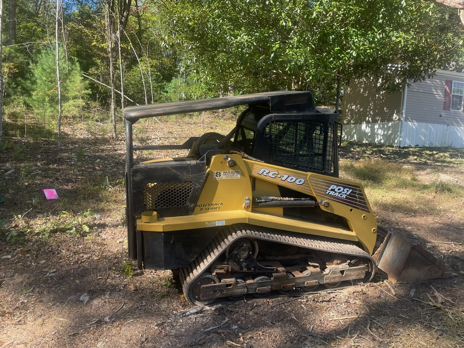

I just bought a used RC100 with an unknown amount of hours as the display seems inoperative. But that isn't my issue. When cold the RC100 acts mostly as it should although turning is jerky and fast sometimes and slow others. However, when warmed up you pretty much have to stop moving to turn either direction. It does turn better left than right. I have not done any trouble shooting as I am attempting to source a manual for the machine.
Here is what I do know:
1. The lift and bucket hydraulics work great, pump seems strong and will lift the machine.
2. The drive hydraulics, I guess the pump and drive motors, seem strong when going forward as it will load the bucket with topsoil or virgin soil. However, it will only move and/or scoop dirt at full throttle.
3. While moving forward, noted above, it won't turn and will, in fact, slow and stop if you keep trying to turn while moving.
4. When stopped and at full throttle the machine will spin in place, either direction.
4. In reverse the machine moves like it should but again at full throttle.
Based on the above you can see I can use the machine. I have to run wide open, stop and aim where I want to go, move and periodically stop and aim again to reach my intended target. Ugh, frustrating.
I don't have a manual so I don't know all the steps to troubleshoot but my way of thinking is the point of hydraulic distribution is possibly dirty or has partial blockage.
Any thoughts?
Thanks in advance for any input.

With a skid steer you have two hydrostatic pumps and two track drive motors that operate as two separate systems.
Hopefully ASV installed some test ports on those drives so that you can check the following:
1) if you can access the pumps and wheel motors drive it for a few minutes and check the temperature of the housing or cases on each pump and motor. If one of them is significantly hotter than the others that would point towards that component is failing.
1a) Charge pressure; does it vary significantly from idle to full throttle and from cold to running temperature? Loss of charge pressure will make system operate erratically. I do not know what the pressure should be.
Since you need full throttle I would suspect a faulty component causing loss of charge pressure or pilot control pressure but that is just a semi-educated guess without additional information.
In looking at parts diagrams on-line it appears that the RC100 has hydraulic pilot joy sticks so would check pilot pressure at the joy stick. Again not sure what this pressure should be. Frequently charge flow is used for pilot pressure but it maybe lower for pilot controls.
Hopefully this information provides a starting point for you.

That screen is an intake filter, asv terex is known for it getting blocked up. On my little 30, it was in the bottom of the hydraulic tank, you probably have two covered accesses to the tank, it's most likely at the bottom of one.
The pilot pressure is usually around 500psi.
Only happening when hot though... That's probably a seal or swash plate allowing the thinner fluid to escape.
