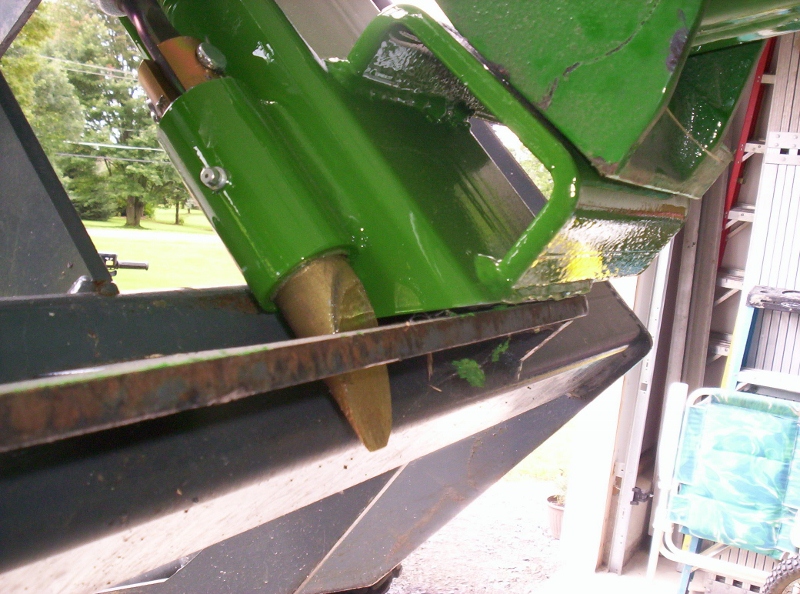

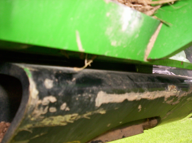

Has anyone else used ATIs Tach-ALL, for JD, Kubota, other?
Boy, it seems like a slick unit. My dealer replaced the standard JD SSQA they sold me with this one. Their SS carrier was nothing but trouble. I tried back dragging with that and the Workpro bucket and I kept hearing this "POP" sound. Sure enough it was sliding around (bucket) on the POS carrier :mad:
To make a long story short, they took back the carrier and the Workpro bucket. They then exchanged those for a heavy duty JD bucket with the JD pin on style.

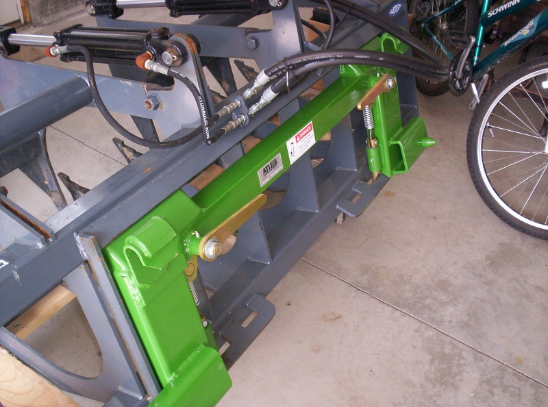

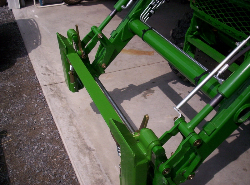

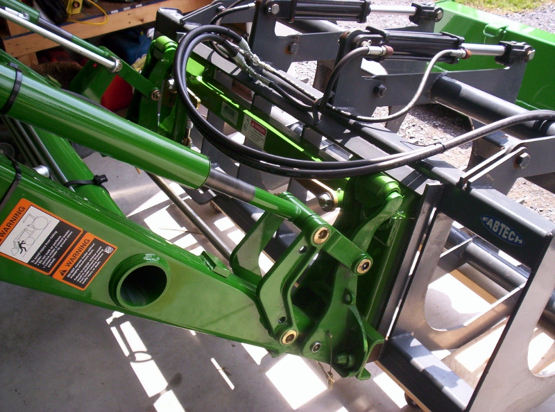

Now all I have to do is use this ATI adaptor with the JD setup. Looks pretty well built and the fitment is excellent! Much better than their SS carrier..
Photos to compare
1st photo is the big gap on the JD SS carrier.
2nd photo is the ATI conversion to SS carrier

Matt, that's kinda why I posted this. I could find very little info anywhere. Maybe it could help someone..
As far a getting a defective one, if thats the case it would have to be 4 defective ones. The dealer replaced 2 on each side! The fit was the same on each one, bad.

It is kinda neat, and to tell you the truth it weighs about the same as the JDSS carrier. If you look close the Tach-All doesn't really extend everything out that far. pluse like you mentioned it's the "best of both worlds"
Something else I forgot to mention. The boxed brace that holds the sides together is nice when you're hooking up to an implement. In other words the sides don't flop around and move independently like the other carrier. :thumbsup:

The adapter is holding up great the thing is built like a tank. Put about 30 hrs on it this year already with the grapple, it's rock solid. I'm not really sure why anyone would go through the trouble with welding this or that when something like this is around.:D
As far as switching it around goes, it couldn't be more simple. Right now I'm switching back between the grapple and the JD bucket. When the bucket gets put back on (not often) the adapter stays right on the grapple. Pull two pins pop the bucket back on. Very, very easy. :thumbsup:
