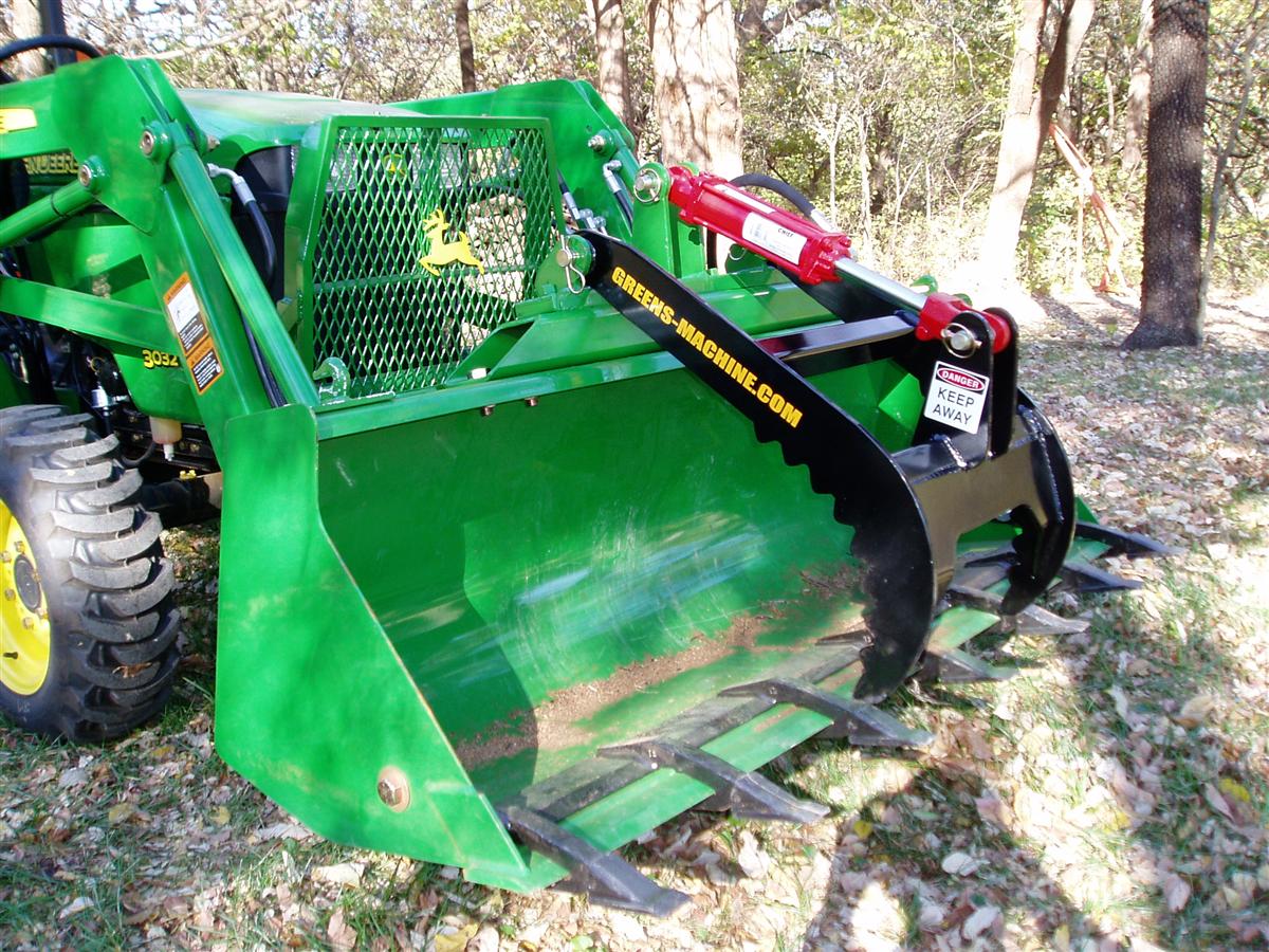

I ordered a Thumb from Green's Machine to mount to my FEL bucket. It's on the UPS truck and will be here this afternoon! :)
I have a 2005 JD 3520 with a 300CX FEL.
I'm looking for advice on the best way to mount it. I've attached a couple of examples...
TBN member Burtonbr did it this way: image_Burtonbr.jpg

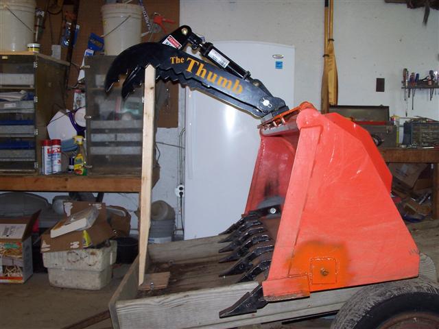

TBM member picker77 did it like this: PB060018_picker77.JPG
I'm leaning towards the way that Burtonbr did it although Picker77's method looks a bit simpler (no welding). I already have bolt-on hooks on the top of my bucket as well as a clevis attachment right in the middle of the top of it. If I went with Picker77's method, I'd lose the clevis. I'm a bit leery of just mounting something to the top of the bucket.
If I go with fabbing the Burtonbr type bracket, should I bring the "sides" further down my bucket for extra rigidity? What thickness of steel should I go with. It's kind of hard to tell from his pic, but I'm guessing it's maybe 1/4". The side of my bucket are probably only 1/8" (I haven't mic'd them to see for sure). Would 2 x 3 x 3/16" tubing be sufficient for the top bar?
Any guidance will be appreciated!!

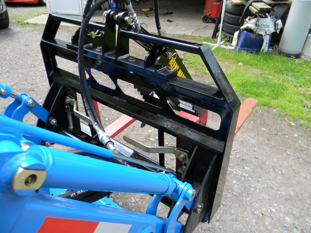

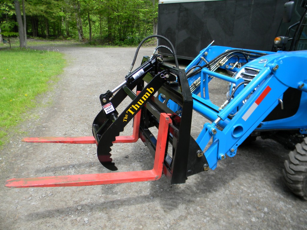

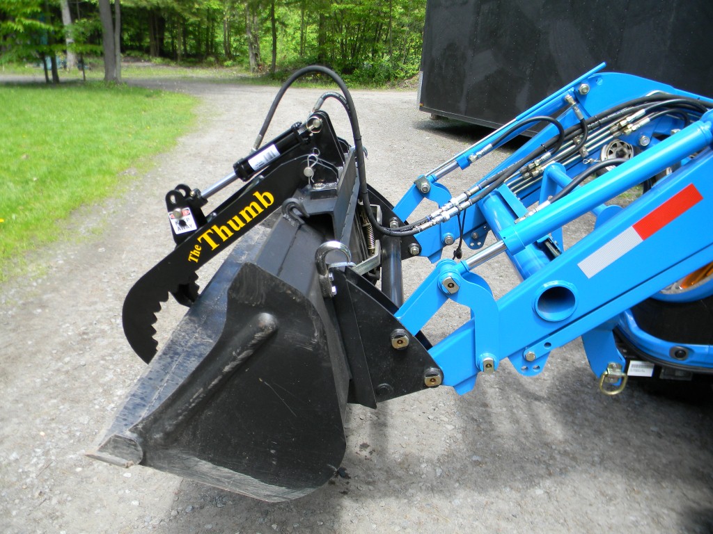

I also bought the thumb but I ordered 2 base mounts. I mounted 1 on the bucket and 1 on my forks. That way I can use the thumb with either attachment. Your 5/16" tubing will be fine if you build it like Burtonbr. It's thicker than your bucket. I used 3/8" angle on both my forks and bucket. I also drilled additional position holes for the cylinder.
I just read your other post. I ran my hydraulics from my rear remotes. (I have 2 sets of remotes). Bought all the pre-made hose and fittings from Tractor Supply. I posted a materials list in my post of the hose and QD fittings I used.

Yes, 3/16" will also work. Just don't mount it so the jaws will fully touch your bucket. My pics show the thumb fully open and closed and I left some gap so the hydraulic cylinder hits its stop before the thumb hits the bucket. If they do touch and the cylinder has more travel it could bent your bucket (or 3/16" tubing) where the mount is bolted.

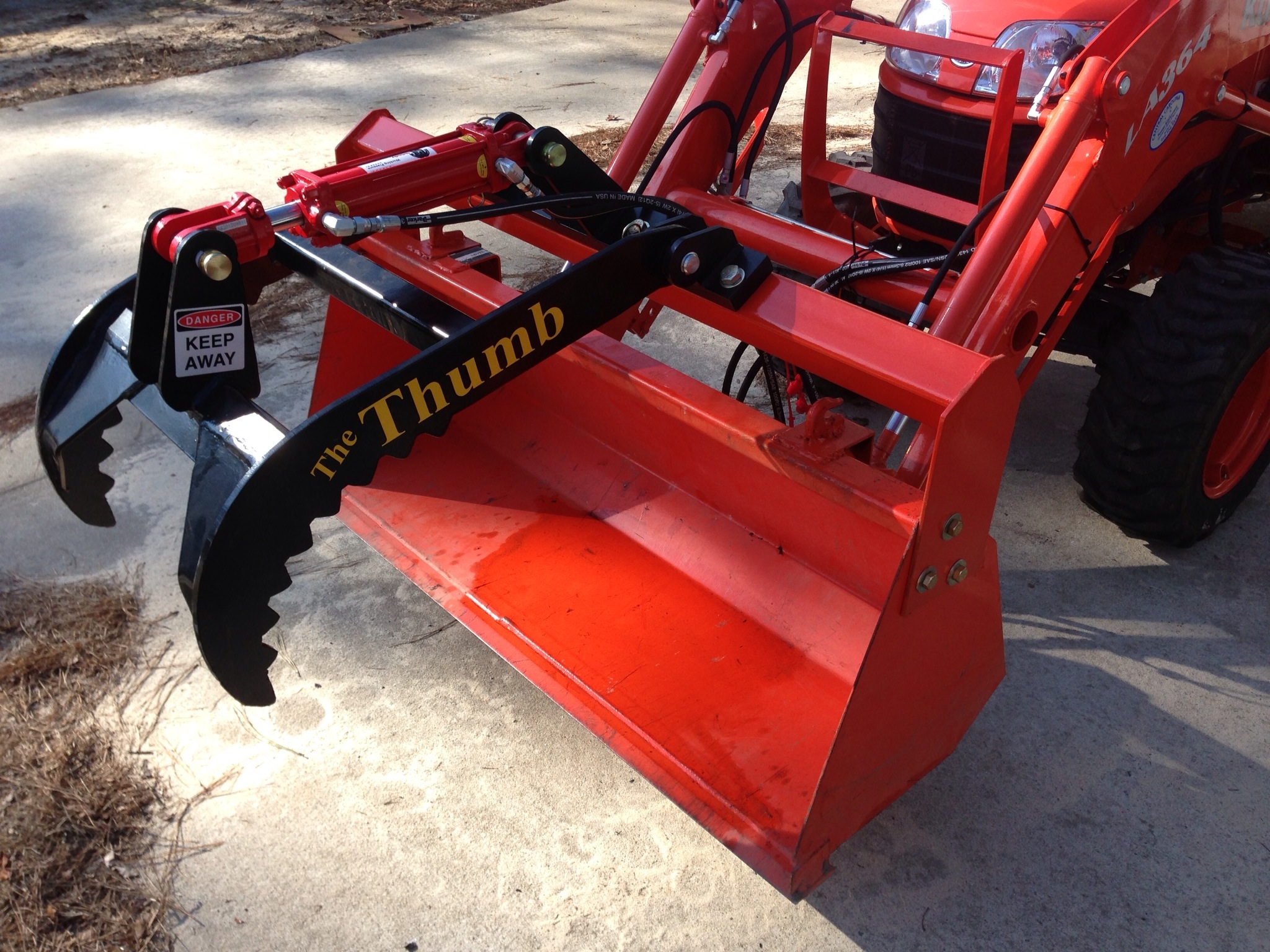

A lot depends on your bucket design.I had to use a piece of angle on the top so the thumb would fully close on the bottom edge.Does involve some welding doing it this way.One of the best additions I have done to my tractor.

Check my pic in post 2 for my bucket. I welded some 3" x 3" x 1/4" angle to the top of the bucket to mount the thumb base plate on. You can also add some 3/16" angle to the entire front length of the bucket. Mine came with that piece of angle from the factory. On my previous tractor bucket I added a piece of 2" x 2" x 3/16" across the top lip for strength.
