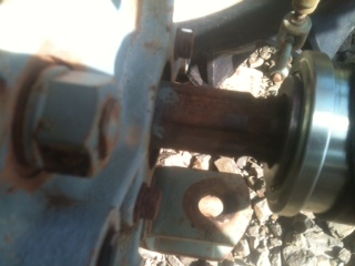

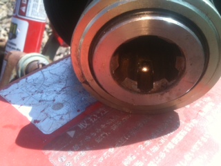

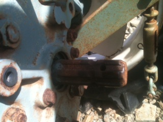

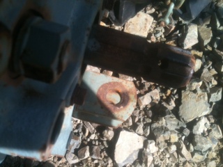

Ok, I just bought this tractor and new post hole digger from Coldwater tractors. I have serviced the tractor and finished installing the auger up to the point where I need to slide the auger shaft onto the PTO shaft. Below are pics of the auger shaft and PTO shaft. I am a self admitted newbie and know basically nothing about tractors. I have looked at the manual and on line but cant seem to find any good pics on how its suppose to go on to the PTO shaft.
I have found OTHER brands that show an extension on the end of the auger shaft that has a pin that has to be held out while you slide it on and then push the spring loaded pin into place locking the shaft. I dont see anything on this auger shaft for this. AM I MISSING PARTS? Do I need to buy something else or should it have come with the post hole digger is it it something that I have to buy for the PTO end?
I was hoping to get to some post holes today for my fencing.
Thanks for any advice in advance.

That should work. The style pto shaft you have uses a ball to lock it in place instead of the sliding pin you are familiar with. You need to either pull or push the outer collar on the end of the shaft as you slide it in. It is spring loaded. I believe you pull the collar away from the tractor as you slide it over the shaft, but some may be push.
Sent from my iPhone using TractorByNet
   / Attaching auger shaft to PTO SHAFT? field master post hole digger???
YEP, THAT WAS IT, my wife actually looked at it and said the same thing before I got this reply. I had to pull that colar out and slide it on and it clicked. simple. Thanks for the reply.

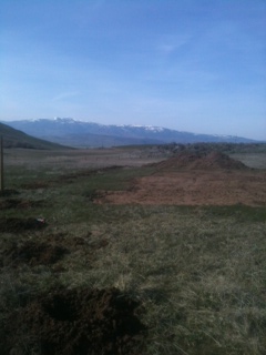

I know the pics are small, but here is a couple my post holes. Im eventually going to put a home down by this pond. For now I have a shop and my fifth wheel. Going to get a greenhouse in and garden, chicken coupe and large dog run area. This is going to help a ton, plus I have lots of fence to fix.
And yes, lots of deer and even some Elk. But with all the hunting within minutes I wont hunt on the pond, maybe up higher but I promised my wife that I would not shoot right on the pond its self. Plus by duck hunting buddies tell me once I start killing ducks and geese on the pond that they will leave.
