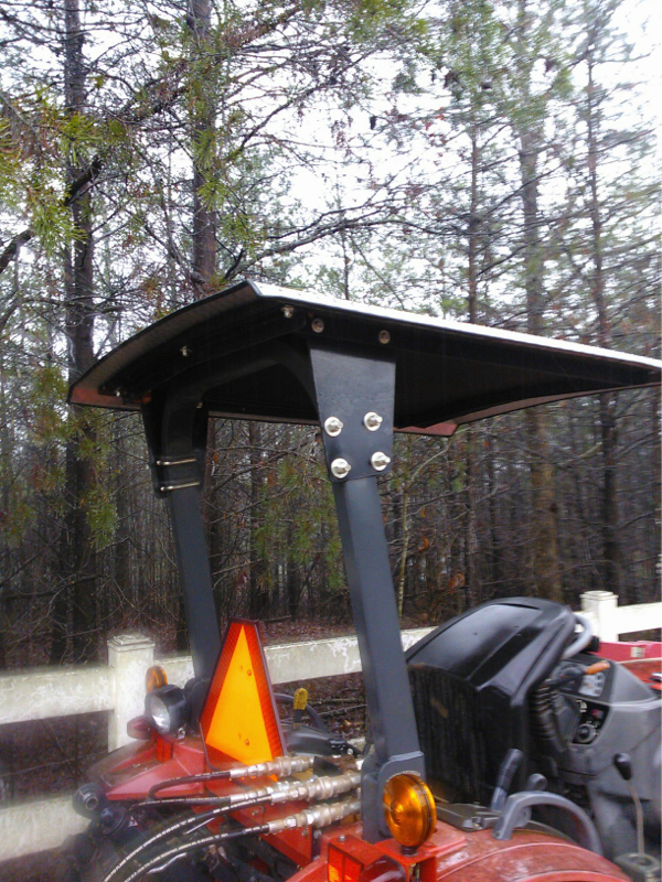

Tractor came with my house I bought, out in the shed was a fiberglass top for the tractor. How in the heck does it attach? It has two small brackets coming out from the under side of the roof (maybe 6x8 inches in size) with four bolt holes in each side. Other than the ROPS, I don't see any other way to attach the top and I have no idea how it could possibly attach to the ROPS. I have an '03 2810, can post pics if that helps.

It was probably held on to the rops with ubolts.
   / attaching the roof/top/canopy to 2810 #4
2nd ubolts on rops. Here's a pic. Different canopy on different model tractor but may help. Hope you can figure it out. Sure was glad to have my canopy working in the rain today. :)

And those U-bolts should have left some telltale marks in the rollbar's paint if they were in place for any length of time.

Updating as I had a PM on this question. I ended up finding the appropriate size u-bolts at tractor supply in the trailer parts section. They were bolts for use on 2x3 tubing commonly found on trailers. Needed some help to hold up the front while mounting, but it all is working great. Even survived accidently bumping a low hanging pine branch that it proceeded to break off.
