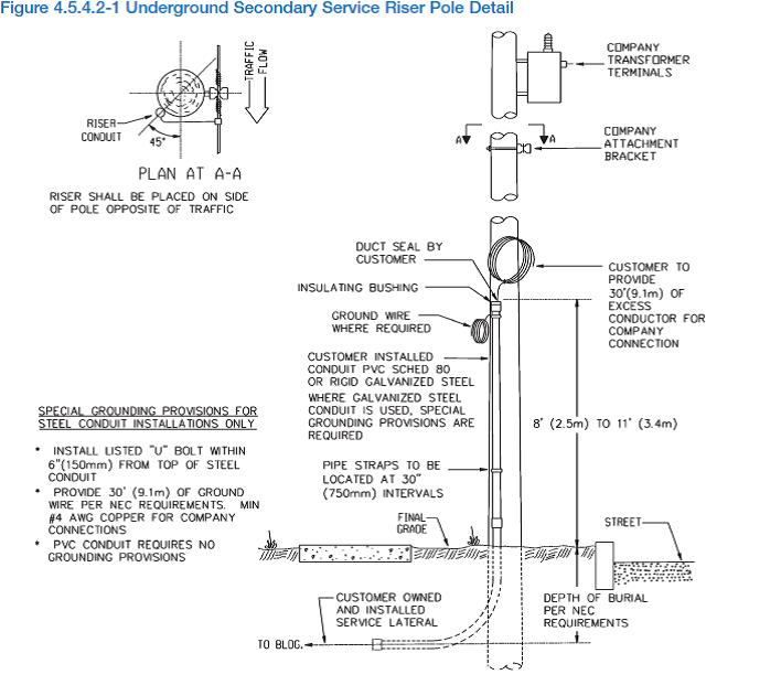

Maybe talk to utility about a waiver.
Especially if you agree to put cable in a conduit (which may be pricey too).
Will cable go under a driveway or roadway? Is the cable coming from a pole mounted transformer Is it less than 600 volts? Does the cable come from a "Underground Secondary Service Riser Pole?" Probably a 120/240V secondary service? Does the name of your utility sound something like "National Greed"?
If so, ask them where in there Specifications for Electrical Installations (formerly ESB-750) does the 3' depth requirement come from? It may be (hint: Section 4.5) that the utility requires your service lateral depth to be as "per NEC Requirements" . NEC Section 300.5 allows cable to be anywhere from 4" to 24" deep depending if its direct burial, in conduit, under a concrete slab (or encasement), under vehicle traffic, etc...
