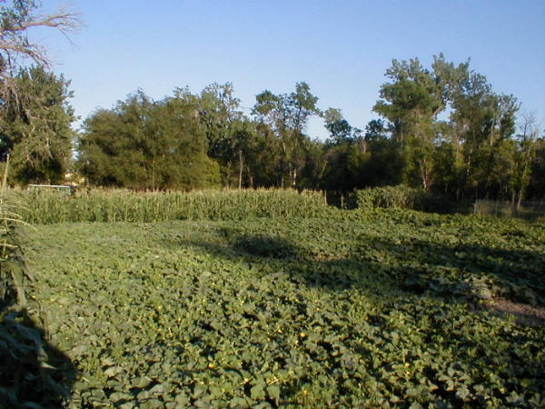

For the initial turning of the soil can be done in a variety of ways, you can use a rototiller, either the craftsman you mentioned or one attached to a tractor. The one attached to the tractor will be a lot less work. Another way the soil can be turned is to plow it first, but this leaves a rough surface that must be broken up either with the use of a disc or a harrow type implement.
I think that you will be a lot more pleased with the results of the rototiller.
When it comes to making a row to plant the seed, this can be accomplished in one step. Following is a link to a type of seeder that I used two years ago before my garden went a lot larger. I would not buy it from this source, check your local farm and home supply, believe I paid about $70 two years ago. TSC would be a good source if you have a local one. There are addtional seed plates available in addition to the four or five that come with the seeder.
If you have any other questions. please let us know.
Push Garden Seeder
If you click on the attachment above you can see a picture of our garden two years ago which the corn was seeded with this type of seeder.

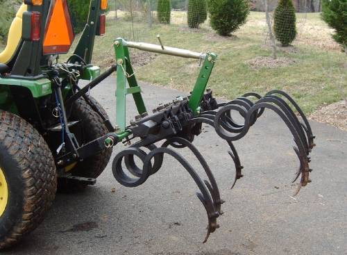

For the past 3 years in my 50x75 garden down below, I've used my Gravely rotary plow. I makes really nice mounded rows. Mine got too mounded though with a donation of 3 or 4" of compost from hurricane Isabelle. I scooped it from between the rows and piled it on top the rows. This fall, I went down and knocked the rows down with the rotary plow. Also in the fall, I got my new JD 4010. Attached is a pic of the soil ripper I used recently. It doesn't make the rows, however; so, I'm still debating what to do. Think a push plow may be the way to go.
I think that I'll make some furrow around the sides of the garden with the rotary plow. One thing I thought about was to then run the JD down the rows, with the wheel tracks making between-row areas (but a bit wide, 12.5" tire tracks). Then shovel the wheel track stuff on top of the approx. 2' wide rows (between wheels). Think the push plow is a better choice, as the between rows doesn't have to be that wide, and the rows need to be about 3' wide. That's why I flattened them to begin with. They were too high and not wide enough.
Another thought was to just mark off the between row spaces and shovel about a 4" wide between row space with my 4" trenching shovel. This is about what the folks at the Twin Oaks commune do. They rototill with a walk-behind and then run the between rows with a shovel. They do acres of veggies but have about 100 people for the labor. They used to use a tractor (with ag tires) for the garden work and found it packed the ground too much. My JD with turf tires and 2 tine runs from the soil ripper behind each tire doesn't seem to pack the soil much.
