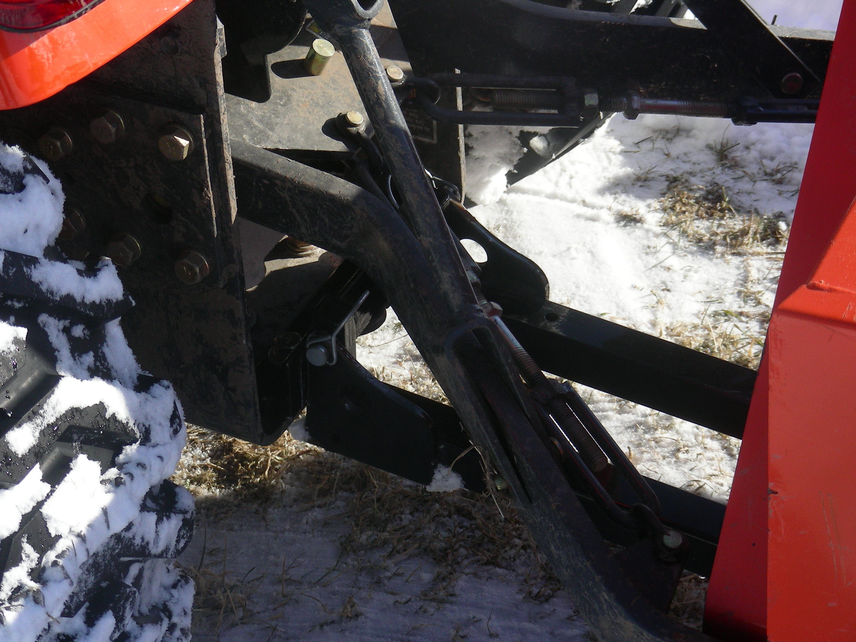

I presently use my ATV with a 60 inch manual swivel Moose snow plow for most of my 300 ft driveway winter maintenance , and then the odd time push back the banks with the FEL on my BX2660 tractor and maybe back scrape a few sidewalk sections. The ATV is quick but it is cold out there. SO last night I was looking at the plow and possibility of attaching it to the back of the BX tractor while maintaining the plow so that I can still attach it to the ATV if I want at a later time .( so attachable to both machines when need be) So I don't want to cut the frame and mount it to the FEL or bucket like others have done here.
ATV plows come with a roughly 5 ft long frame made of 2 pieces of 1 inch square stock that slides under a ATV and with ears welded on the end of the frame that slide into ears already mounted under the ATV , with two half inch pins to let it swivel up and down. Of course the other end of plow closer to the plow blade has a place for the ATV winch to move plow up and down.
Of course the plow section itself also swivels at that same mount plate to plow right or left or flat.
Now on the BX tractor I see where there is a nice mount plate at the lower rear with a hole for a trailer hitch . But I think I could weld up a small 8 inch plate to bolt on there with similar ears for the half inch pins to fit the ears like it does under the ATV. Then that frame would be underneath my Kubota weight box , and plow would face back wards with room still for it to swivel.
Then to lift it up or down I think I could use something at the back of the weight box ( short chain and clip maybe) to attach to the exisiting lift point on the plow , and use the threepoint hitch to lift the weightbox up and down, thus lift the plow up and down.

I think its doable for what you want to do. FYI- if you take the bolts out of the lower hitch to mount your new plate adapter, put small bar clamps on the sides as they tend to bend out. I found out the hard way and was able to slip bolts back in. I think if you welded a slip hook on weight box at right height would make installation a breeze.

Have you seen the BX hitch plate? Its not a standard drawbar most people are thinking of. Its a rectangle plate with 4 bolts holding it down to subframe and one pin hole.

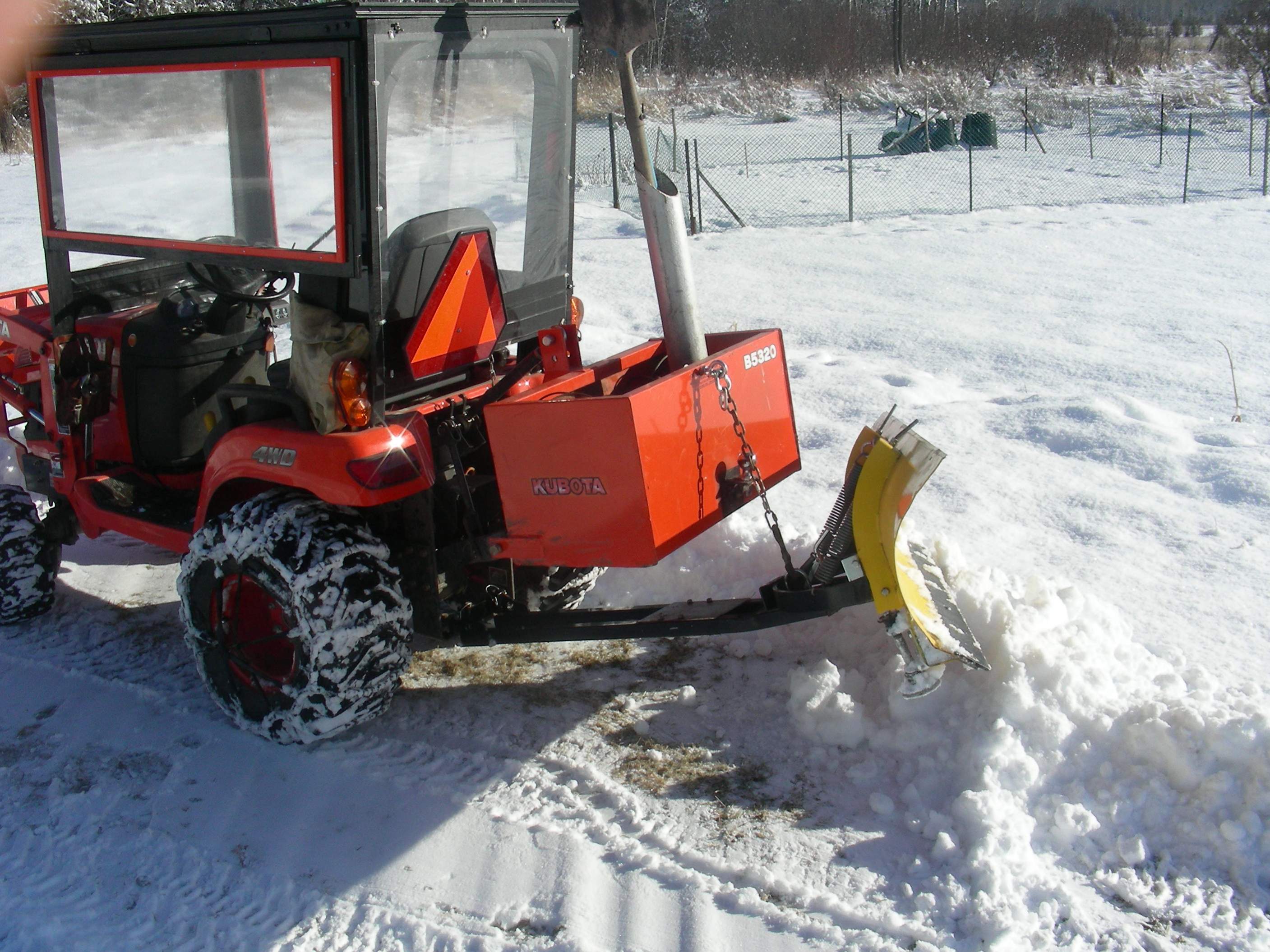

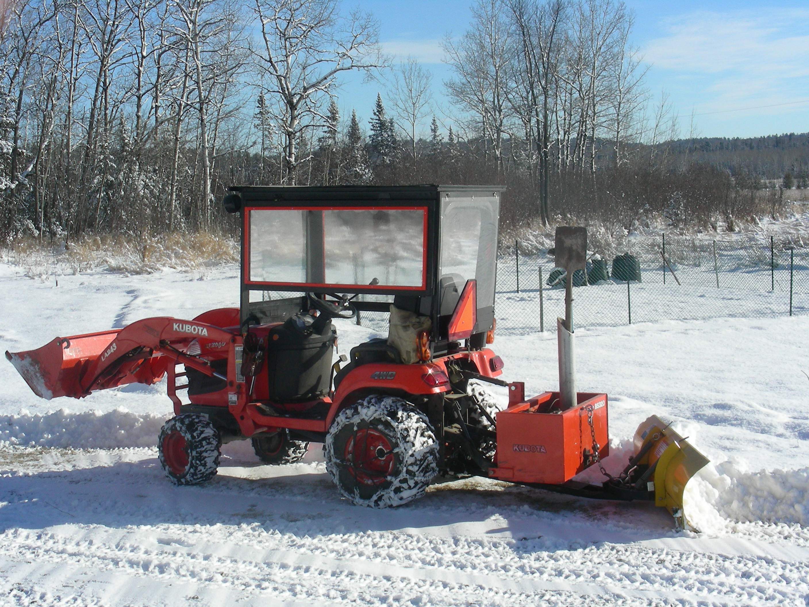

Well Radioman and others.............I completed the fabrication of a plate and ears to install my ATV plow without changing the ATV plow (so I can still use it for ATV if need be)
I tried it for first time yesterday see pics. I was quite pleased and the driving backwards is not that bad , but advantage of having FEL available to use is great.
There was also an ulterior motive in that my right hand is recovering from nerve surgery so the use of an ATV was bothersome due to vibration. Now I can drive the Kubota one handed (with steering knob) and right hand is just needed when I use FEL .

nice! At least you able to make it useful. Just becareful with all that extra weight on the plow from weight box and going to a snow berm or simalar.
   / ATV Snowplow on back of BX tractor ???
I made sure that weight box clearance is maintained and never rests on the plow arms , it is only used to lift the plow. (So plow operates the same as if on ATV , weight of plow is all that applies)
