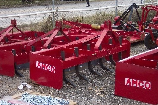

I attended the Alex Lyon and son (www.lyonauction.com) auction in Kissimmee today to purchase a box blade. I bid on and won a 6 foot "AMCO" box blade. It has a reversible blade and 6 quick adjust scarifiers. It appears to be new and ruggedly built. Has anybody seen, heard of or know about this brand? It seems to be more ruggedly constructed than the KK BB's I've seen at TSC.
I paid $175.00 so I'm pretty happy with that
A photo is attached.

Rick nice buy! I have personally never heard of a Amco but for that kind of money I would have picked one up myself. /forums/images/graemlins/grin.gif
   / Auction Purchase #3
Did somebody cut out their own stencil and spray paint a name on the blade ???
Looks that way.... Maybe they are imported by the load and just branded as " AMCO".
Hey for $ 175...how can you go wrong /forums/images/graemlins/smirk.gif

Two different styles of hitch and tine holder. One is a bolted hitch with an open strap style tine holder, the other is a welded hitch and welded box style tine holder. Which did you get?
   / Auction Purchase
It's the welded hitch unit (centered in photograph). The tines (6) have a quick release type pin which holds them in place as opposed to removing a bolt for re-adjustment. The two "backstraps" from the top link to the back of the blade were made of 2 pieces of angled steel welded together to form the angle. As you have pointed out, the hitch cannot be unbolted and folded for shipping. I can't remember if The AMCO logo is painted or is a decal. I'll check Wednesday when I pick it up. Either way, the logo is sad /forums/images/graemlins/frown.gif
The box on the right side of the photo (AMCO) is a four footer. The two on the left side of the photo were not branded and were of a different design. They were 6 feet with 5 tines.
I obviously had a choice on which unit to bid on. The AMCO appeared more ruggedly built...But I'm no engineer. What do you think Jim?
   / Auction Purchase #6
There were some issues with the open strap tine holder, ala DHE also known as Harp, and most mfr's have learned from those mistakes and have gone the route of the welded box tineholder for added strength. Not much difference strengthwise to the welded or bolted hitch. It is cheaper to manufacture the welded hitch, but much of that savings is lost to increased shipping costs as you noticed. Of course, in a train wreck situation it is easier to repair a bolted hitch since the hitch can be disassembled and fixed or new parts bolted back on. If the choice is the welded hitch to get the welded box tineholder, you did well to go with that. In other words, in my opinion, the welded box tineholder benefits outweigh by far the bolted hitch advantages.
