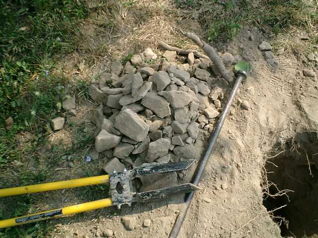

I want to make sure I am doing this right, with the right auger, because each post hole is taking me 45 minutes and at this rate it will take me over 138 hours to complete fencing my pasture!!!! /w3tcompact/icons/shocked.gif/w3tcompact/icons/shocked.gif
Equipment: Leinbach Post hole digger and a 9" auger.
Tractor: TC25D running at idle.
Lower auger to ground and start it spinning. The auger 'jumps' when rocks are hit. See the attached picture for a sample of the amount and size of rocks I am getting out of a 36" deep hole.
I let the auger 'work' on the rocks, i.e., I don't lower the 3ph. If too many rocks appear, I stop the auger, get off the tractor and clear the rocks away. Get back on the tractor and start digging again. Getting on and off the tractor to clear the rocks away is what takes so much time.
If I speed up the auger, when the rocks jam against each other and the auger, the auger stops and a shear bolt breaks. Running the tractor at idle usually results in the the tractor stalling (disengage PTO, take out of gear, restart tractor).
Is there a better/faster technique?? Or am I doomed to 45 minutes per post hole? BTW, 45 minutes is the average if I don't hit rocks that are so big that I have to stop digging, move the tractor and attack the rock with a digging iron!

Mike, with our wonderfully rocky soil here in PA, that is pretty much the way it goes with post holes and a compact tractor. The only way I can see to speed up the process is either get access to a heavier machine with a heavy duty PHD and auger, or have some one else to clear the rocks after you stop the PTO. With any luck, you will hit some "sweet stretches" with little to no rocks to slow you down.

In the picture you attached, if that's a standard 8" hand post hole digger, it looks like you are ending up with 24" holes - all but 9" hand dug... ouch!. Are the rocks shown in the picture broken up in the process of hand digging them out or are they the sizes you are encountering with the auger? Looks like the largest one is about 9".
Would a bigger auger help? My theory is that if a 9" auger runs into a 6" rock it is going to jam it up. On the other hand if a 12" auger runs into a 6" rock, there is a higher probability that it will be able to dig out and eject the rock.

WVBill, I should have clarified. I use the hand post hole digger to clean out the bottom of the 9" diameter hole I dig with the 3ph post hole digger. I laid it beside the rock pile to provide a size reference. The rocks in the picture are the sizes I am encountering.
Interesting theory about using a 12" auger. What do the rest of you think?

The larger diameter auger absolutely makes a difference in the rock-size handling capability. I borrowed a TSC PHD, with 12" auger and used it quite a bit, then went out and bought a 9" auger for one particular part of the project. I bolted my new 9' auger to the borrowed PHD gearbox and drilled 28 more holes. Thankfully I ran into very few rocks, BUT the rocks that stopped me were small enough that they would have passed through the 12" auger. Worth a try.
