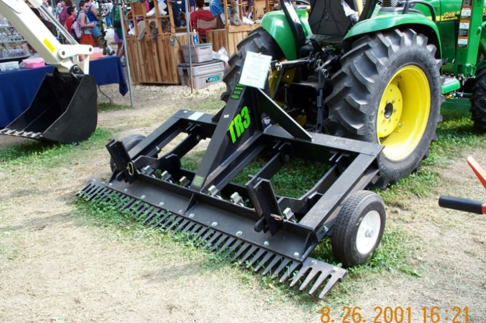

   / Australian Root Rake??? #2
Multi-purpose unit...Thor?
"You are what you eat, drink, think, say and do..."

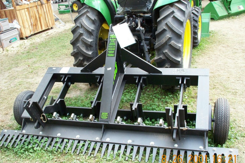

   / Australian Root Rake??? #3
Another angle...
