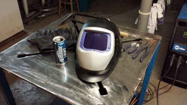

I recently treated myself for tig work at home. I have multiple a/d hoods that i never use, always loved a fixed shade with a glass gold. This is hands down the best hood i have ever used. Speedglas 9100xx. Head gear is genious, giant viewing lens and shade 5 side plates. Try one at your lws it will speak for itself. Costly tho, so it stays home, and i use fixed shade still at work. Stuff at work gets destroyed and sometimes dissapears unfortunately.
