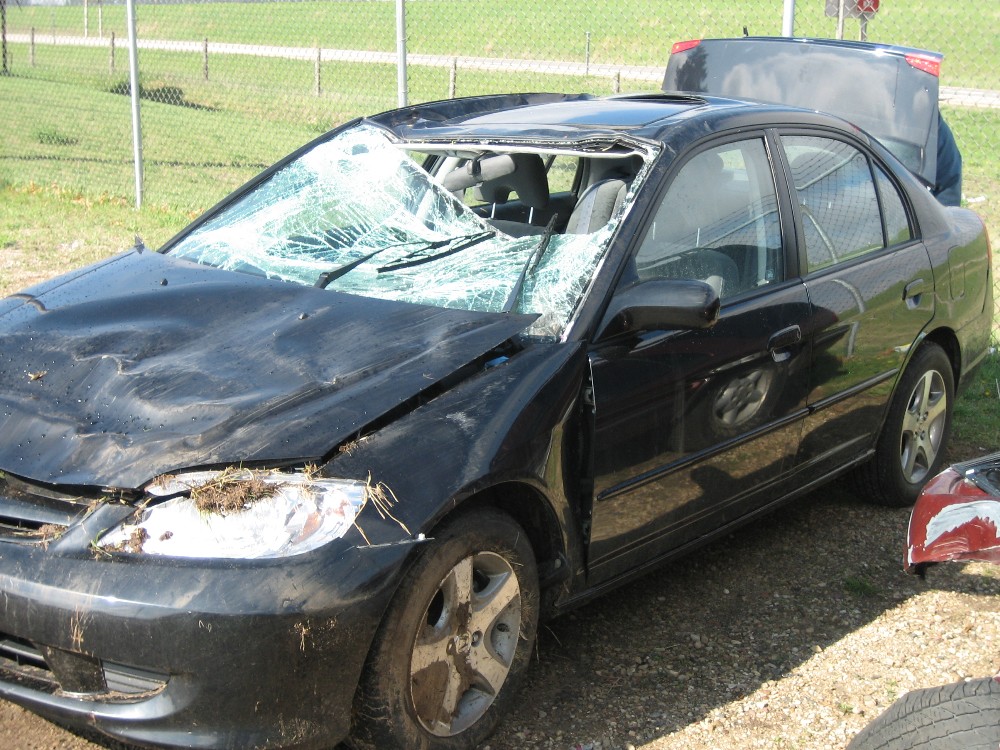

I've rehabbed 3 cars with salvage titles in WI over last 2 years ( See "Rehab a late model repairable" this forum posted yesterday) I bought the cars from henrysrepairables.com and starautosales.com in MN & SD respectively. I got a title from MN or SD with "salvaged vehicle" with my name on it.
To get the vehicles licensed they had to be inspected by an authorized inspector (Here it's a side job for the state cops - cost about $90 ) You can legally drive to the inspection place with no plates. This was Saturn dealer and he gets ~ $20 for use of the stall. You'll have to pay the sales tax so keep track of any parts you bought and if you paid sales tax or not. The cop/inspector wants photos of the car when you bought it and receipts for all parts. He wants to make sure the vehicle is not stolen or repaired with stolen parts so don't cover-up serial numbers of repaired parts and replacement parts, be they new or used, have to have receipts with their serial numbers. Also the inspector considers the "crumplebility "or energy dissipation of the repair so a rail can't have kink in it or be welded up over-strong.
Then back to the state DOT office for a Wi title and plates. Sales tax is paid when you get a WI title is this case. This a sum of purchase price of car and replacement part if not already paid.
The WI title has "salvage vehicle" on it. One of my salvage vehicle, a 2005 Honda Civic was flipped and totaled by my daughter( no one injured thanks to luck and seat belts). The insurance company checks all titles on the internet and reduced the reimbursement from 16K to 11k because of this. I can tell you you can't fight it because of the expense involved. It will reinforce the perception that insurance companies are snakes and spend plenty to get out of paying. So you got to drive these vehicle to get your money out of them.
In Wi a car can be given to your kids and titled in their name without paying sales tax, just the title and license transfer fees. So this influences how you buy a car.
Here are some pics, before and after of the Honda;
